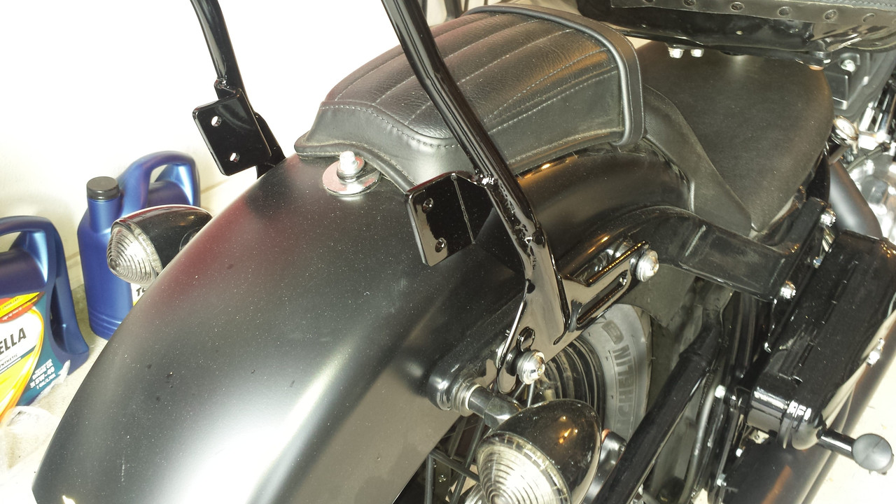

Originally Posted by WKNDS
I used the taillight relocation kit (which you don't have to if you grind the sissy bar attachment) and welded
on tabs so that I could attach the HD AeroRack. I will add a few pictures this afternoon when I get home from work.
T. (2013 FLS)
yes looking forward to the pics! Show close up of weld area

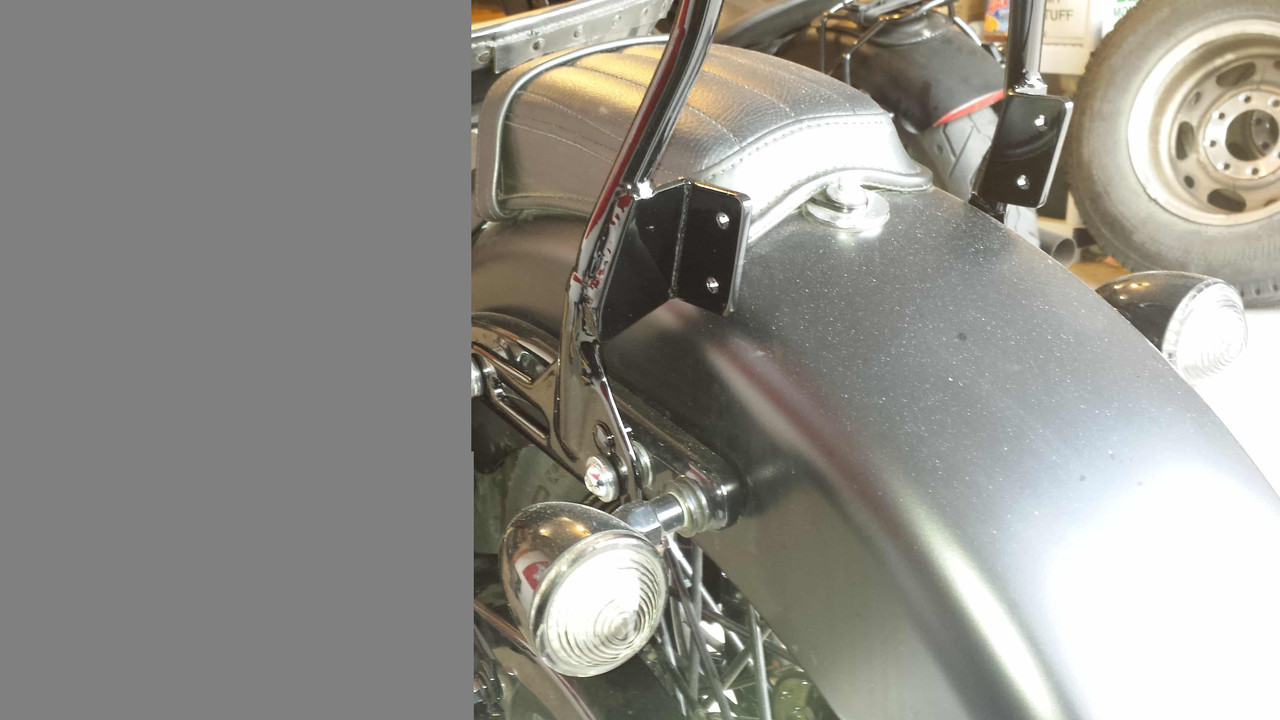

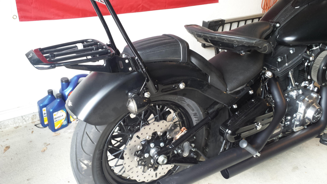

Here are the pics I've got, you can see the turnsignal relocation
and the piece of the sissybar that would need to be ground down
if you do not do the relocation and keep the "aero" style stalks.
hth,
T.

Originally Posted by MRPHS
WKNDS do you have a part number for that setup? How much weight does it seem safe to hold?
Weight-wise, It'll hold whatever the QD clamps & sissybar tubing will take.
I have no worries about the welded-on tabs either.
All of the part numbers are listed in the Parts & Accessories catalog.
https://www.harley-davidson.com/us/e...a-catalog.html
- Slim tall sissybar (with backrest)
- HD "Air Foil" premium rack
- turnsignal relocation kit
hth,
T.
