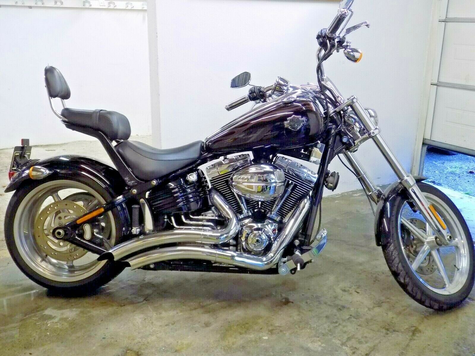

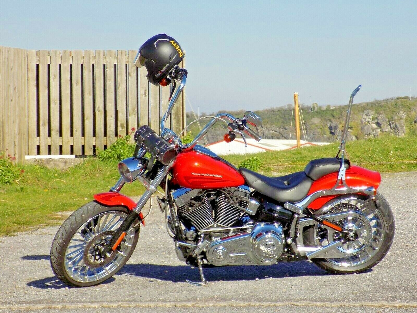

Here's my Breakout with the Legend Air slammed, and the Rocker on the Progressive 422s

Very nice bikes.
Lowering the bike does cause a few problems with banking into corners, it can also be difficult to get a bike lift underneath.
I did a few mods on my Rocker C but I didn't lower it.
I just want the fender lower on my Breakout, similar to the way the Rocker was done.

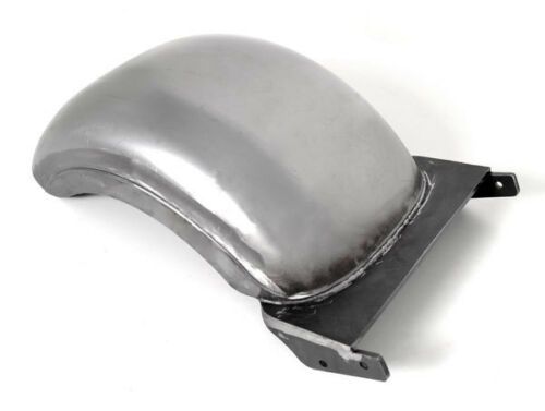

I was looking at this, they seem to be selling lots of them, it might be a good start to a fixed fender.
https://www.ebay.co.uk/itm/13-REAR-C...C/332154349495

The above will only work if it is swing arm mounted not frame.
The issue you will have lowering your stock fender is that wheel travel will be reduced as explained. Your stock fender is mounted to the frame and does not move, fitting a Rocker C fender or other aftermarket fender to your Breakout if it is swing arm mounted once the gap is set between wheel and fender it will be maintained as both wheel and fender will move in unison and would be the cheapest option. Whilst not cheap Thunderbike have some great fender offerings for your bike with the 260 tyre. The fenders that are supplied by Thunderbike come with a bump stop that prevents grounding out. Indeed I have an unused bump stop in my garage you are welcome to free-gratis if the need arises. The only realistic way of achieving your goal with the stock fender is fit a reputable air ride system as far as I see it. When I removed my OEM fender I found three badgers, two foxes, a few chickens and next door’s cat had all taken up residence underneath as there was so much room. I fitted a Shotgun air ride system on mine and the results were amazing.

The problem as far as I can see in fitting a fender to the swing arm is that whilst reducing the 'dirt bike style gap' between the fender and the tyre transfers the gap to the underside of the seat like the Rocker C has as in the picture above.
True, and you would need that gap or the fender will bounce you off the seat when it hits it coming up! Bitchin Seats makes an accordion style seat for the Rocker that hides the gap, but it wont work with the Breakout because of it's shorter fuel tank...you could always have a custom seat/pan made with a similar accordion style section on the bottom rear of the seat.
