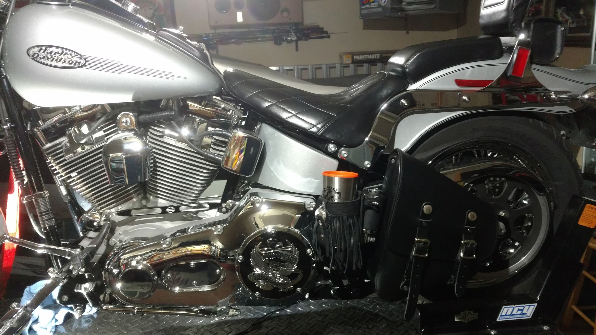

I own a fxsti not a springer! but if you are looking for a seat that will give you minimal seat height I run this Lepera bare bones on my softail standard it really gets you closer to the ground but doesn't have allot of padding but you stated you were ok with that.
