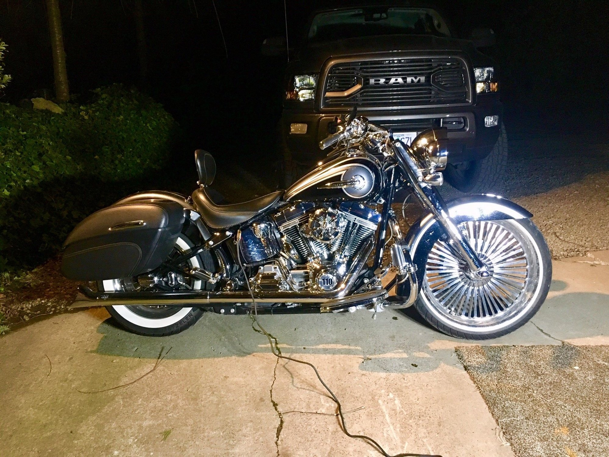

Super late to the party, but I've had no issues on the stock front suspension after switching to the 21. I noticed a small difference on my initial ride, but got used to it within a few miles. I feel the bigger wheel along with sticky tires dramatically helps with my turn in feel.
Looks like we have the same taste in rides..... CVO Deluxe and 3/4 ton Ram
Hell yeah man! I'm definitely feeling the billet wheel too!

Looks like you lowered the rear of your bike, what did you go with there?
I went with the Shotgun system. Definitely worth the money.
