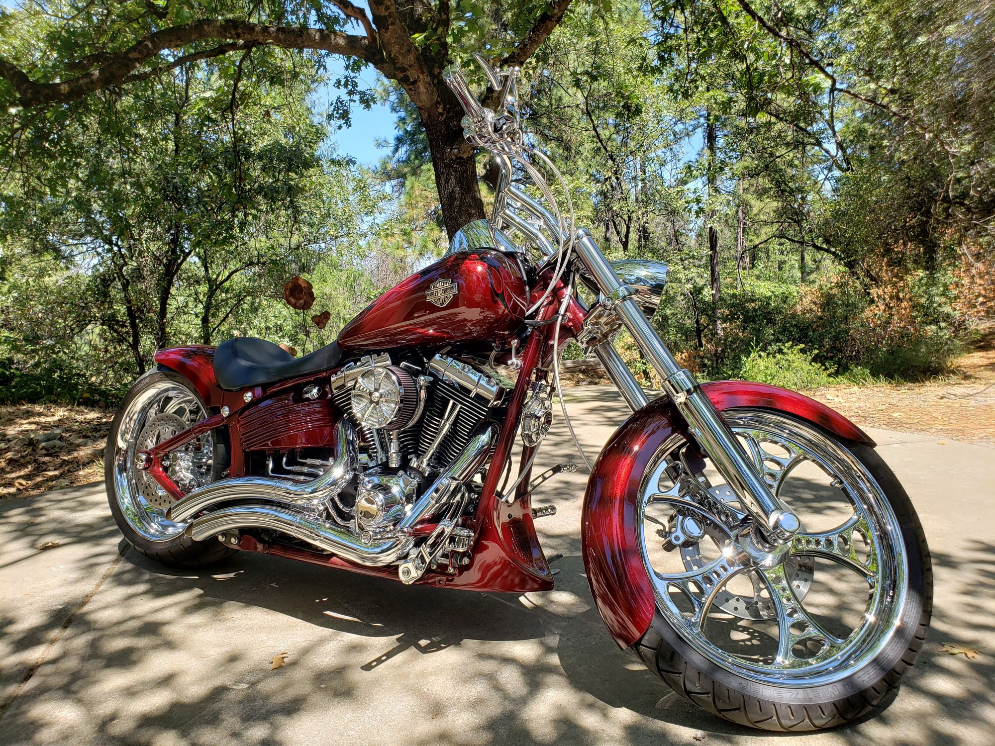

I love my tank lift on my Rocker, it looks great (same tank as the Duece). Keep in mind it also allows you to shift the tank slightly forward or rearward to suit where you want it.

I have a 2" lift on my Rocker and like it. The Deuce and Rocker share a very similar fuel tank (I have a Deuce dash on mine) , so you might get an idea....

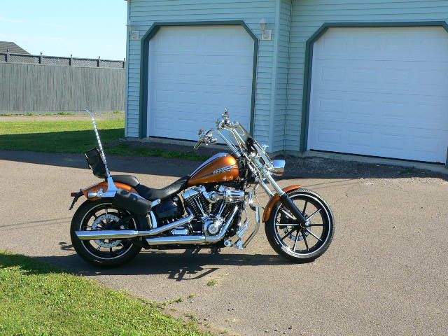

3" lift on a '14 Breakout.
Now, when my "reserve" light comes on, I know I have about 4 Liters left in my 18 Liter tank, (quite a bit). Access to the fuel is virtually unchanged though owing to the fact that the petcock on my model is near the rear 1/4 of the tank.
To see how a potential lift would look on your ride, you can do a trial lift by loosening the tab bolt at the rear of the tank and removing the large bolt at the front. Then just manually raise the front of the tank and wedge it up with a roll of towel or something so you can stand back and look at it. Later, just remove the towel and replace / tighten the bolts. You won't need to disconnect anything else.
