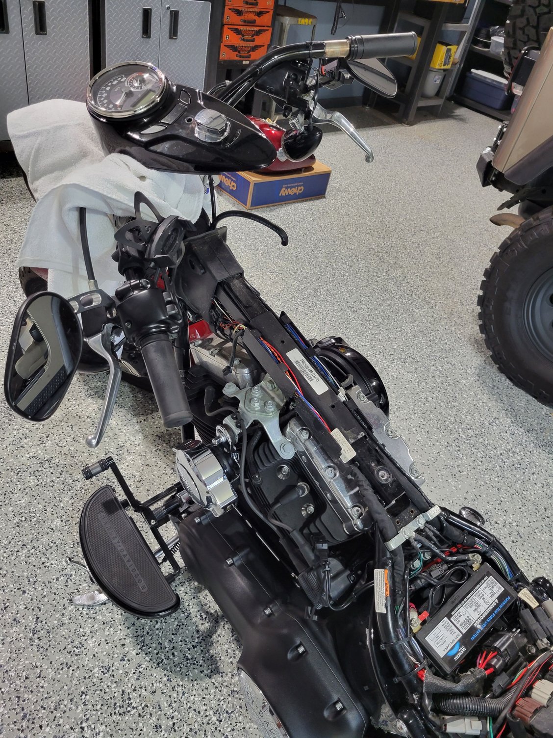

I was out for a ride and noticed while changing lanes that my right side blinker was not working. I stopped for about an hour got back on the bike, all of the other right hand controls were fine except the blinker still was not working.
Stop for a couple hours somewhere and when I went back to the bike it would not start, all of the controls on the right side were now not working. I had to tow the bike home.
At this point, I have the gas tank off and access to the plug where the right side controls plug into the harness. Is there any way to test these wires before I order new controls for the right side. I want to make sure that is the issue. Anything else I should be looking for?

Take apart the control at the handle bar. Then do a simple continuity test, wire by wire. If they all come up good, the wiring is not the issue.

You can ohm out the wires from the plug side. But to have all switches go dead, points to a different problem since the blinker and start run gets power from two different wires. Orange/white should be power to blinker and brake light, white/black should be power for start and run.

Are there any codes?
