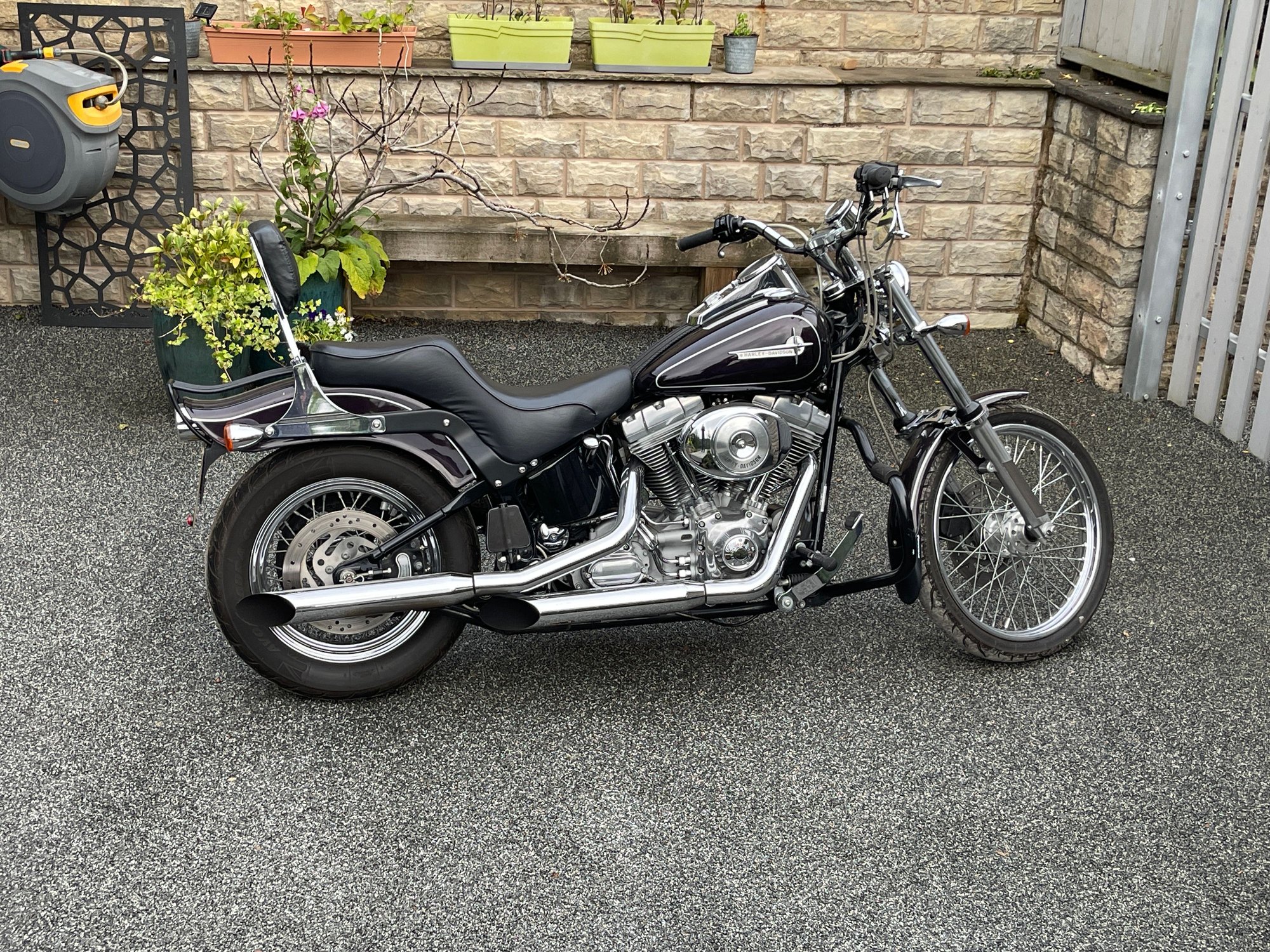

3 years ago, with all the Covid-19 problems, I changed jobs & handed back my company car. I then needed to purchase a car and so sold my Softail for the needed funds but always regretted the sale. Well, 3 years later I bought it back as the owner had had a hip operation and was glad to sell. But boy, what a state it was in! It looks like it's been stored in a damp shed and NEVER washed or cleaned. I'm no clean freak, but when it was sold by me it was pretty sparkly... now everything I touch is greasy or dirty... the paint on the rear mudguard (fender) has a gouge taken out and almost every screw or fastener he touched seems damage. I think his main tool was a set of vice grips!

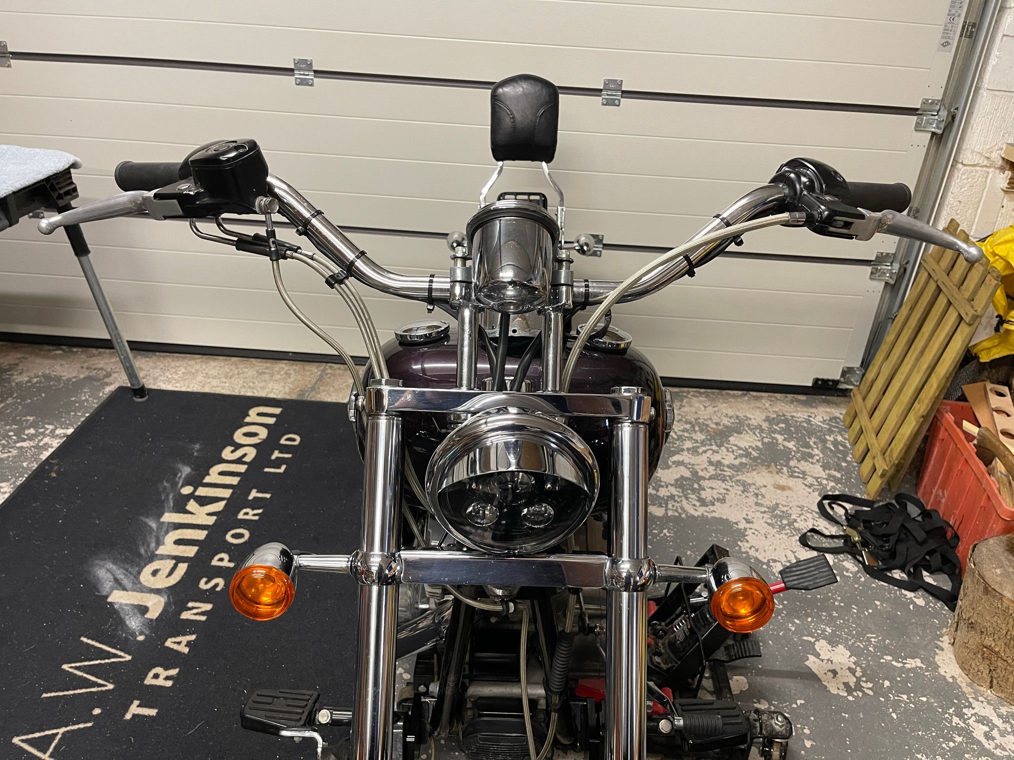

Worst of all though, he's removed my lovely stainless mini apes with internal wiring, and replaced them with an ugly set of bars, on tall risers, with the wiring zip-tied to the outside.
This was as it was when I sold it:
And this was how it was bought back (after a long wash and session with the pressure washer):

Next came a good clean with degreaser and lots of rags. There is not a lot of chrome, but what there is has been cleaned with coke & aluminium (correct spelling there!!! ) foil then lightly oiled. Then the Arlen Ness foot peg extensions were re-fitted and then onto those bars!!!!

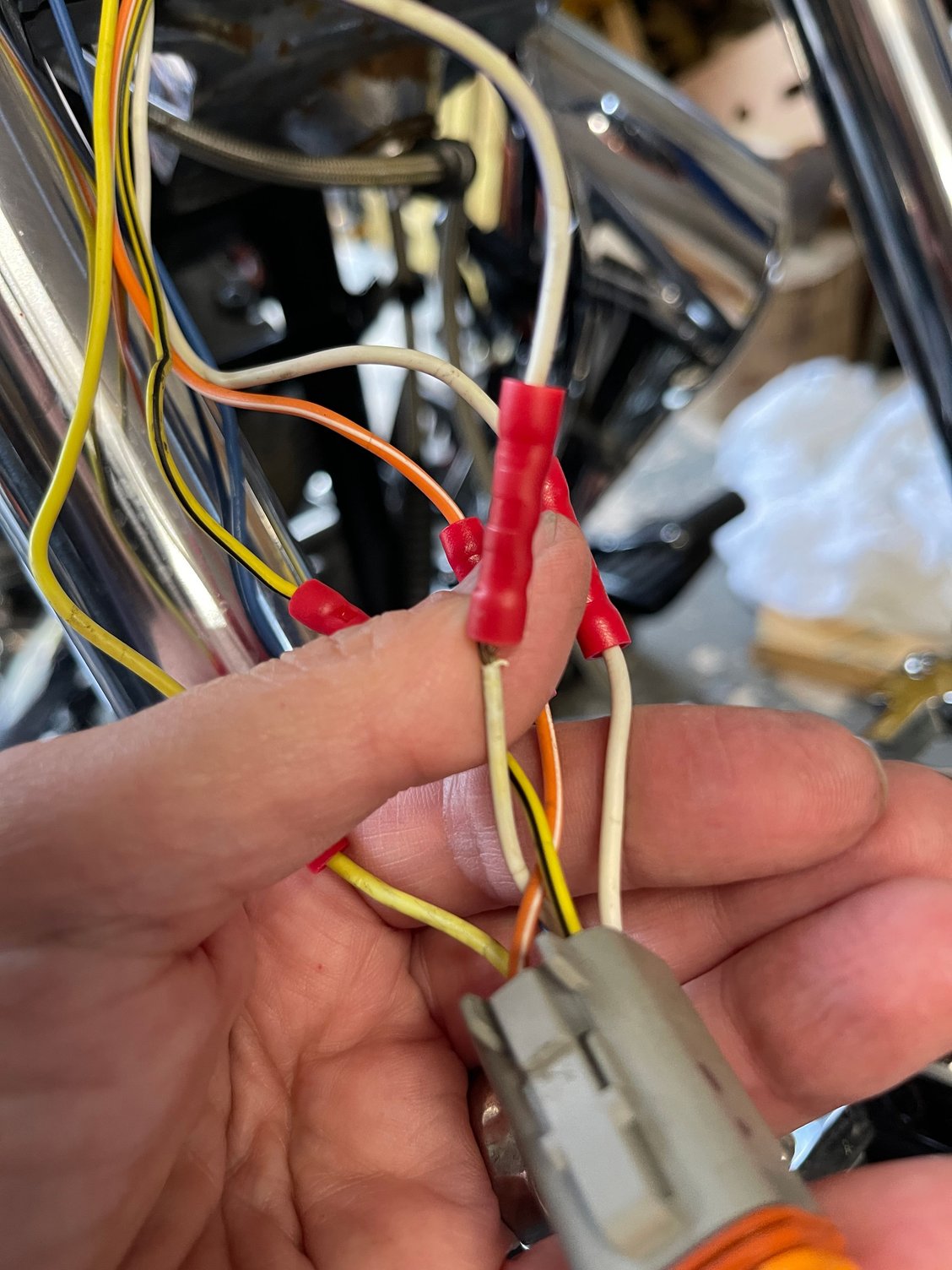

When I had done the internal wiring I had de-pinned the connectors and made sure all was returned as was... not this guy he cut and badly butt crimped the wires.
one wire was already pulling loose!
now moving forward a couple of days... My old apes have been returned and the wiring is now again run internally. The next job will be a long session with solder and heat shrink to replace the cut sections.

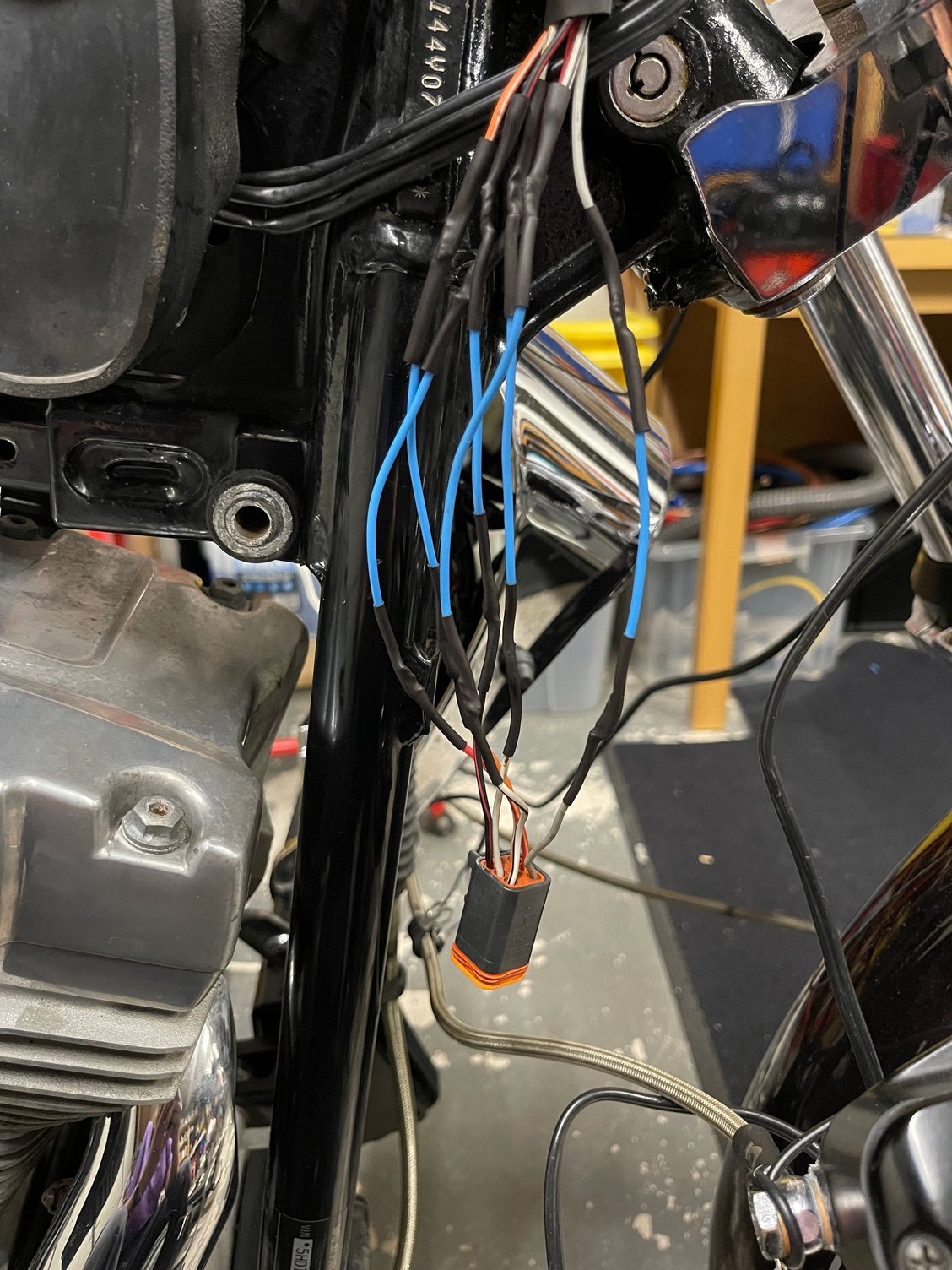

So today I spent a couple of "fun" hours with solder and heat shrink to remove the crappy butt crimps and replaced them with short extensions. At least I now know the joins are all sound. Next to re-fit the front brake and work out the length of line needed.

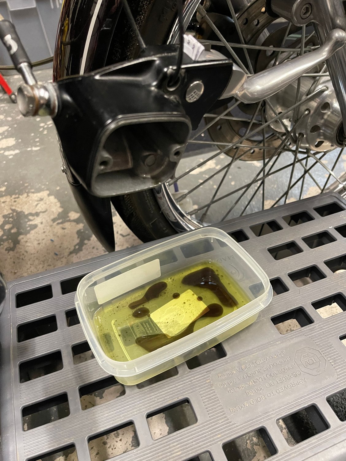

Dropped the front brake fluid…
This is exactly why I decided to change all the fluids!!!
