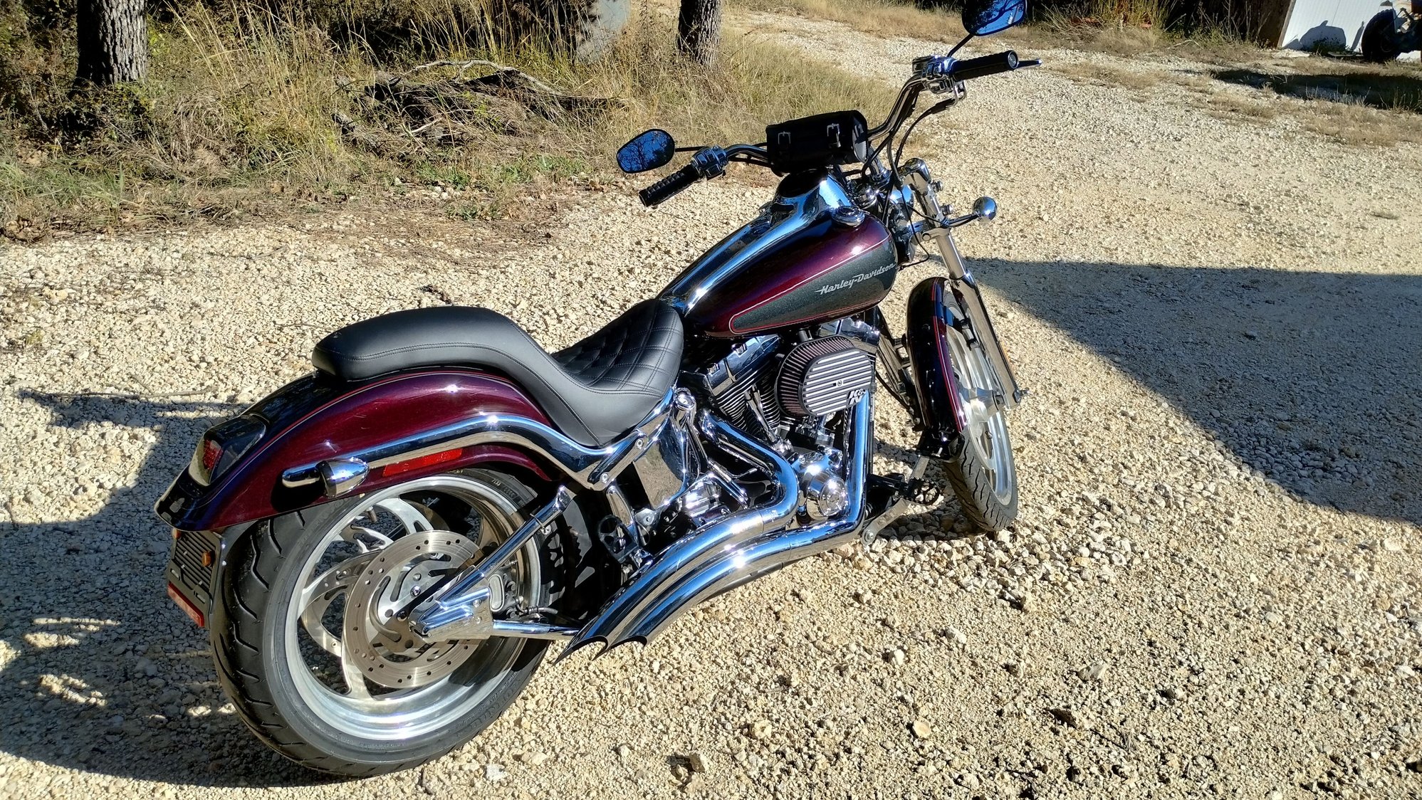

bought a bike 2 days ago. rode it up on the trailer then into my shop. everything seemed normal. yesterday i went to ride and clutch does not disengage. happened all at once so can it b something besides clutch adjustment? 25k miles well maintained.

Start with a basic inspection of the lever and cable and then adjust the clutch by the book. If it still is an issue then you'll need to pull the Primary and Transmission covers to inspect components.

clutch disc were hung up. guess it sat longer than i thought. put it against a tree and fired it in gear, released right away. everything seems fine , even that damn clunk into 1st gear. just need to put some miles on it.

you can do it on rough concrete with the front brake. my shop floor is slick so it would just push front wheel. just got back from a short ride and all is good.
