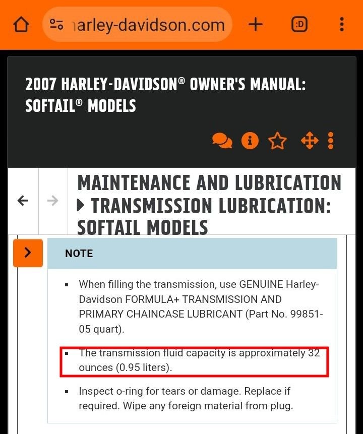

Originally Posted by Sammysho
Just bought a 2007 Night Train, test road fine, got it home to change fluid. There was "NO" trans fluid. How could this be.
Concerned the trans is damaged.
Filled and rode 30 mile , no problems or noise, shift ok,
Any thoughts?
Thanks John
Your 07 only needs 24 ounces, measure hot, bike level and dip stick not screwed in.
If you didn't drain it, it's probably a good idea to do that. Replace the o-ring on the drain plug.
This can be done with the bike on the stand. Put a short piece of paper towel cardboard tube up between shocks so oil does not make a mess.
I break plug with ratchet and then use a long Allen wrench to remove. Hold bike upright to finish drain.
Be sure to check primary to proper level, bike upright, cold primary, and fluid at bottom edge of clutch diaphragm spring. Primary takes 26 oz.
That may be where your transmission fluid went.
Nothing works better year round then Harleys's non detergent Formula +. Just the conventional one. You don't need the synthetic one.
Don't over tighten plug. Use correct o-ring. That's a special MS fitting. O-ring goes up in bevel. That face of plug torques up metal to metal so it doesn't vibrate out..
Check that black vent hose on the back on the transmission that goes down on left back side. Run a soft coated wire up it. Make sure no mud robber has plugged it.
That's the primary and transmission vent. Primary vents thru a passage way to transmission (clutch push rod also shares that passage way.
That shaft the passage way is in is the input shaft from the primary driven by the primary chain.
That input shaft runs in the output shaft that turns your small cog drive pulley sprocket for the belt back to the rear wheel.
Marvel of engineering and it's pretty tough. If you had some oil in it, your probably OK.
