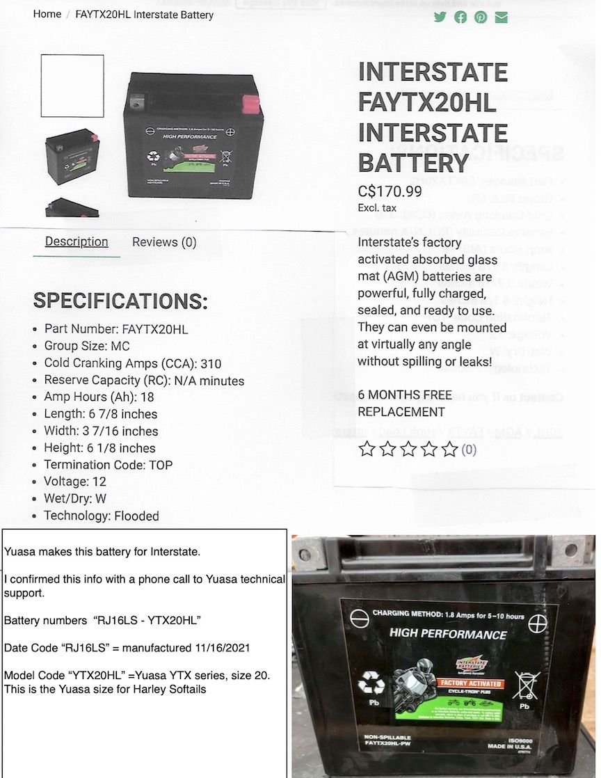

The Intersate is 330 CCA and the Yausa is 270 CCA and I would have to order it - which I may be doing if the Interstate does not show up pretty quick. Yuasa have always been good batteries. We don;t have Costco here.
If your softail battery is only 270 CCA, it's a smaller size or a different series number than I use.
I use the "GYZxxHL" series for my Harleys. It is an AGM battery. The "GYZ20HL" I use in my softails is 320 CCA.

I found an Interstate labelled battery that was made by Yuasa, in a used bike I bought.
I could tell by the numbers engraved in the case. It was clearly a Yuasa battery #, and a Yuasa tech verified my suspicions on a phone call.
Not regularly using the Interstate batteries, I can only vouch that the one particular model of Interstate battery I saw was a Yuasa. It's possible they use a different manufacturer (ie: East Penn) for others...
FWIW... The Interstate battery that was made by Yuasa was the Interstate FAYTX20HL. The give away Yuasa series number is highlighted here- FAYTX20HL. It is not the normal "GYZxxHL" series battery I use, but has good specs.
That is the exact one I am waiting for to come in. FAYTX20HL, it is $ 135, no core charge. It is listed as 330 CCA.

I doubt the "YTX" series is 330CCA. The higher level Yuasa "GYZ" series is 320CCA and is a little bit more $$$.
The ads I see for the "YTX" series say it's 310 CCA.

I bought my '09 CrossBones in October 2024. It came with the Interstate FAYTX20HL battery.

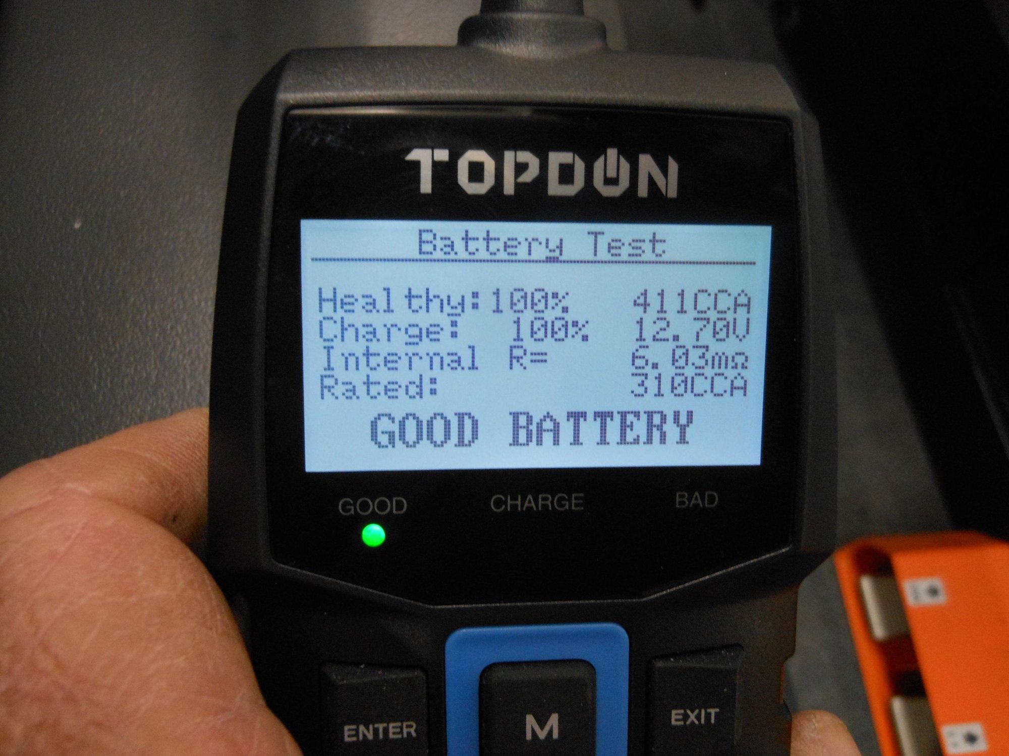

The manufacture date code on the battery, confirmed by a Yuasa tech rep, was 11/16/21. I don't know any of its history, ie: when it was put into service, how it was used, how it was stored, etc.. However it is still working well and is testing strong 3-4 years later. That's a good battery.
In 11-2024, I fully charged it, left it off the charger or tender for 48hrs and then tested it. It tested quite well for a 3 year old battery.
I am just going by what the tag shows, where it was supposed to be, and the battery tech when I asked. clearly showed 330CCA. I'll ask about the Yausa connection when I get the battery.
