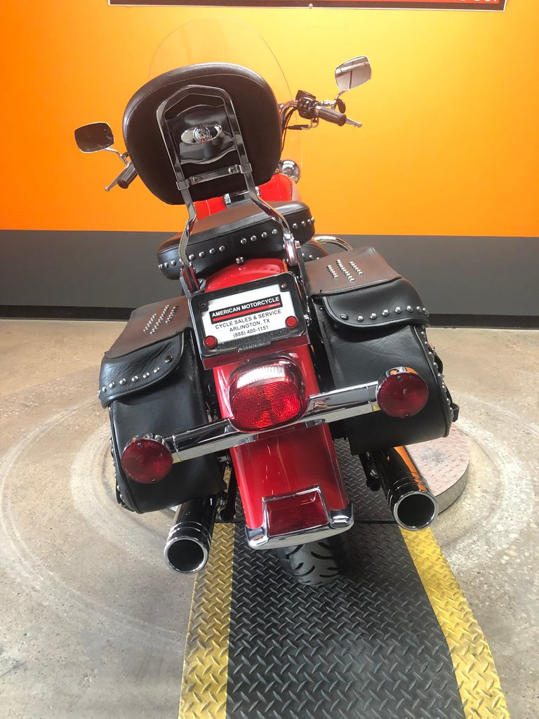

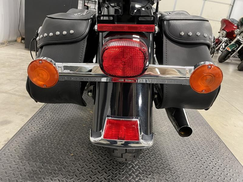

some are worse than others
KTF

Oh wow yeah that’s pretty bad. I guess I just never realized. I’m not going back with stock fenders so I guess I’ll see when I get them back from paint. I’m new stuff is fiberglass so not much I can do in terms of bending.
