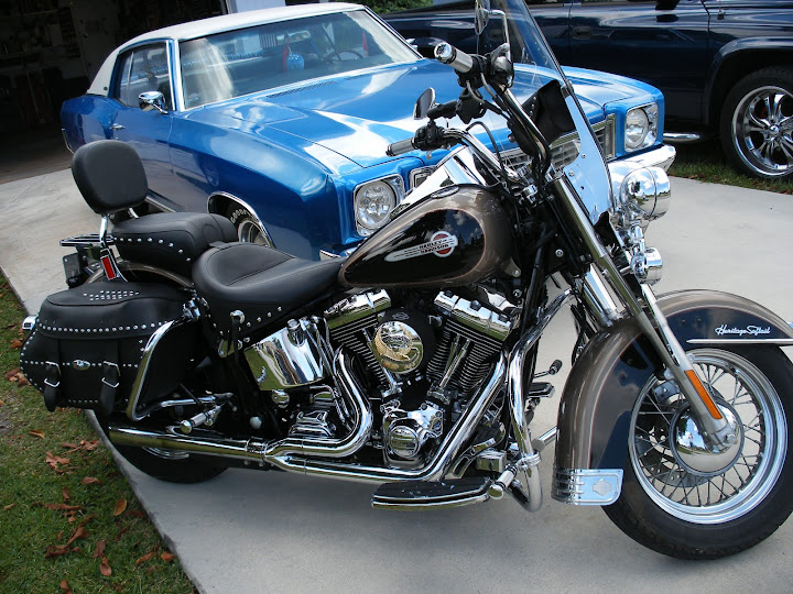

I have an open stage II K&N filter and really as long as you keep it clean and well oiled there should be little issue, however a strong downpour can do some damage. I have the HD rain sock on mine. I only intended on running it when it looked iffy and might rain, but once I put it on it stayed. I think it cost $25 or so at the local Stealer.
Not a great pic but you get the idea...
