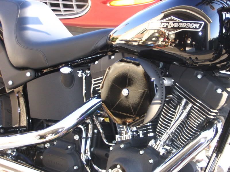

The AN Stage II is great if ya want max flow. The only issue is the stock football won't fit. You need an 8" cover like the older models used. If you like the ones that AN makes, cool. If not, you could always make your own cover. Hell! Let me know what you have in mind and I'll see what I can do. I am an aircraft structures mech by trade. I made a quick first try for mine when I put my AN Stage II on. I am going to make a couple different ones to see what I like. I made the first cover and it pretty much completely covers the Big Sucker II.
I didn't do any sanding in between coats on the paint and no clear. I just made this one quick for the oversized filter.
The backing plate on the AN Big Sucker Stage II is nice. No more S hoses. the breathers feed right to the venturi. No oil drippage!
Let me know if you want me to make something for ya. Something flat would be relatively cheap. The one I made for my bike raps all the way around the filter, as you can see. I know AN makes a few different covers that work with the bigger filter, mostly chrome.
