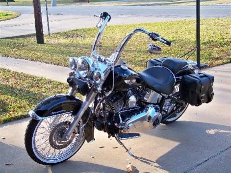

Here is a pic of my 09 Deluxe with the 14" Fly'in apes and 1" riser. I absolutely love them. Carlini products are first class all the way. If you Hill Country Customs for your cables, they know all the right lengths.
