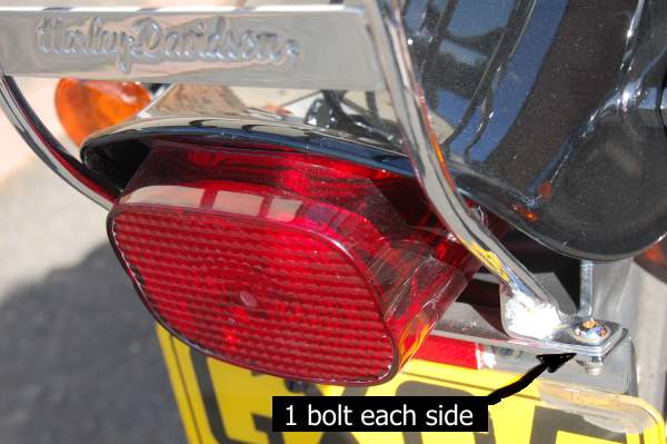

The seat screw holds one end as you say. The other end is two bolts through the chrome angle piece just below the tail light. Only takes a couple of minutes to remove it.

Thanks for answers. I don't remember having any metal to bolt things to under the tailight. I thought its all plastic. When rain stops, I'll get it out of the bike barn and look again.
Mcglothi - I think there is an adapter plate to use with the tribar light. I've seen that sold seperately.

I just installed one with my tri-bar LED taillight last weekend. As mentioned, you have to order a special taillight housing bracket for them to work together. You'll have to remove the taillight to install the new bracket, but once the bracket is in place removing/installing the rack is a breeze!
To install the rack with a stock taillight, you have to drill two holes in the bottom of the taillight housing bracket.

I got mine from the dealership. It depends on which rack you have, but with the one I've got I needed the HD Installation Kit P/N 59320-07. If you look up the taillight in the MOCO catalog, it will tell you which racks will work with it and which ones won't. I'm out of town, so I can't get any pics right now.
