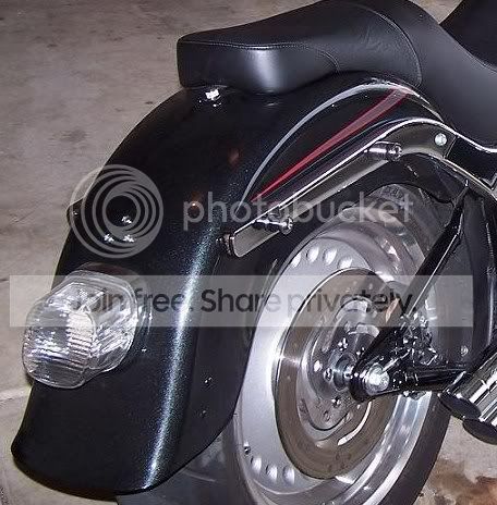

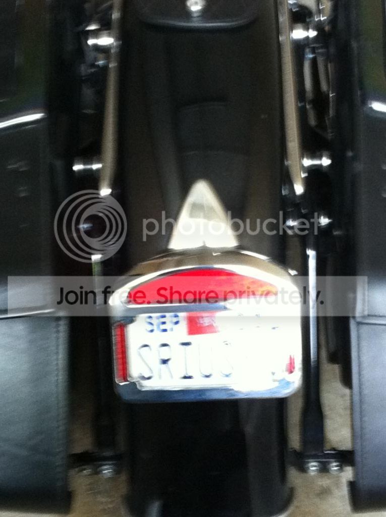

Here is what I am running on a 06 fatboy. It is all LED and did a little fab work to get it to work. I also wanted to keep visible turn signals and brighten things up. The only thing I do not care for is the plate location but I am working on that. Here is a link to the parts that I have, got them at a swap meet for much much less also. If you have any questions let me know. Also seen a few running with auto-gems and look good the LED are pretty bright from the ones I have seen.
Here is the light I am using
http://www.vtwinmfg.com/webapp/wcs/s..._141861_141865
Here is the bracket I am using although had to do some fab work to make it work, not much and vary doable.
Others have used these
http://www.auto-gem.com/
Attached Thumbnails Rear Turn Signal relocation for 07 FLSTSCI-p3200519.jpg   Rear Turn Signal relocation for 07 FLSTSCI-p3200524.jpg   Rear Turn Signal relocation for 07 FLSTSCI-p3200526.jpg   Rear Turn Signal relocation for 07 FLSTSCI-p3200527.jpg
