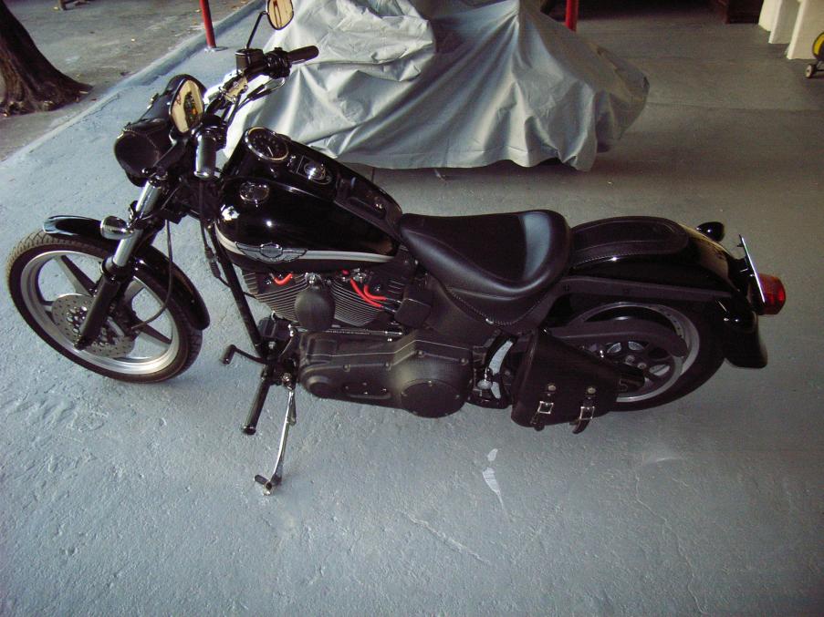

I had the same problem with my Night Train. Had my local machine shop turn out one-piece pegs from stainless steel then painted them with a rattle can. The pegs measure 7.5 inches from the mounting bolt to the end of the peg. Comfort level increased 10 fold. Pegs have never contacted the pavement.

Can't view those for some reason?
