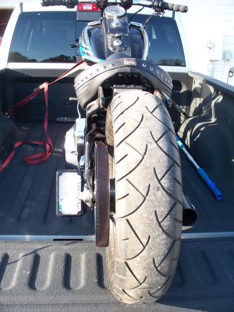

Having never owned an Evo framed Softail I was under the impression the frame rail widths were different. How much different? I wouldn't think much. The Swing Arm widths are indeed different thus why a change to an early Twin Cam arm will allow for wider tires such as the 180/200 (may not mattter when keeping the frame rails and a 150/160). I could see the belt being an issue. The variations of the Twin cam belts sure allow for some choices.
....I have a softail here with a wide pulley and a narrow belt. Never changed the pulley and have yet to have an issue.

welcome to the forums Tafster. I got a 160-16 Metzler on my BadBoy. the rim is a 16-3.00 from a 05 Night train.Two easy mods to get it on.Used a 1-1/8" semi late model belt and pulley.We had to machine around an 1/8" off the hub flange on that pulley to get the belt aligned.That's it.
Messing around now with a 18x 4.5 rim with a 170 on it and due to hub width of the wheel we're going to have to put around a quarter inch spacer or so on it.More than likely will spread the frame rails with a porta power. The stock fender will conform to the rails when bolted up.We used a late model belt so there's plenty of belt tire clearance with the 170. Same with the 160 on my bike with the 1-1/8" belt. Anything bigger than the 170 you have to hack the rails off.
Dang Tom you must be getting old to miss my post from above. We have done this same set up on 3 different Evo's now and all 3 are working just fine.I didn't grind anything fender or other wise.I use tee nuts in the stock holes to avoid any tire rub. You can put your finger between the frame horn and tire.On the 05 and back TC's just the tee nut is needed to avoid any rubbing with a Metzler 160.The Avon is just a tad wider but still goes in there.
