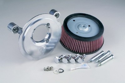

I ran a Stage 1 Big Sucker for about 4 years on my Train, and liked the look and performance of it.
But yeah the plate cracked, and yeah, I know how to use a torque wrench.
I just figure that sometimes **** happens.

before i put the s&s on i had a big sucker! it cracked on me!

Ive had mine for 2 years now 1st one I installed cracked and I USED A TORQUE WRENCH. Arlen Ness sent me a new one. When I installed that one I used gasket sealer on the the backing plate and tightend the bolts about as tight as you would a screw in your wristwatch. And used loctite. I actually have no problems there. What I do have a problem with is the oil thats supposed to be sucked back into the throttle body doesnt get sucked back . Instead it runs down to the bottom of the filter. After any lengthy ride I have to take the filter off and wipe down the backing plate. This has been this way since day one. And I keep my oil on the low side of the dipstick so its not overfull for all you critics. I dont know what the solution is other than maybe getting a Dougherty and capturing the oil in the little containers they have.??????
