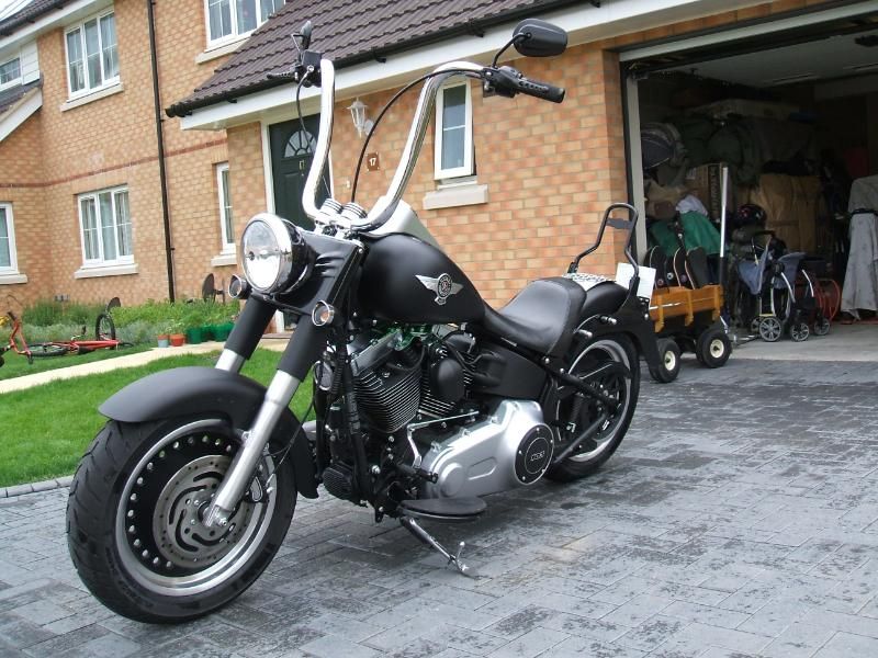

I just put 16' 105" on my 12 Lo and had to go with +12 from Barnett and the upper ABS line was good but wish it was a tad longer. I went back and measured and I think they went of a 10 or 11 because it was really only +10 to the stock length. the are making me a new one also because the caliper line I had to buy from them to sell me the upper was to short as well.
the brake lines are from Goodridge not Barnett, the cables were all good with +12. and get the NAMZ wire extensions if you have CANBUS wiring harness or from HD.

I'm telling you bro, I just did this. the clutch, throttle and wiring are perfect at +12 But I think they used a different yr for the upper so they are sending me a new one. I have ABS so it's a 3 part line, the total length of the upper line should be 37.5"
If you don't have ABS the 16" 1.5" Gangsters put the master cyl fitting 18.5" up fron the top tripple tree and 13" from the center of the tripple tree.
You can use those measurements to add to your stock brake line and where it sits and order your stuff now so maybe you can get it all at the same time and get it done.......
Good luck, you will love em!

Thanks bro! Your ride looks sweet!!

Thank man, I love this bike and the 1.5" bars just look perfect on the fat boy, can't imagine smaller tubing looking as good!
