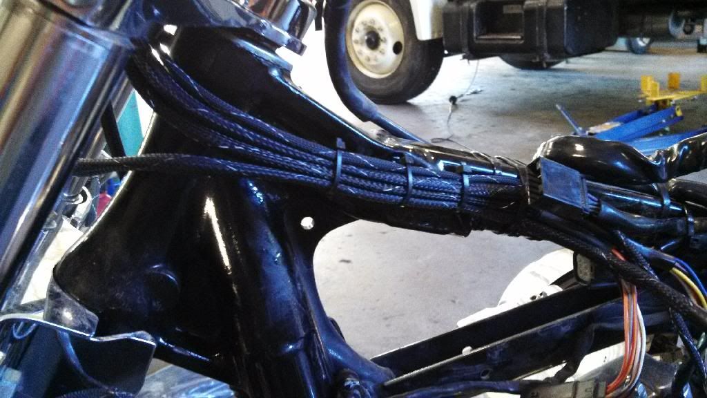

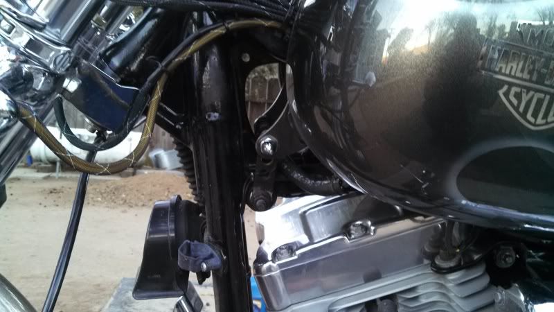

I got rid of the tupperware and re coated with braided loom, heat shrink and zip ties. Hope this helps.

That helps. Thanks for the pics.
