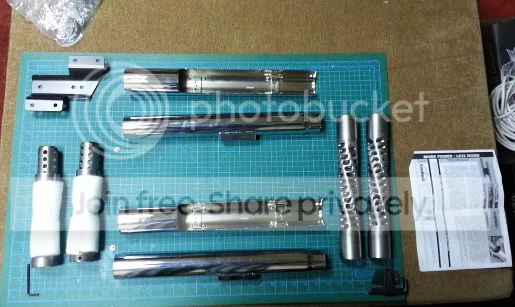

i have the V&H straight shots on my deluxe it came with baffles but i replaced it with the quite one its wrapped with fiber cloth and closed at the end .. it makes the sound deeper and remove the metallic effect , from what i read its only 3-5 dispel lower .. its still loud and i really like the sound ..
[IMG][/IMG]
on the right you can see the original baffles and on the left the quite ones
hope that helps
