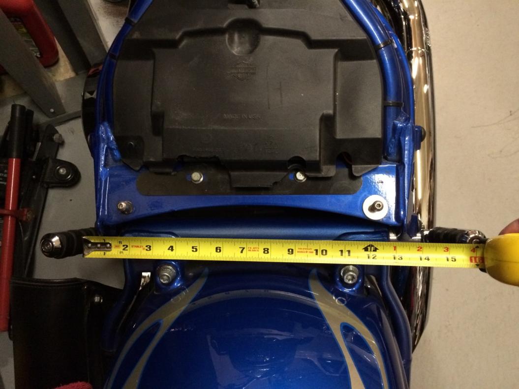

Looks like the frame is ~13.75" wide where the struts mount, and the holes for mounting the struts are raised a bit off the frame (at least for my touring setup it centers the struts), and the holes are ~3.8" apart.
I'm very curious now if all softail frames are the same (at least for the same year).
Attached Thumbnails Softail slim fender conversion - 2up problem-frame-width.jpg   Softail slim fender conversion - 2up problem-hole-mounting-width.jpg
