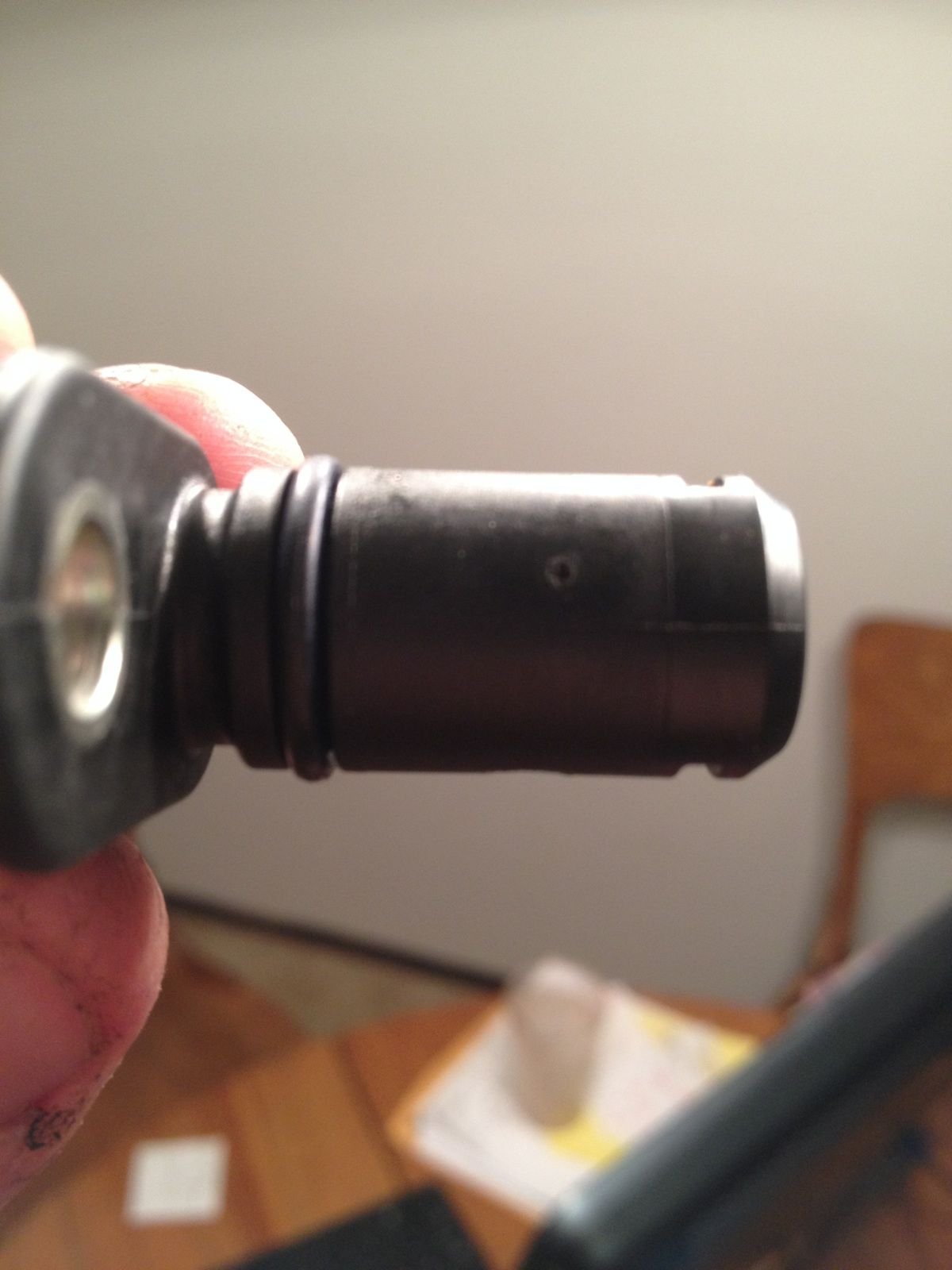

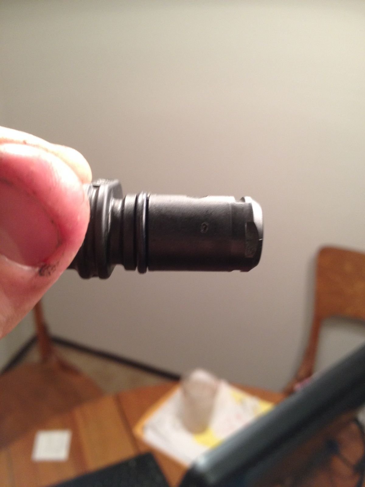

So I pulled the VSS after work today (was a bit cramped but I managed to do it without pulling off the rear wheel). It looks very clean, only had one small metal shaving on the end of it.
I did notice two small pits, 180 degrees apart from one another. Not sure if this would have any impact on performance, or if they're normal due to the manufacturing process.

Here are the images of the "pits" in the VSS. Is this normal? Would this be enough to cause an issue?

Looks ok to me. Do you have a tuner on the bike? If not, do you have access to a known good ECM? To swap in and see if this is the problem.
