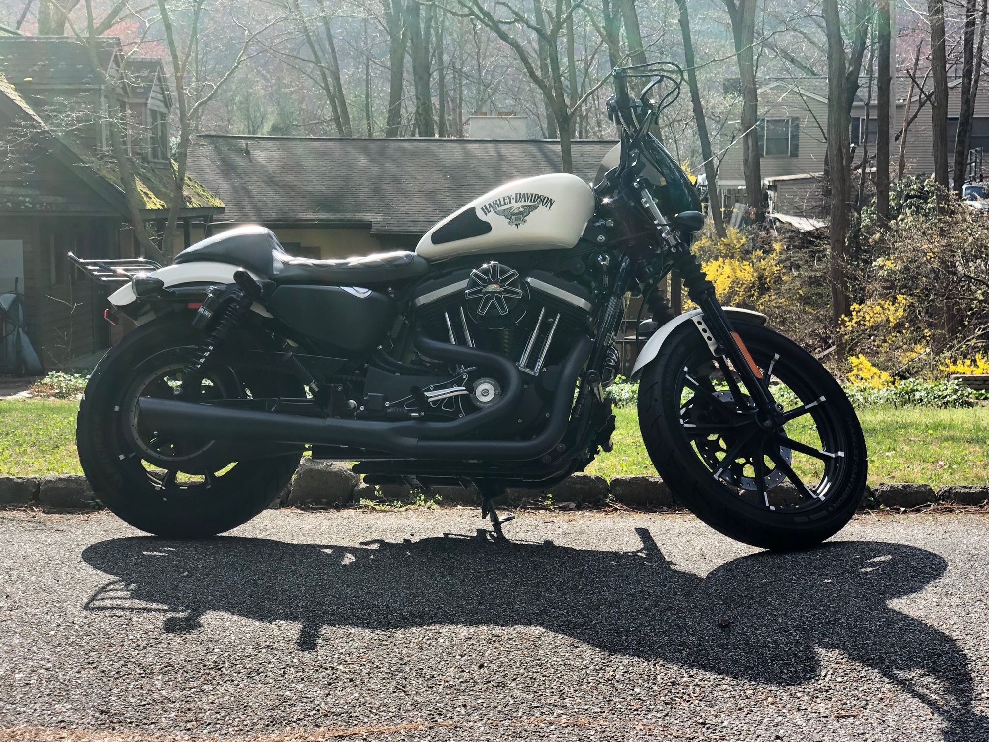

I want to give a shout out to Hammer!!!
I want to give another loud tout to Ken Puzio from Black Hills Customs!!!

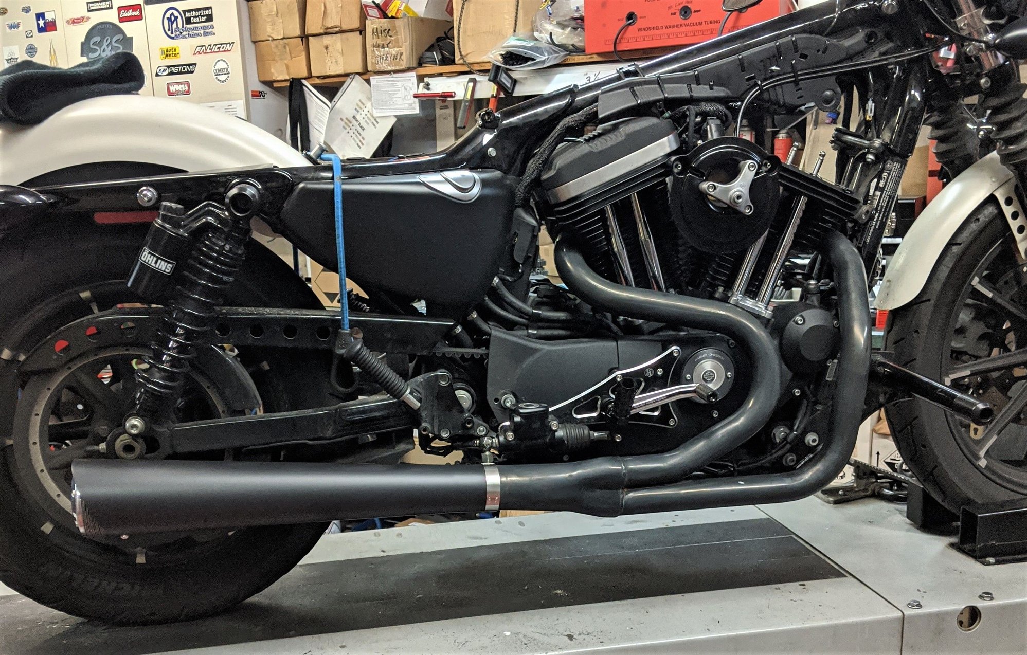

Just been running with the new Hammer Smash 1275 and the 560 cams on the supermegs 2-1.... installed and dyno'd by Ken -
new 30 degree reverse in the 1275-
little peek at the hammer head cnc job to match-
test fit on the new exhaust-
and now
The ducati panagale v4's in my neighborhood are very afraid---------!?!?!?!?
lol.... just all smiles no matter what gear I'm in-
Thanks Hammer!- Thanks Ken!

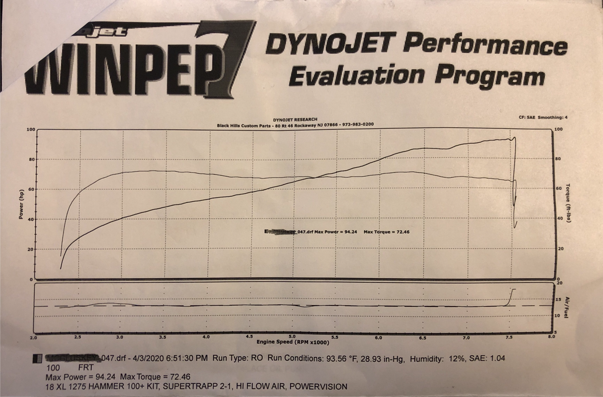

Thanks guys ok...
so dyno attached-
Didn't break the century mark but not too worried about squeezing the last bit out of the top end as she definitely has enough pull for me to learn to handle at this stage. I did want to get the db level down and keep the power which is one of the reasons I went with the trapp.... she's at 20 discs closed end... 92db from 3 meters idle (but honestly don't know the proper way to check the db level yet or what will give me the thumbs up to ride at Palmer.)

Good numbers man. I still have yet to dyno my 1275 build. Mines similar, 1275, 560 cams, 10.5:1 reverse dome pistons, and their impact 7mm head port job. I’m hoping to get similar numbers but I’m not running a 2-1 exhaust yet. Gonna wait until I find a 2-1 pipe I like before getting her dyno’d.
Enjoy that beast, I know I’m loving mine. It’s like night and day from the 883 😄

That’s a crazy long and flat power curve. Awesome-sauce! Don’t sweat the century mark as you stated. Fun bike to blast on!

I am a little surprised how low the torque numbers are on these builds, but the flat curve of it probably makes up for it. No torque or hp drop off all the way to 7500. Thats pretty impressive.
