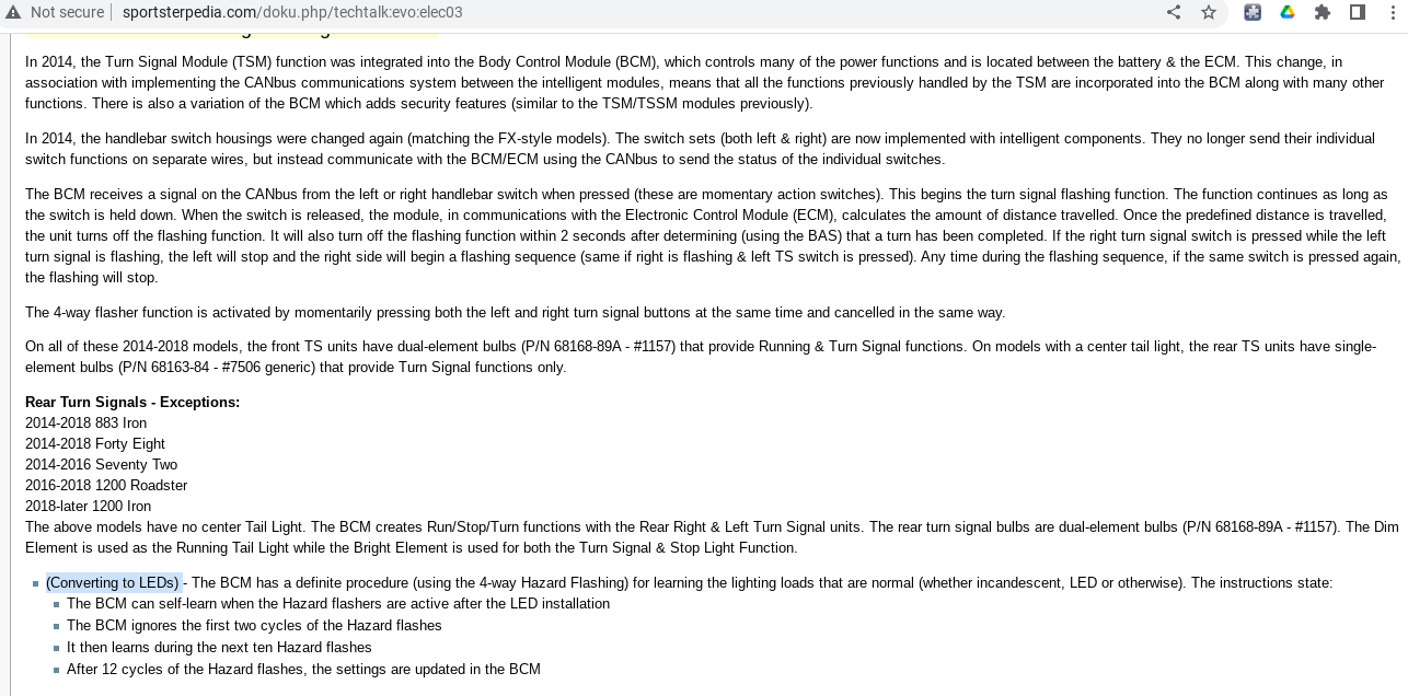

hello guys! im new to the forum, just bought my first Harley last week.
Question,I replaced the bulb in my front turn signal and rear break for my 2016 1200cc roadster, it works great but the indicator in my handle bar is hyperflasing. I bought a relay but do not know how to install it. or should i even bother to install a reley? will it break my lights?

If the bulbs are LEDs your bike should not need that "relay" for the LEDs to work. Your bike has the BCM wiring and if the LEDs are BCM compliant I'm pretty sure you can sync the bulbs by running the 4-way hazard with the ignition in the OFF position for about 3 minutes.

Sounds like you put the wrong bulb in. Harleys checks for problems in this system.
