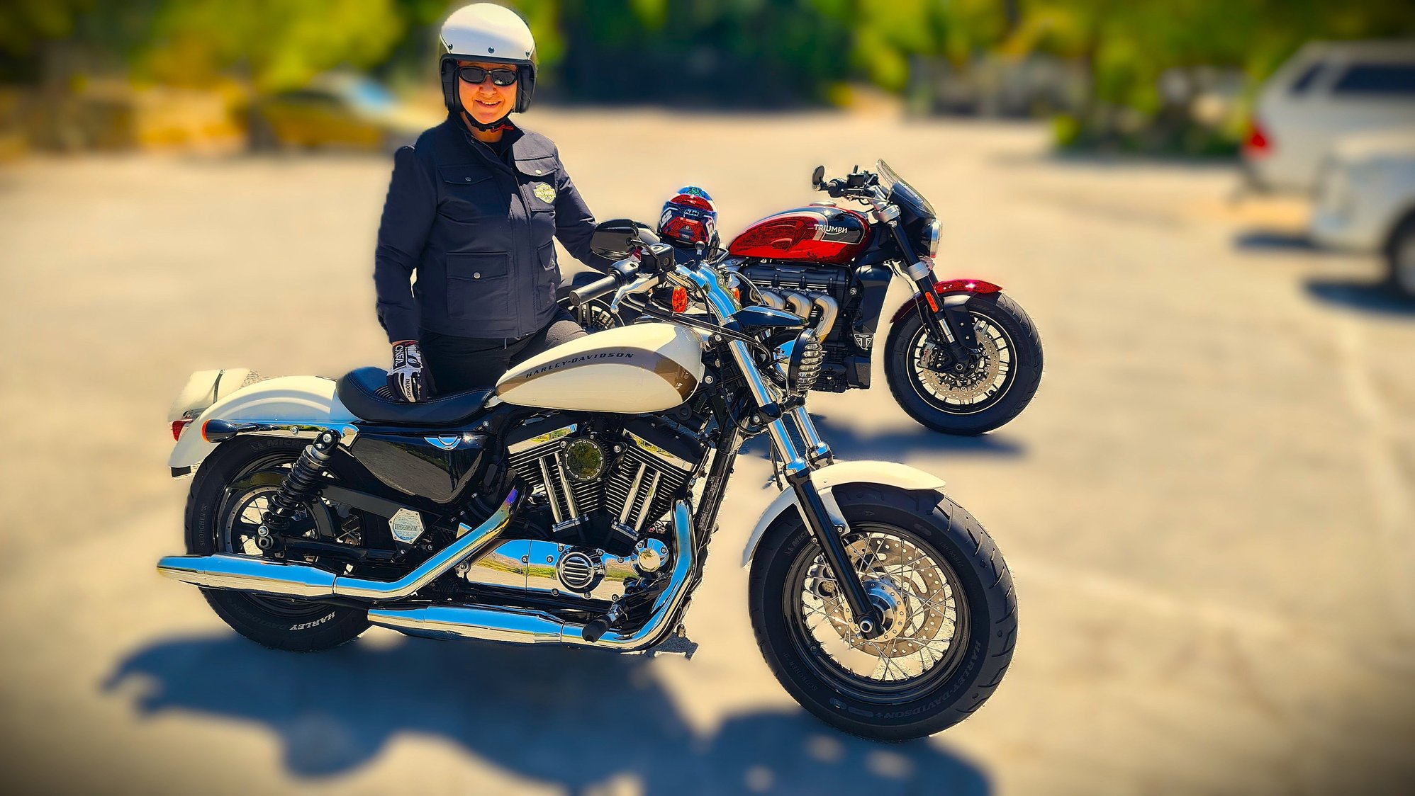

My wife's 2020 (MY18) starts up with a hesitation like having a flat battery but then fires up. I very recently bought a new battery for this bike from Harley. The battery is fully charged. Bike is fully serviced with very low milage on the clock. After fitting the new battery the startup stayed the same. Why do these Sportsters have this "strange" way of starting? Regards.

Your rear header is very blue. Is that the original OEM exhaust?

Motor is stock. The blue is because the chrome cover is pressed against the pipe. Everything checked out OK but I think the OEM Harley battery is just to light for the job! Regards!
