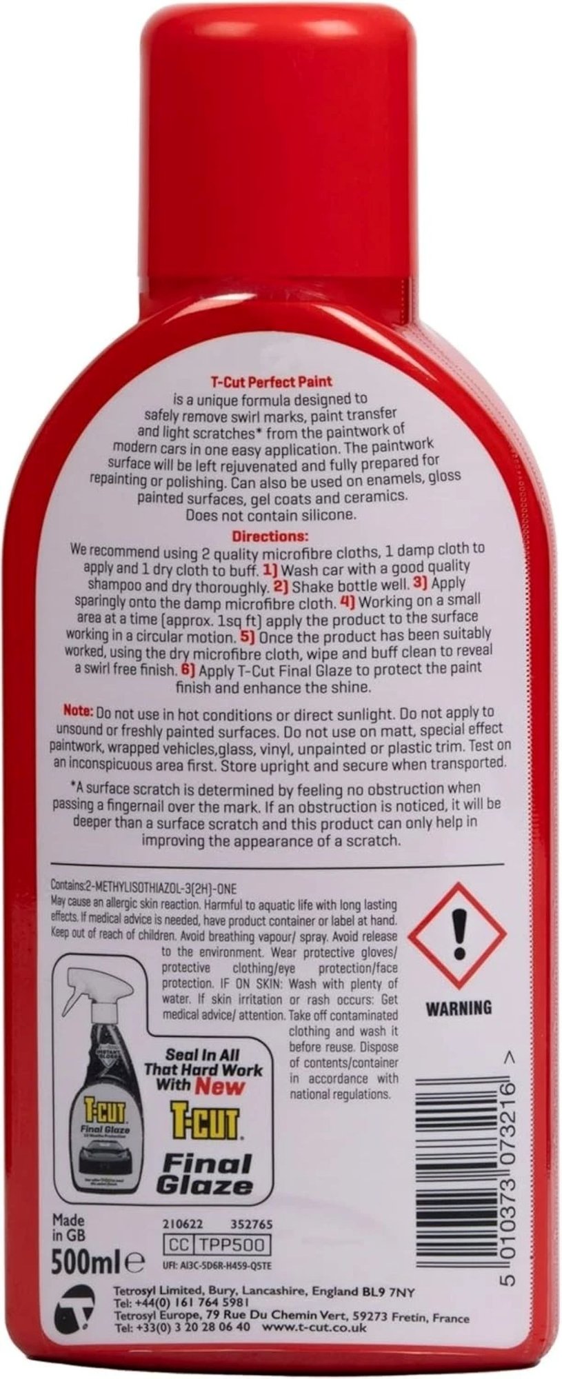

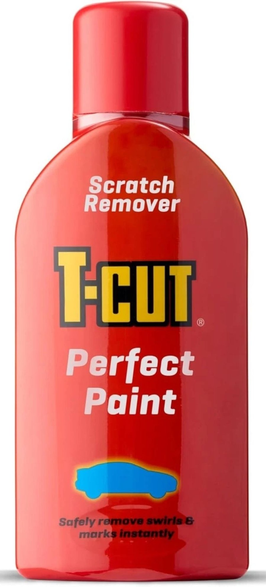

I use T-Cut Scratch Remover for just this kind of paint damage, I don't know if it is available in the USA, T-Cut is a tried and tested product here in the UK which has been around since 1954.
Good luck with removing the scratches in your tank.

It was one of those oh dear moments when cars got painted with water based paints and the original T-cut did nothing.
Scratch remover aka clear coat remover. The same as getting rid of a defect in wood, sand it down or plane it down until it's gone.
One final thought is to get clear coat and fill the scratch and then polish it out for a smooth edge finish.
