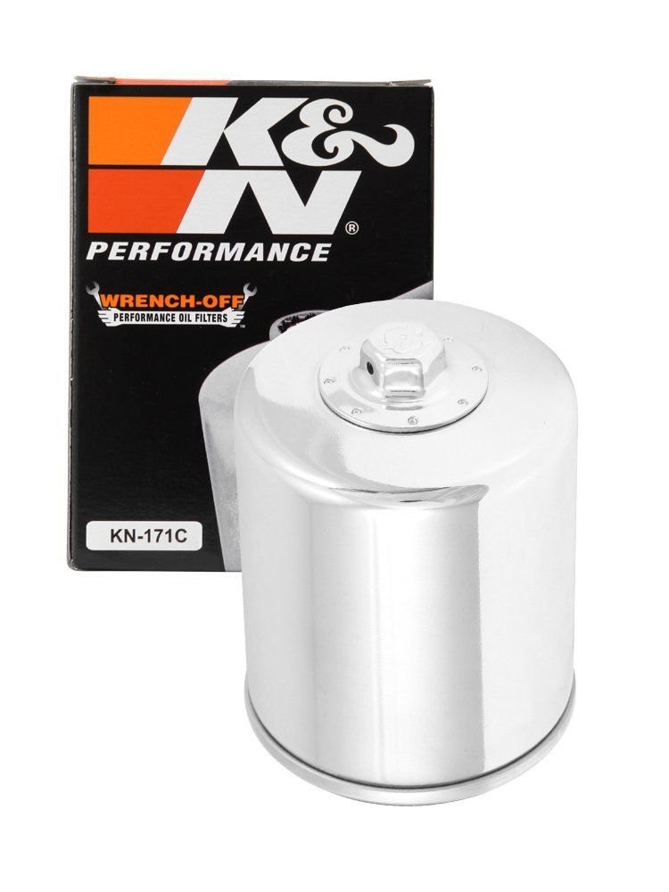

i switched to k&n filters after fighting conventional wisdom for years. the little nubbin on the top help the filter jumps right off with a socket or wrench. happy i stopped being difficult. they are also everywhere... no need to search for a dealer. win X 2!
K&N KN-171 or KN-170 ---(b) or (c) Harley Davidson/Buell High Performance Oil Filter K&N KN-171 or KN-170 ---(b) or (c) Harley Davidson/Buell High Performance Oil Filter
amazon is doing some shady price thing with them.. price has doubled since i last stocked up.
