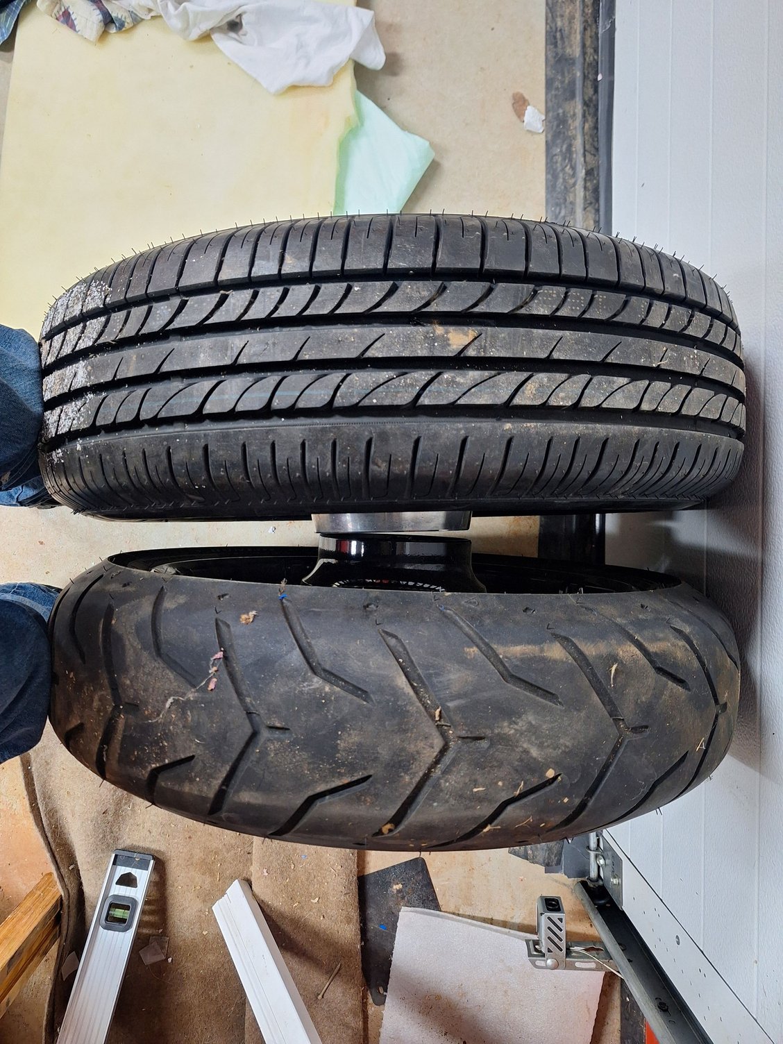

Most common dark side rear on 16 inch wheel is the 195/60R16 and the 205/55R16. The195/65R16 is used when you remove an 18 inch wheel withe the 180 motorcycle tire and switch to a 16 inch wheel.
195'65R16 mounted
New tire mounted. side by side with factory 180

Thanks for your reply, especially with pics.
You are sincerely appreciated.
