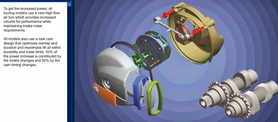

A review of the 2014 Rushmore camshaft is in order:
