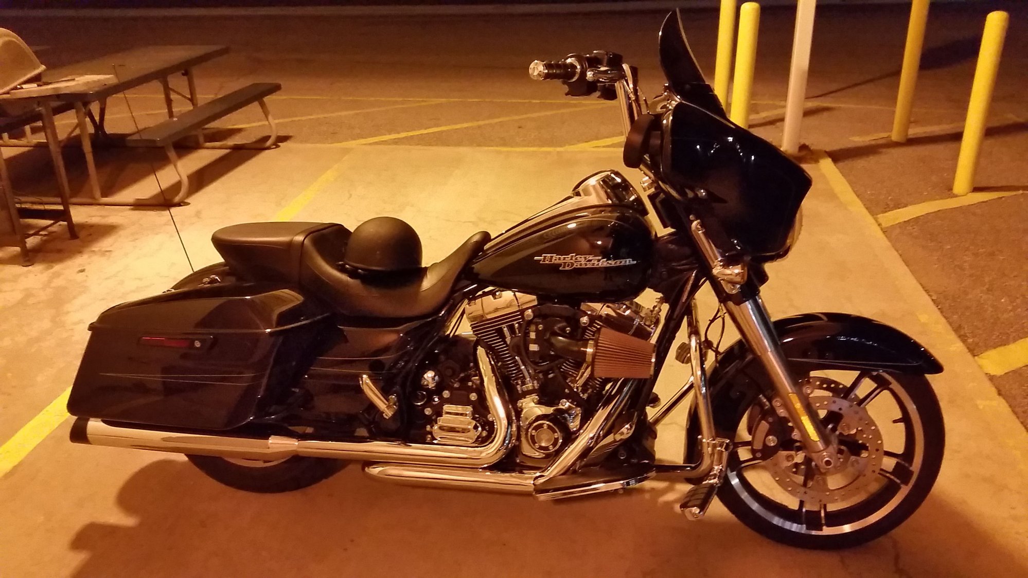

I removed the stock air cleaner and installed a DK Customs Outlaw 636V air cleaner and breather kit today and if seems like my bikes exhaust got louder. Forgive me if this is a newbie question, I just started riding last year, learning as I go. I have dresser duals and mgs mufflers. I don't mind that it got louder if it did, that's why I swapped out my hi-outputs for the mgs w/loud baffles.

Thank you. I'm running the FP3, going to do some more auto tuning today. Can't wait for the throttle body and heavy breather cover to show up to clean up the look.
