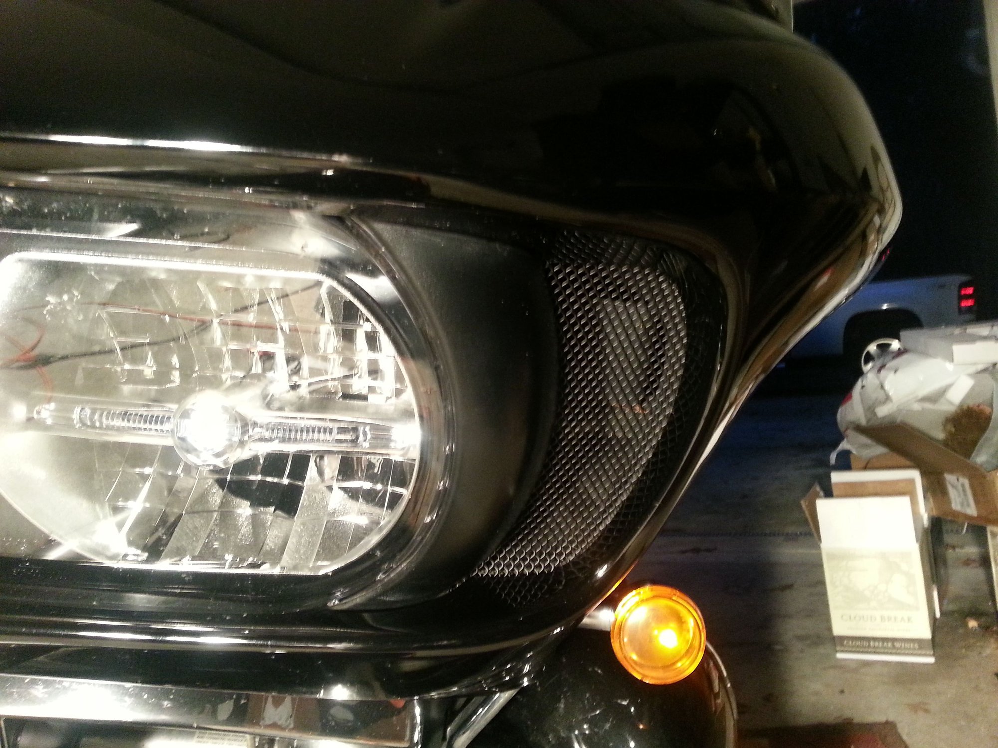

Just got my first HD. I love it!!!! Added a few things to make it my own... I fabricated some screens for the inlets. I really like the look. Easy to do...

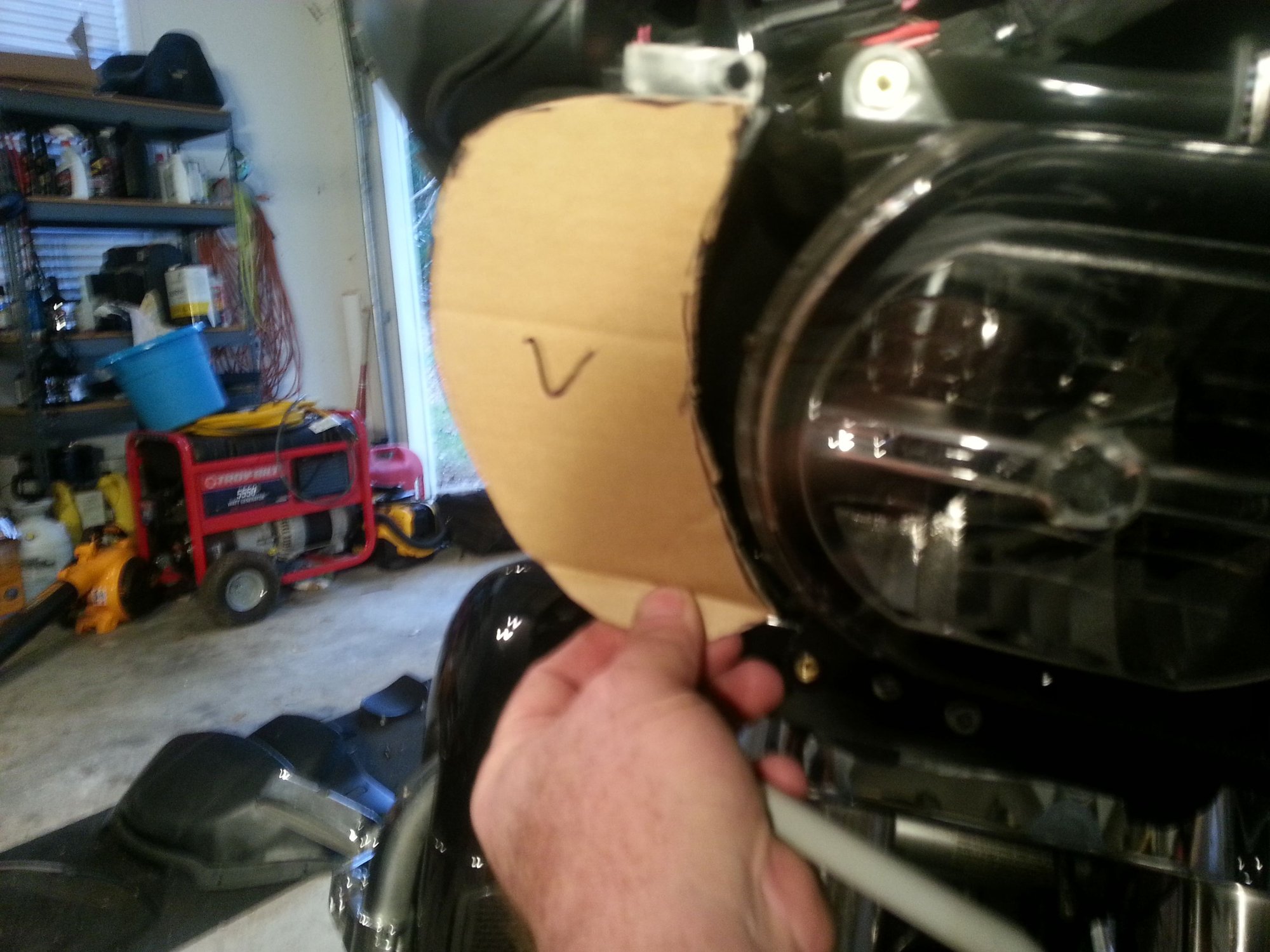

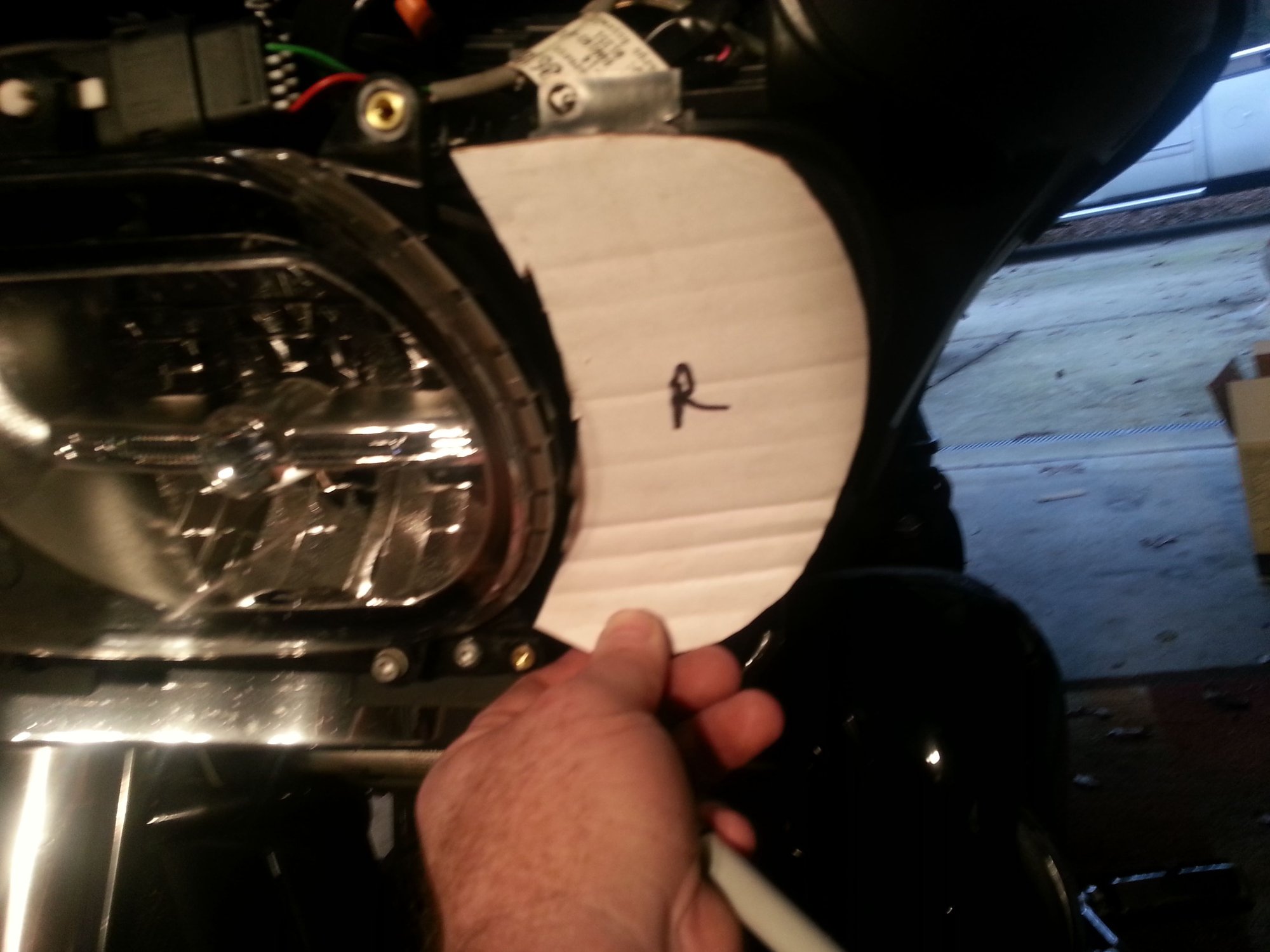

I do not. The dealership asked if I would do that for them. When i get back over there I can do that. The fairing has to be off to get it trimmed and placed properly. This is screen that I use on the inlets of race car I am building. With the fairing off, it is very easy to see where to trim the screen. I marked it with a sharpey and then I cut away, making sure I had it oversized and then trimmed as needed.The same screens can be purchased via Klock Werks for around $80...

did you clear over the decal, if not, how well do you think they will hold up to bugs and cleaner

I have not cleared the decal. I have contacted the company to see if they can provide me with the reverse image. i would then place that and have the image now in place painted on by a local pinstripper. As it is, I don't believe it will hold up too well to heavy cleaning. I just wanted to see how I liked it for future painting...

it looks good, I'D just have a layer of clear coat put over it and be done.

Love the screens, Great Idea!

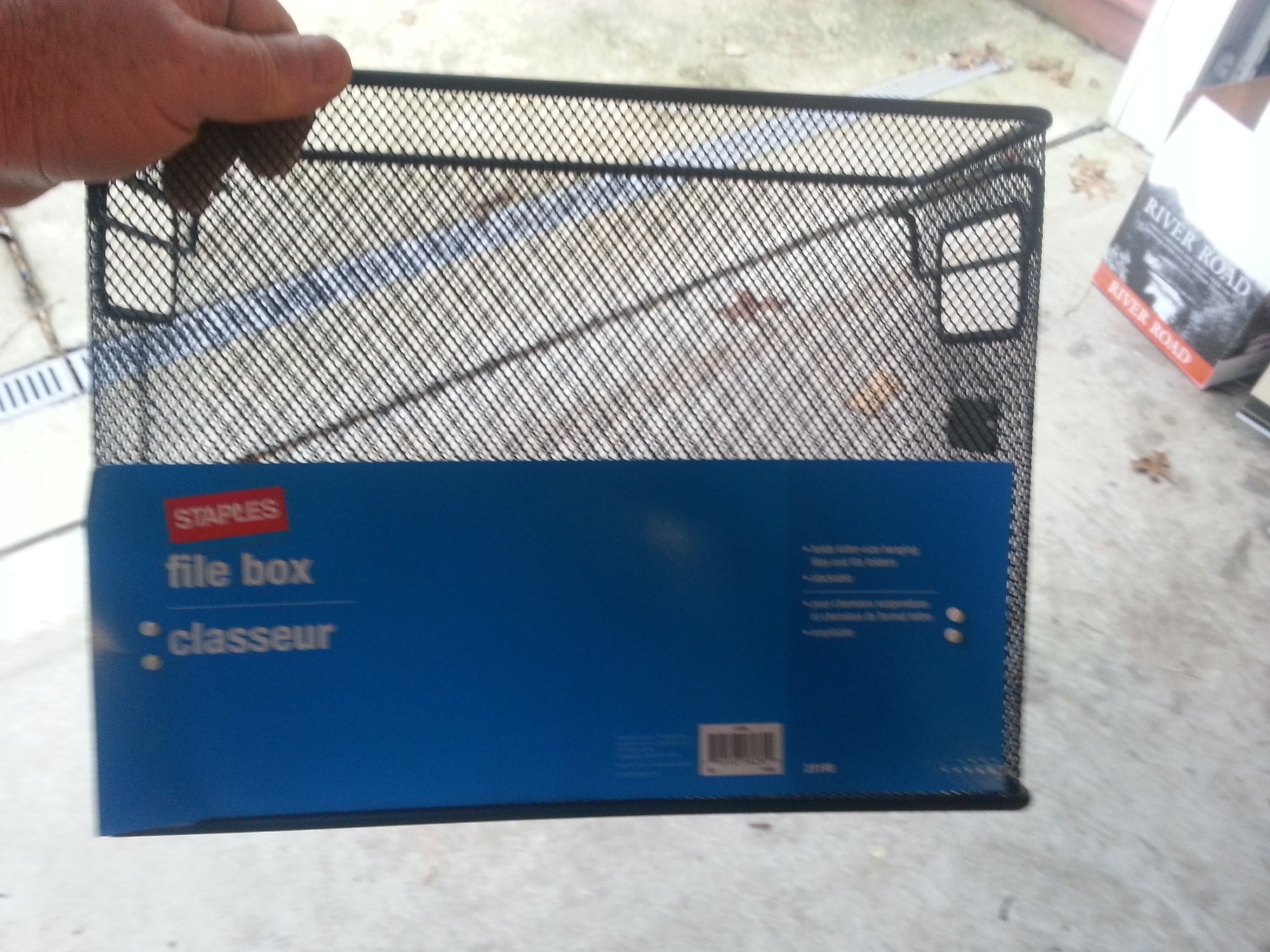

Made my screens from a $5.00 file holder.

Can use same to make cover for oil cooler
