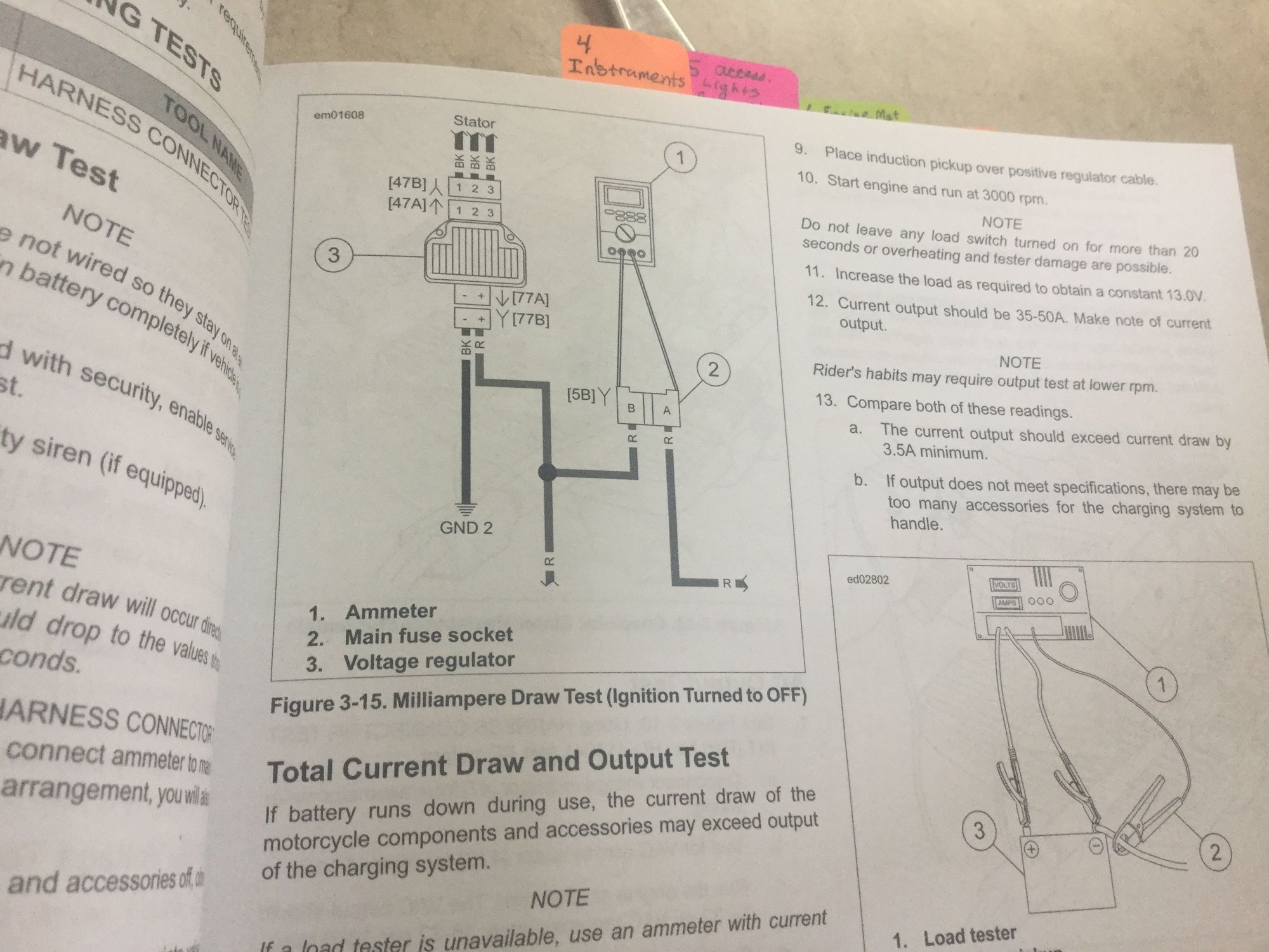

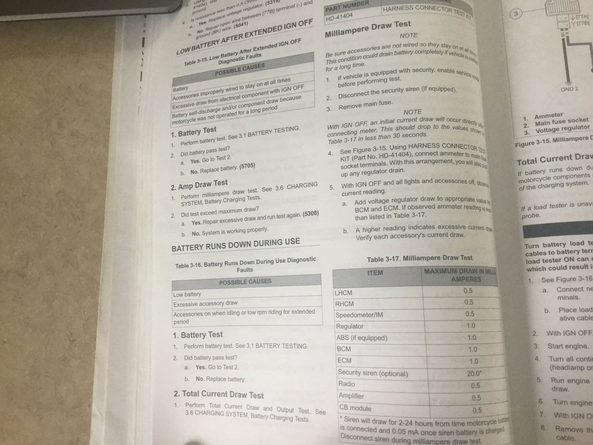

Do a current draw test with the bike off. If nothing after market is hooked directly to the battery pull the maxi fuse and install an Amp meter in it's place. if you have accessories hooked to the battery you'll have to remove the positive cable and install the Amp meter there. Once the meter is installed see if it shows an excessive draw, if it does start pulling circuit fuses until you find the circuit pulling the high current then try to find the reason.
Your Stator is rated the same as the maxi fuse, 50 amps.

Similar to above, fully charge battery, then connect a known good digital meter to the installed battery, note battery drain. Pull maxi fuse, volt drop should stop. Reinstall maxi fuse, observe volt drop, pull fuses one at a time until you find the culprit.
Once you know the problem circuit, chase it on down.
Not that complicated.
