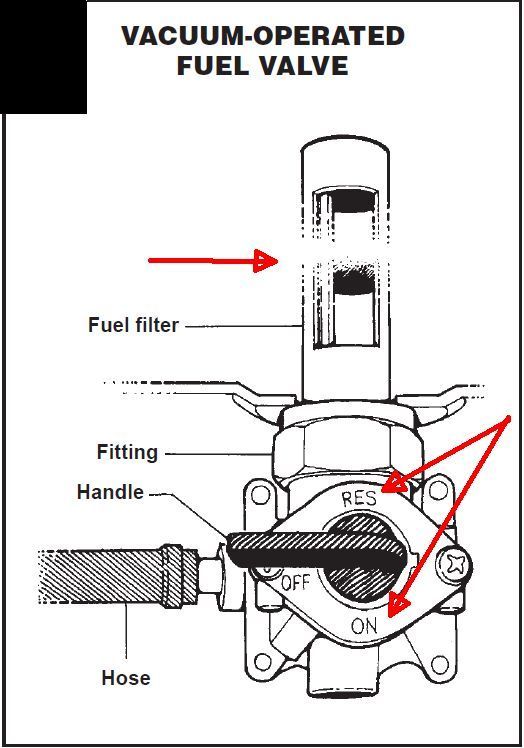

- Check DTC (Diagnostic Trouble Codes)
- As your front motor mount was changed check the connections to the regulator / CPS
- Fuel
- fuel valve
- vacuum hose to automatic fuel supply valve - check
- Battery
- Spark Plugs/Plug Wires
- Loose connections at coil, battery, ignition module
- Ignition system
- faulty coil
- ignition module
- MAP, CKP, TSM/TSSM - sensors

Yes look for all the vacuum hoses petcock. Check to see if you have any loose screws on the carburetor like the float Bowl. There's a little screen on the end of the petcock to I had one get real dirty one time that stop fuel delivery. Actually I've had all the above problems mentioned before.
Might sound obvious but what about a little starter fluid straight to the carb butterfly while trying to start? Fuel air spark to run. If it starts with the fluid spray let it quit and it's a fuel issue. If not maybe something in the coil or ignition module. I had mine go out while it was parked at work, no start that afternoon. New module no problems.
Trending Topics
Thanks for the replies everyone. I didn’t think the petcock had vacuum lines going to it but it makes sense. When I did the motor mount I had to jack the motor up a little bit, I bet I loosened one up enough that it fell off while I was riding. Also, I didn’t realize there was a fuel screen inside there, I might as well change that too while I’m messing with it.
If it dies without sputtering as if the ignition was turned off, I'd probably suspect something electrical and would start by checking for spark.
