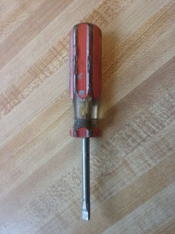

This tool cost me ~$32 shipped to my door. There are similar tools like this all over eBay and elsewhere for $40~$60.
However, they don't work on my 2001 so I did what any good wrench would do, I fabricated my own from an old screwdriver. It works perfectly.
