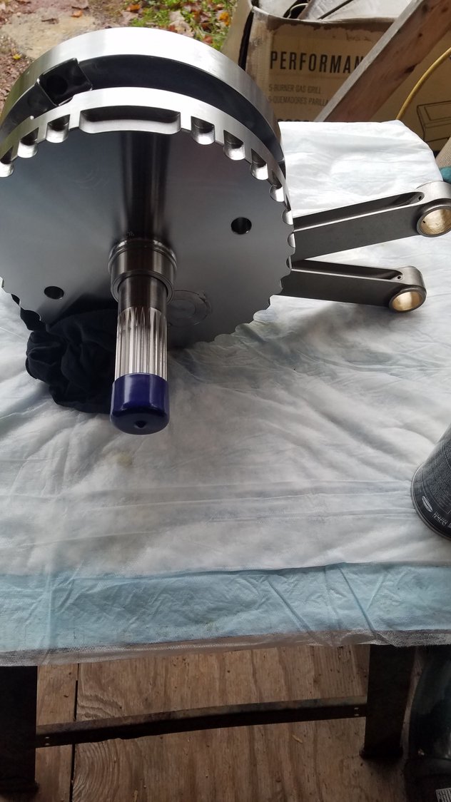

I think longevity is a roll of the dice no matter how you drive it. Are you going to spend 3 or 4k on your engine then drive like grandma heading to bingo? No. I'm not saying doing clutch drops and drag racing from every stop light either. I have an 08 cvo road king that had 43k on the clock. Crank runout had been holding steady at .003 and had good oil analysis. I had a good stage one setup but wanted more. So I got heads and cams. Bike ran great. I dont abuse my bike but i do make use of the power. All was well for 7k this summer then I felt some me vibration and it was downhill from there. All I did was hit the rev limiter in 4th gear passing a car. That's all it took to shift the crank. Found the big end connecting rod bearings were on the way out too. Just got done putting one of these in from darkhorse. Bike is so smooth now. Now I'm ready t9 build a monster. Build it ,enjoy it, break it, fix it.
