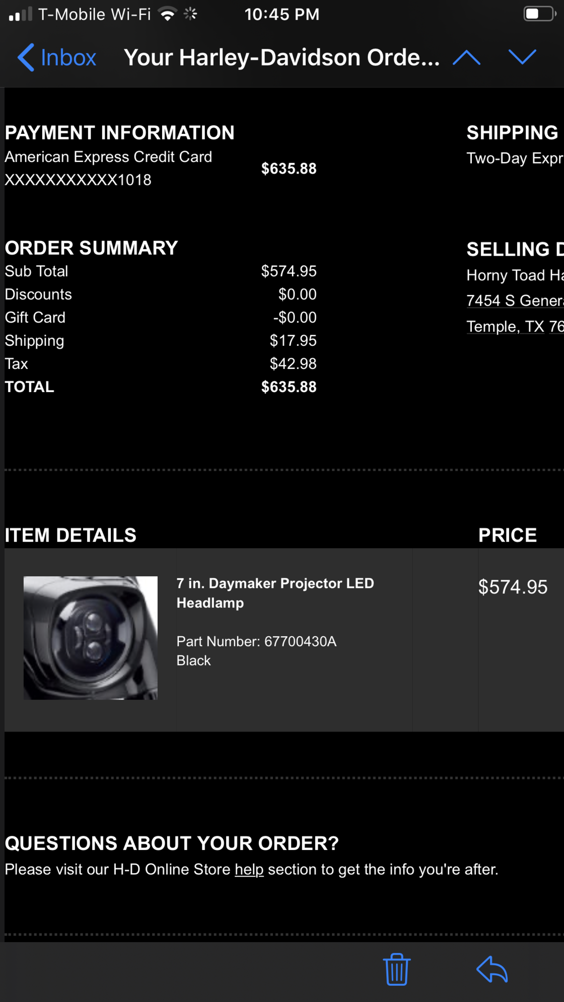

Anyone install a Daymaker headlamp on a 2020 Roadking? Before I take it apart, I’d like to know if it’s plug and play or not?
the instructions are not very clear.
Thanks

There are a number of different Daymaker headlamps (Reflector LED, Adaptive LED, Projector LED etc). What specific part number you talking about? Some appear to be p&p while others need a harness adapter.

I’ve taken it apart and it is far from plug and play. The box says it does not require any splicing but the directions tell you to do just that.
$600 for a headlight and it does not include the required harness? Aggravating.
The instructions are not user friendly and I can’t make out what exactly it wants me to cut and splice either.

Ok...after studying it more and trying to decipher the instructions....I started cutting and splicing. Exactly what I didn’t want to do and the reason I went with a 600 dollar HD part and not some Chinese Amazon sh*t.
I figured it out and it looks and works great now.
I still would inform anyone who buys this light, it is NOT plug and play. It would be so easy for them to just have the correct adapter in the box.
