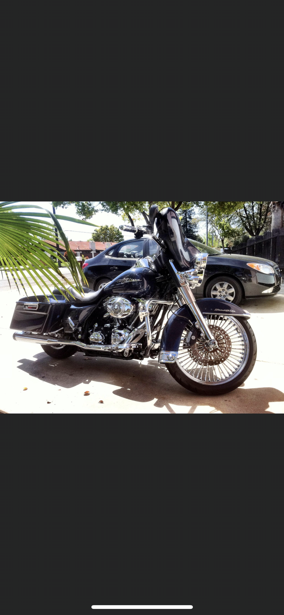

I have a 2008 FLHX that I put a 21” Diamond cut spoke wheel in the front. Yeah you should drill the mounting holes and tilt it because the tire will come in contact with the fender while riding it. Mines did until I tilted it. And yes I replaced the rear with an 18” and it did handle better. Without the 18” to me the front felt heavier. I did lower the front and back by 1” also.
