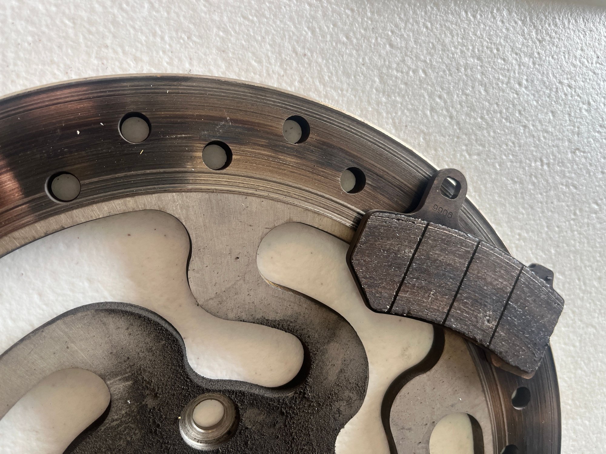

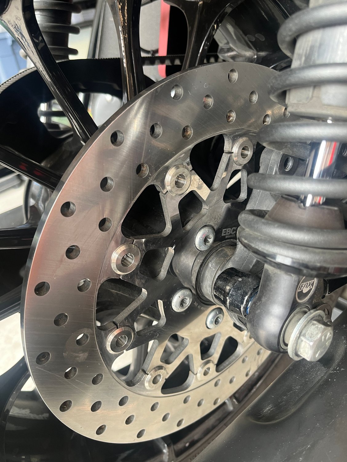

Went for a ride to bed in the rear brake, now to get some time and heat/cold cycles on it before I reach any conclusions on the EBC brakes, but as I type this I'm not very impressed. After bedding the pads I let it sit for about an hour and went back out. At this point, the cold bite is not good at all. Maybe with more time it'll get better.

Originally Posted by 702
Oof, baby got a bit hot. I'm way too old to ride hard
It was due.
I never paid any attention to the rear rotor, and didn't notice that it wasn't a floater. It is now, and much prettier.
If I had floaters in the back of my bikes I would be
Replacing the buttons every couple thousand miles.
I’m hard on them.

The rear braking action is getting better, gonna keep rolling up some miles and hope they keep improving.

I thought I would circle back here with some final thoughts.
With the rear EBC rotor and EBC HH pads braking got better, but nothing to rave about. With just over 56k miles, my fronts were needing some love to, so I ordered 2 more EBC rotors and installed them and the same EBC HH pads.. Went out and bedded them in and did a few heat/cool cycles.
Wee doggies! Way better! They are quiet, and the cold bite is much improved.
This is one of those projects that had me questioning my decision on these parts, but in the end I'm pleased with the outcome.
