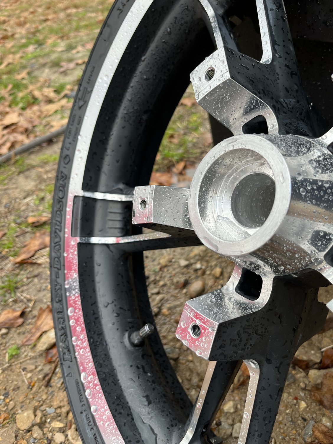

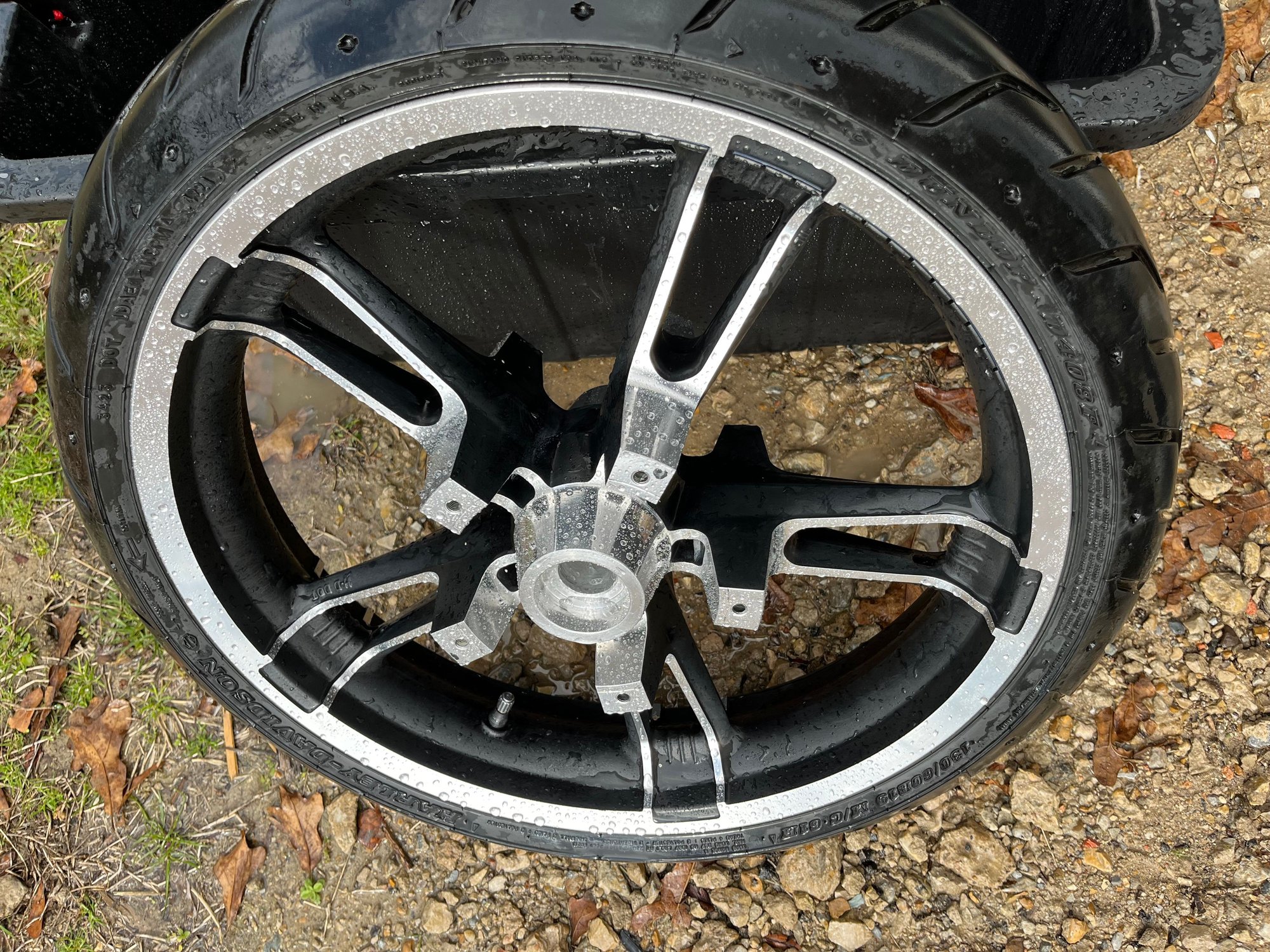

Originally Posted by NorthWestern;[url=tel:21514025
21514025]Damn! What polishing wheel are you using? There might be hope for my factory rims on my 2500HD after all!!
Looks good
LOL Just the generic felt polishing pads on a Dremel to get the tight spots and really deep corrosion. Then some harbor freight cotton buffing wheels on a drill. I’m using 3M Perfect-it rubbing compound. Once I’m done with the compound, I’ll be cleaning the wheel and then going over the aluminum with Rolite metal polish.
Originally Posted by dawg;[url=tel:21514028
21514028]Ya missed a spot!
I know you’re kidding but that corrosion is way too deep in those spots for simple buffing and polishing. I’ll have to wet sand it to get that out.

Originally Posted by BrandonSmith
Getting there...
Before:
After (just those two rotor mounts):
Also after. You can see how deep the pitting is (was)...
Brandon, are you doing a combo of sanding and polishing compound?
No. only as described above with the polishing pads.
If I feel like getting the little specks of corrosion, I’ll hit it with 2000 wet sand

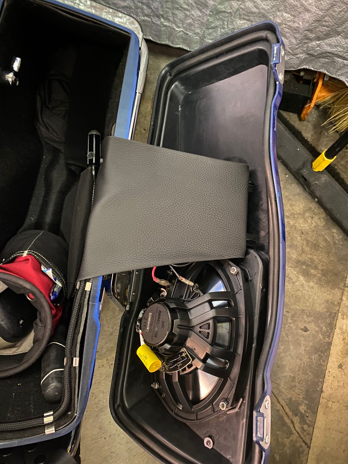

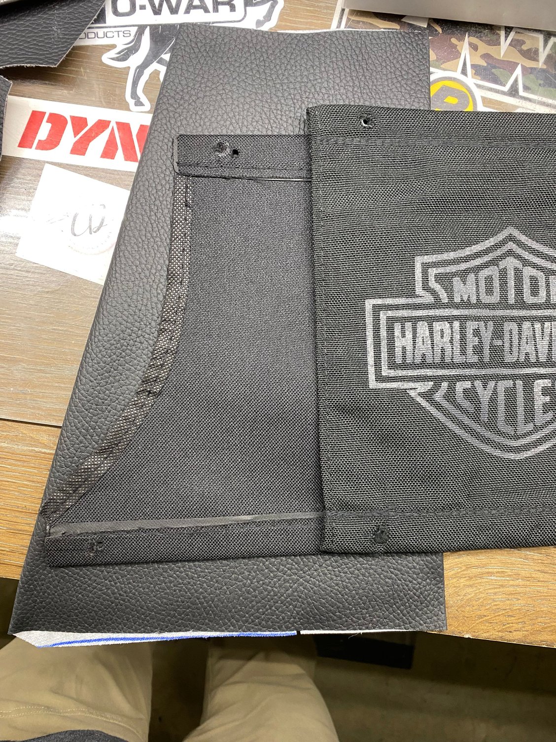

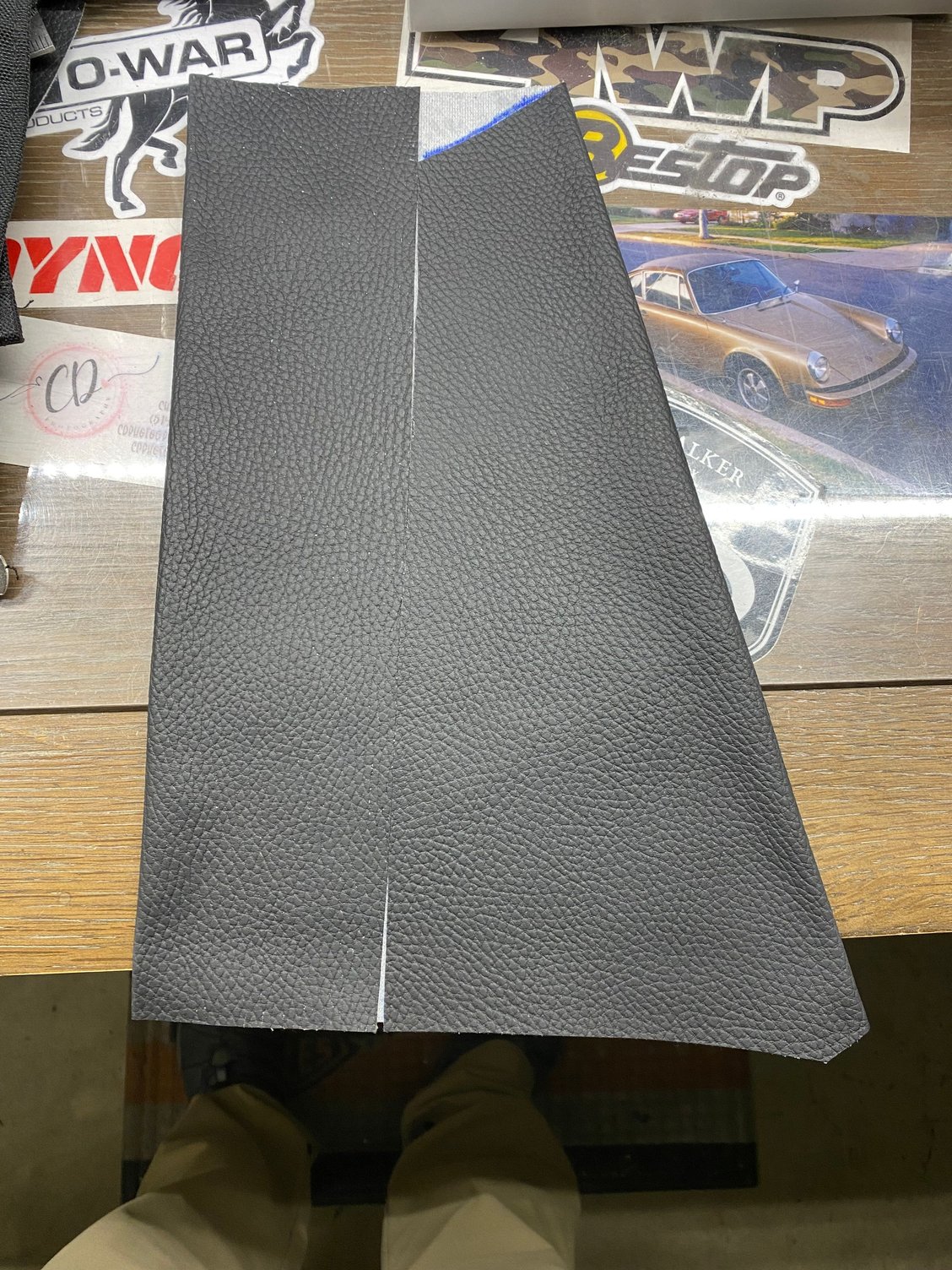

I wasn’t liking the tethers that came with my speaker lids, so I made a new pair out of the same vinyl used on the seat.
Slightly longer to allow the lids to open more like the factory setup.
Not bad for a DIY without sewing them.
To make them a bit more appealing I might have some blue stitching added.

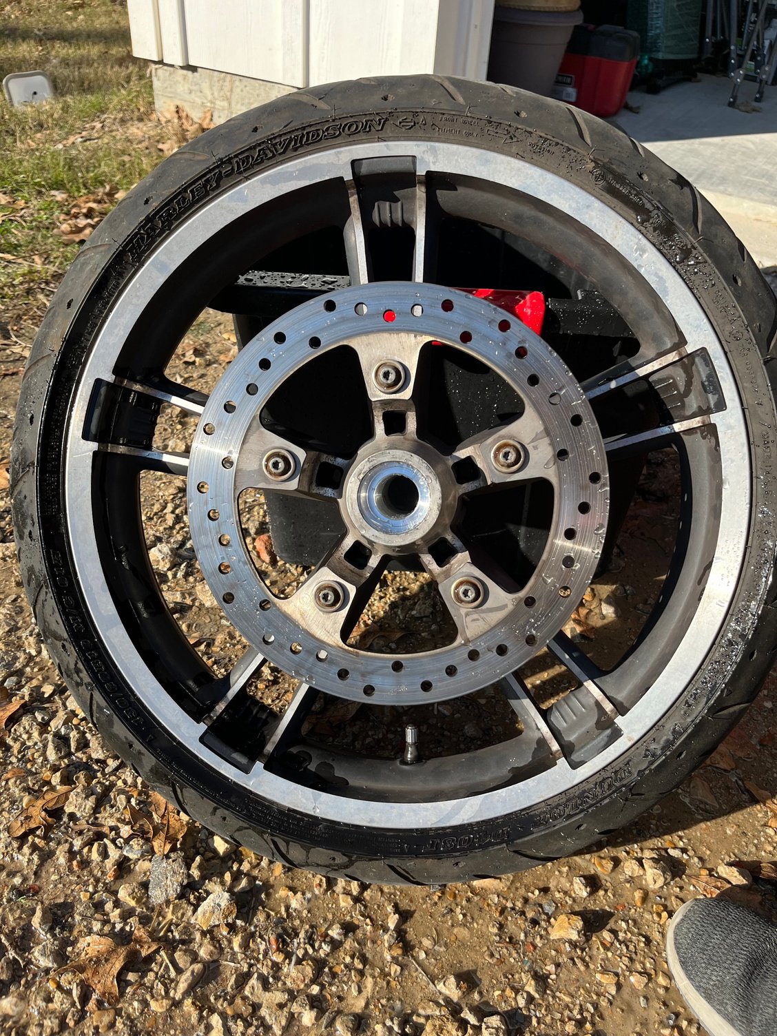

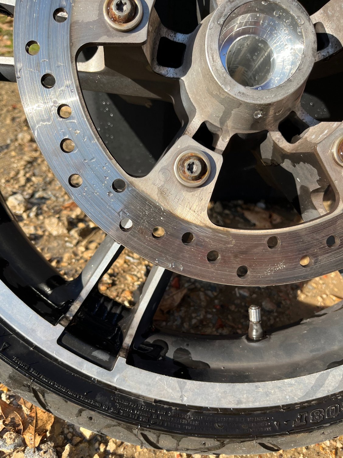

Finished compounding/polishing/cleaning the front wheel today…
BEFORE
AFTER
