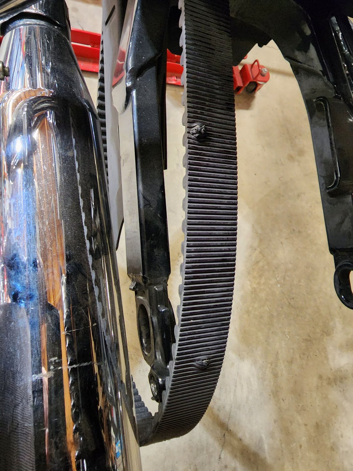

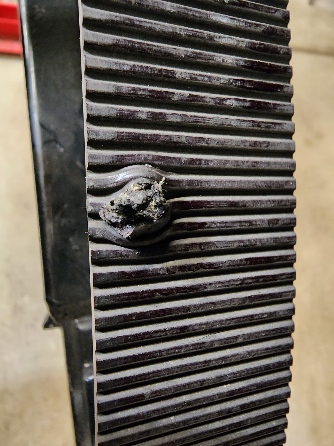

Because it does this and pretty much makes you, or at least me, say "Hell no, not riding cross country on that!!"
Fresh chip seal in the neighborhood.........

Little stones CAN get up in the path of the belt, when they do they put TREMENDOUS strain on that belt as it really has NO give.
Thats why you see what the previous poster posted.
They CAN destroy the belt in short order.
Some continue, I have had the bad experience of the belt being destroyed while riding twice.
Once on the highway in the left lane, try getting over 3 lanes with NO power and idiot drivers coming up on you quickly, Pucker factor to the moon.
The other time was riding a country road 200 miles from home.
YMMV.

I once had a steel washer embedded in the drive belt of a Yammie. Yanked it out with pliers, no issues.
My thinking is to not worry too much about a little crater in the belt. Anything more I'd swap it out.
