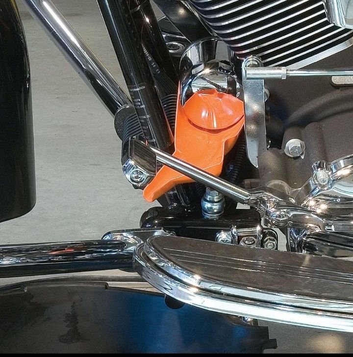

@Dano523 posted this pic of his oil filter funnel a few days ago.
I suppose he could own a Sportster in addition to his Touring Model. Since this thread is in the Touring Models sub forum, I assumed he was talking about installing a new belt on a Touring Model. Either way, he never answered my question, so it's left to speculation.
