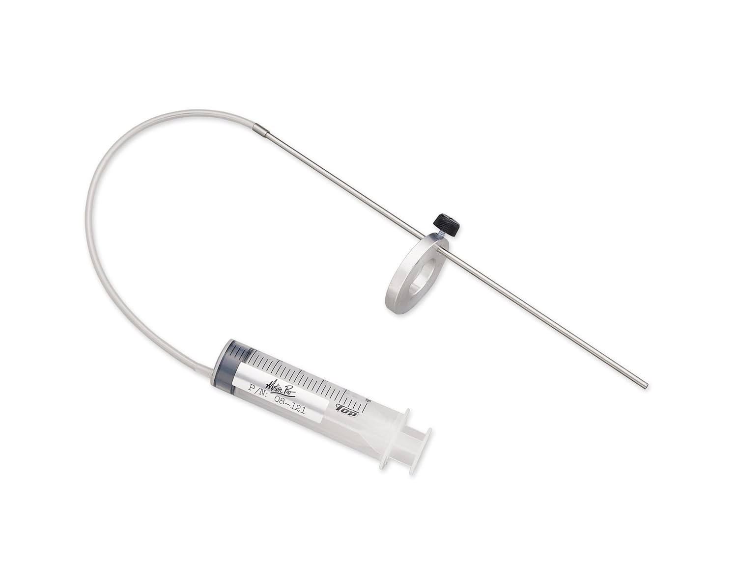

Agree, since you are going to have the springs out anyway, this is the preferred time to fill with oil. If you have one of those Motion Pro syringes that siphon excess oil out to attain the desired level, all the better. But if you accidentally overfill, just pour some out and have another go at filling to the correct level.
