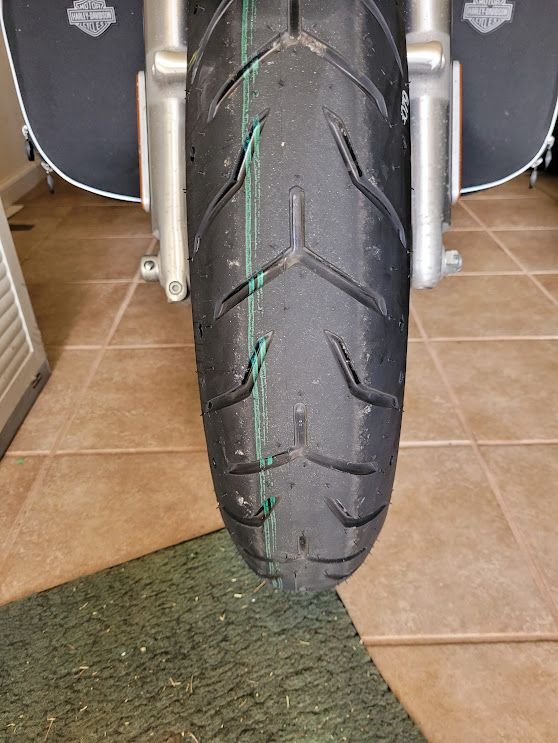

I got this Tire at my dealership got 16,000 miles on it pretty sure it go up to 20,000 to get down to the ware marks. I had to ask for this tire they said it was made just for the FLRT freewheeler
Harley Davidson 130/60B19/MCG1H Dunlop D408F. (my 2015 FLRT) been running 36psi it's wearing in middle wish I'da run 33 instead, should have posted present Pic!
