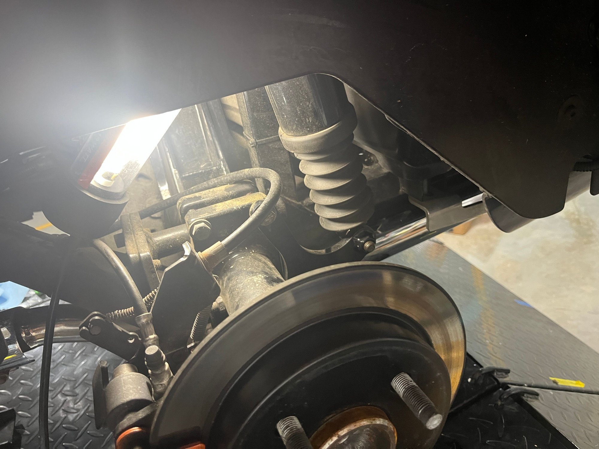

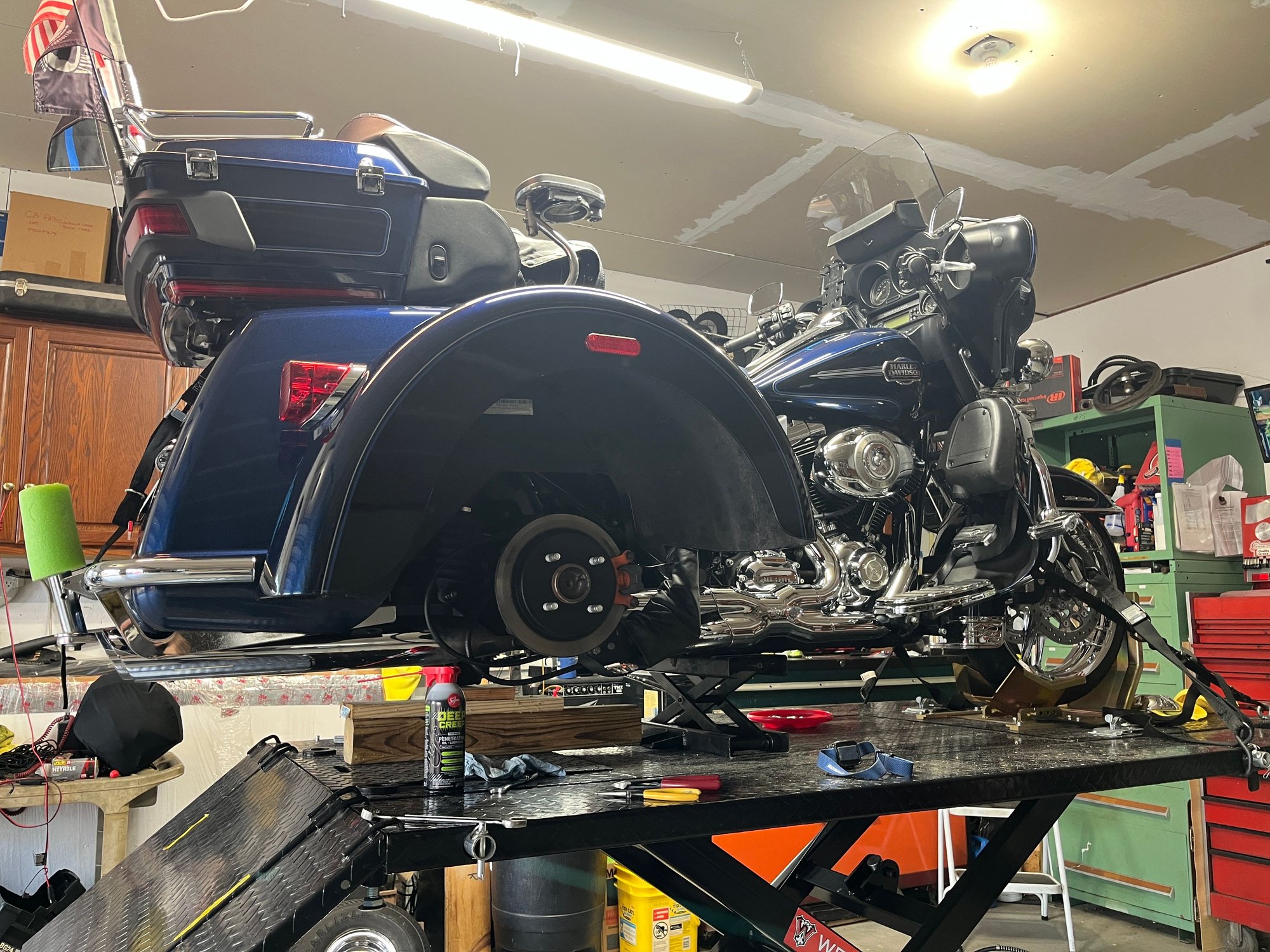

2013 Triglide
Next Gen shocks and comfort lift
Prep:

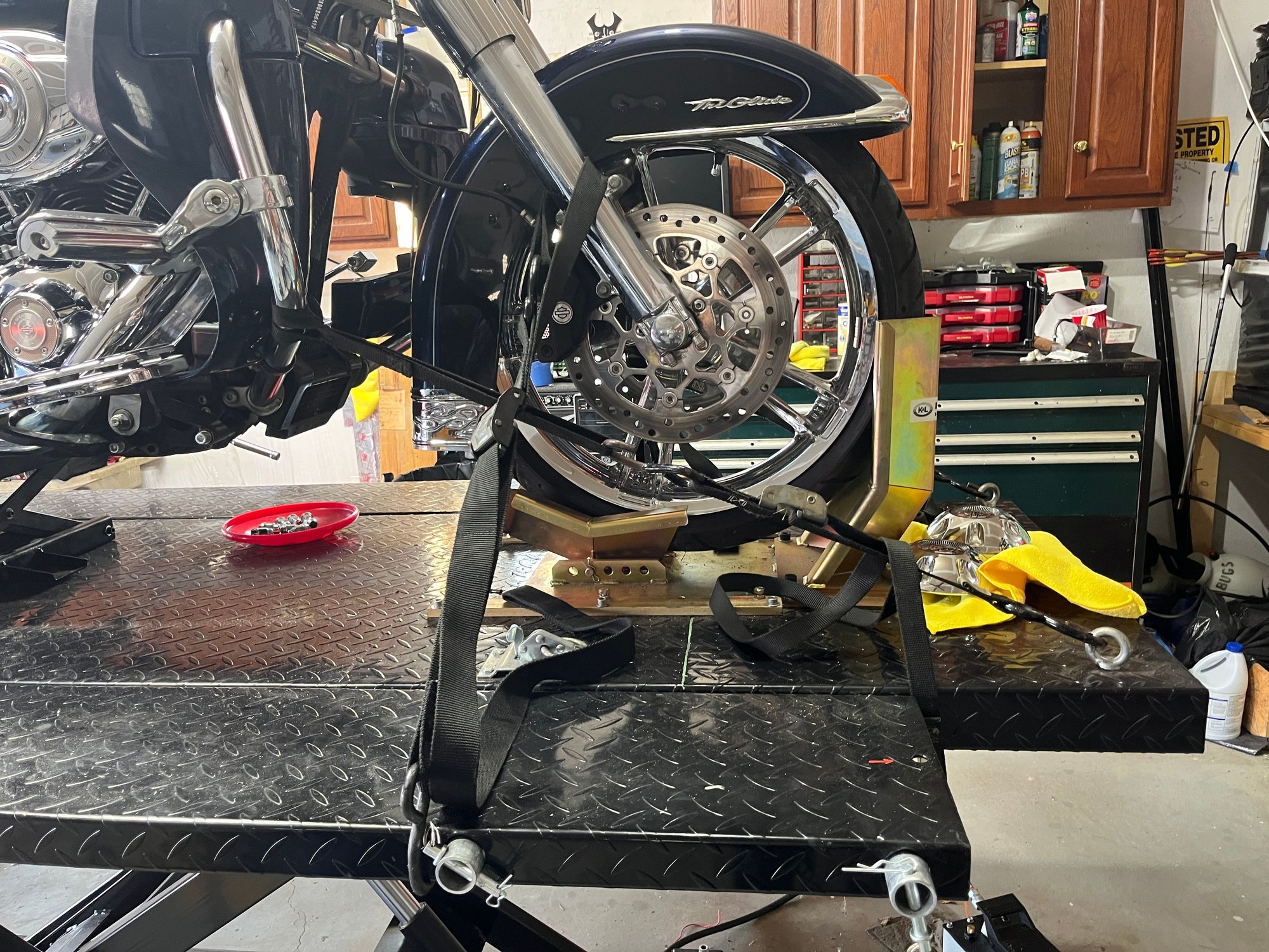

On the lift, secured, wheels off.

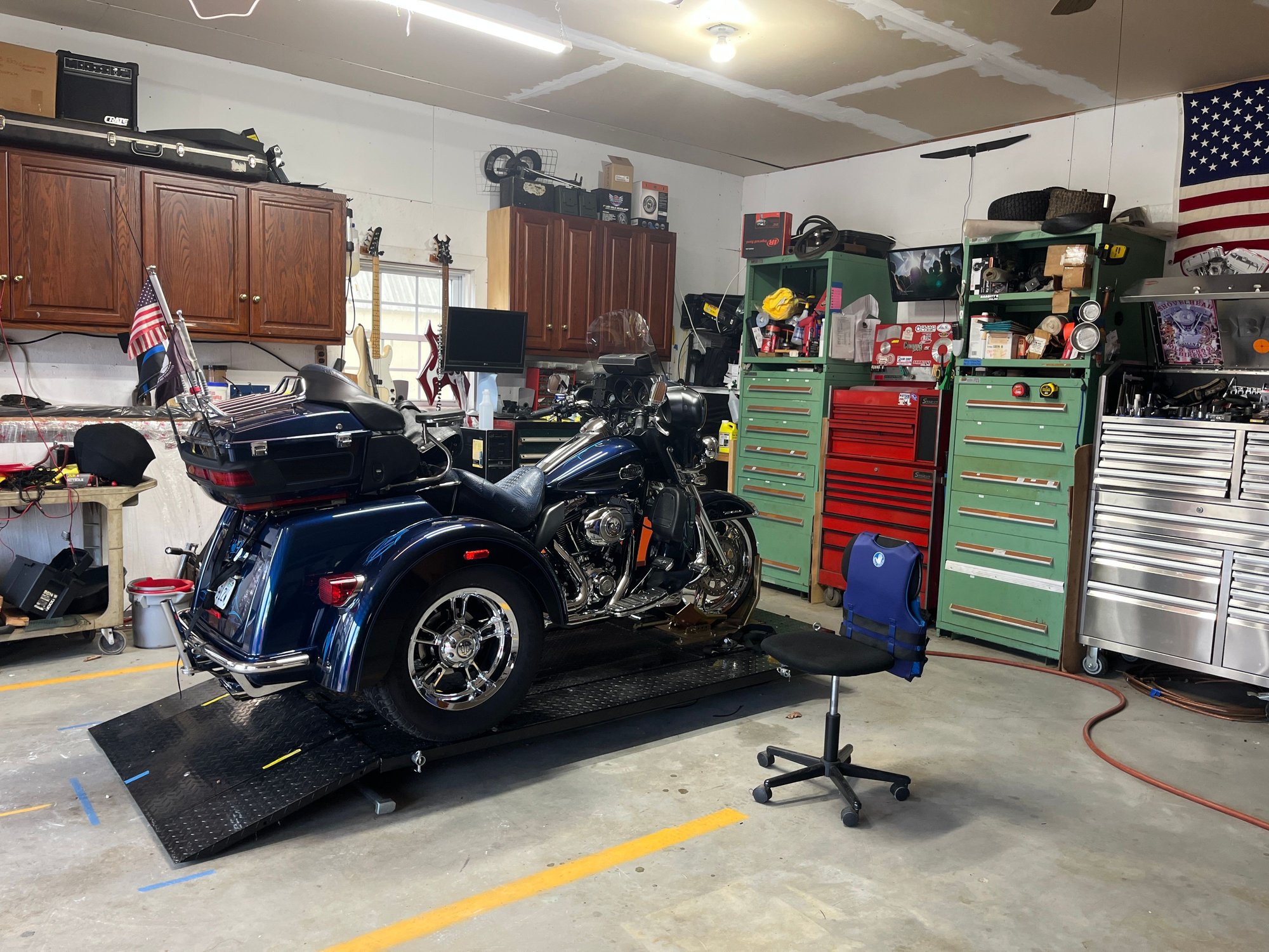

Lifted

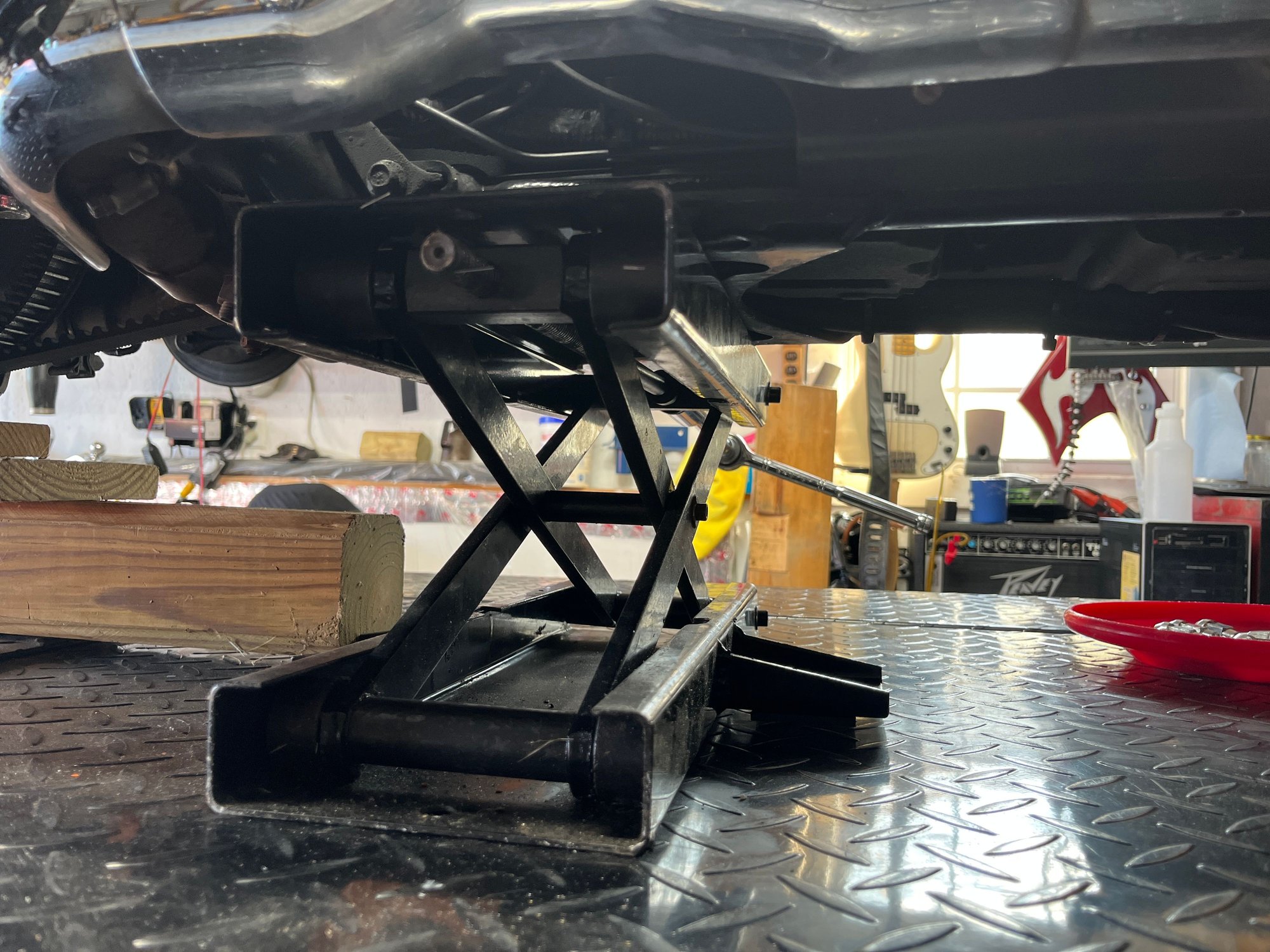

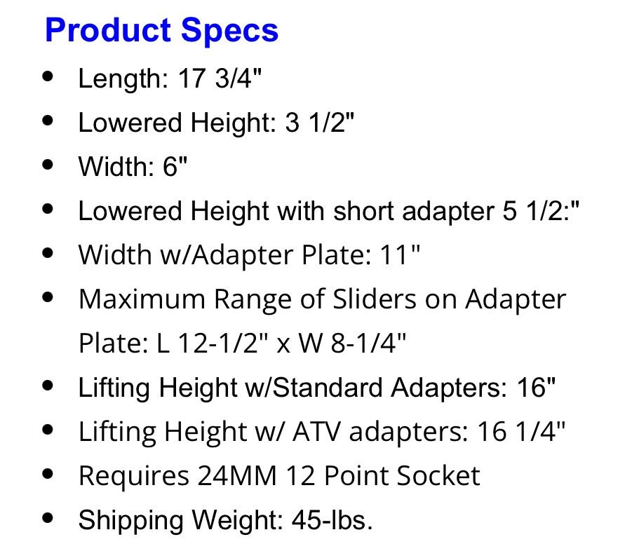

Scissor jack specs for the nay-sayers:1,000 pound cap.
All necessary bolts hit with DeepCreep, and loosened. (No surprises this way)
Rear supported:
My Plan: Use the scissor jack to aid with alignment.
We’ll see how that plays out.
Parts scheduled delivery on Friday.

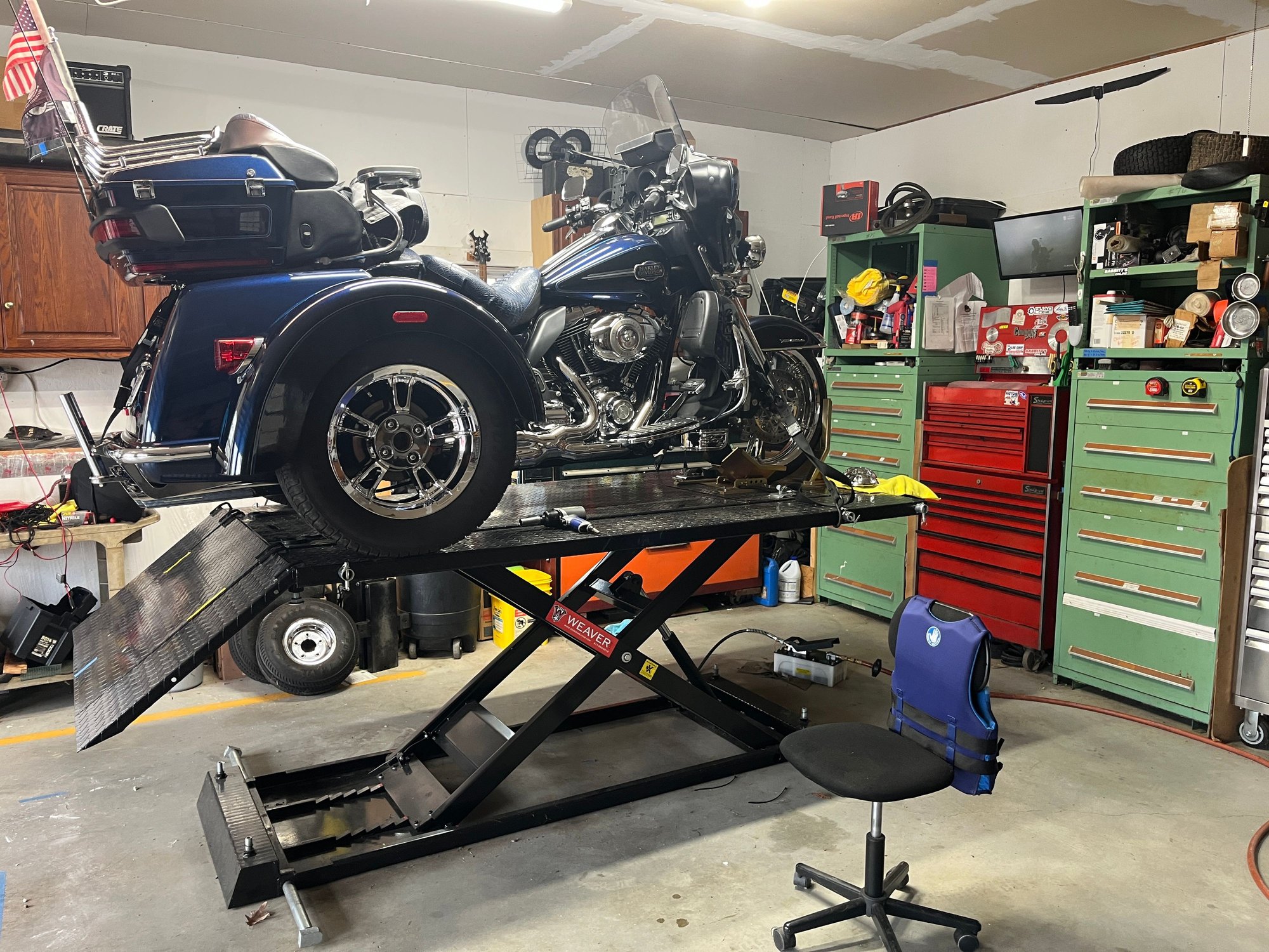

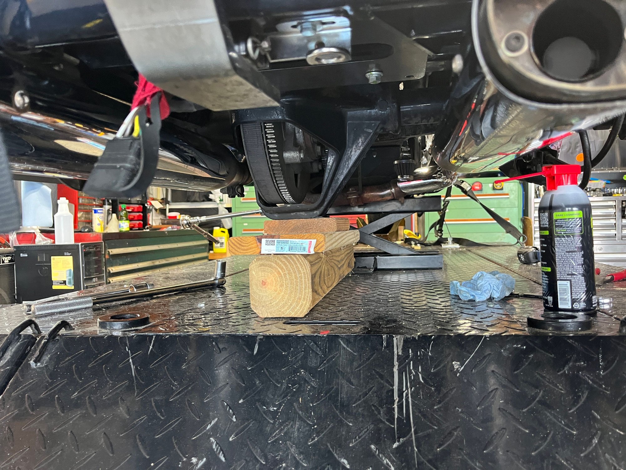

Nothing particularly difficult to get to.
(With a lift table 😎 )

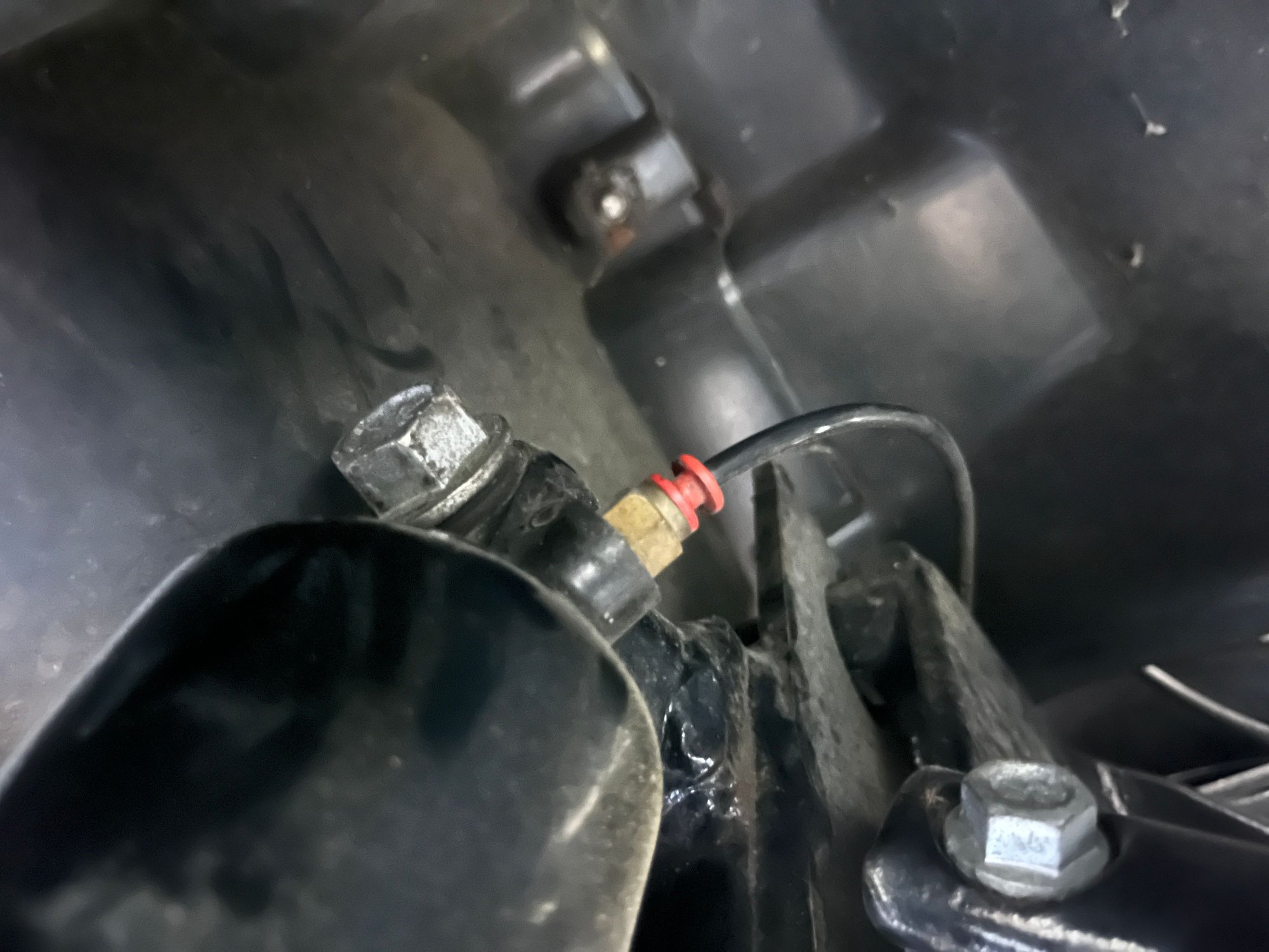

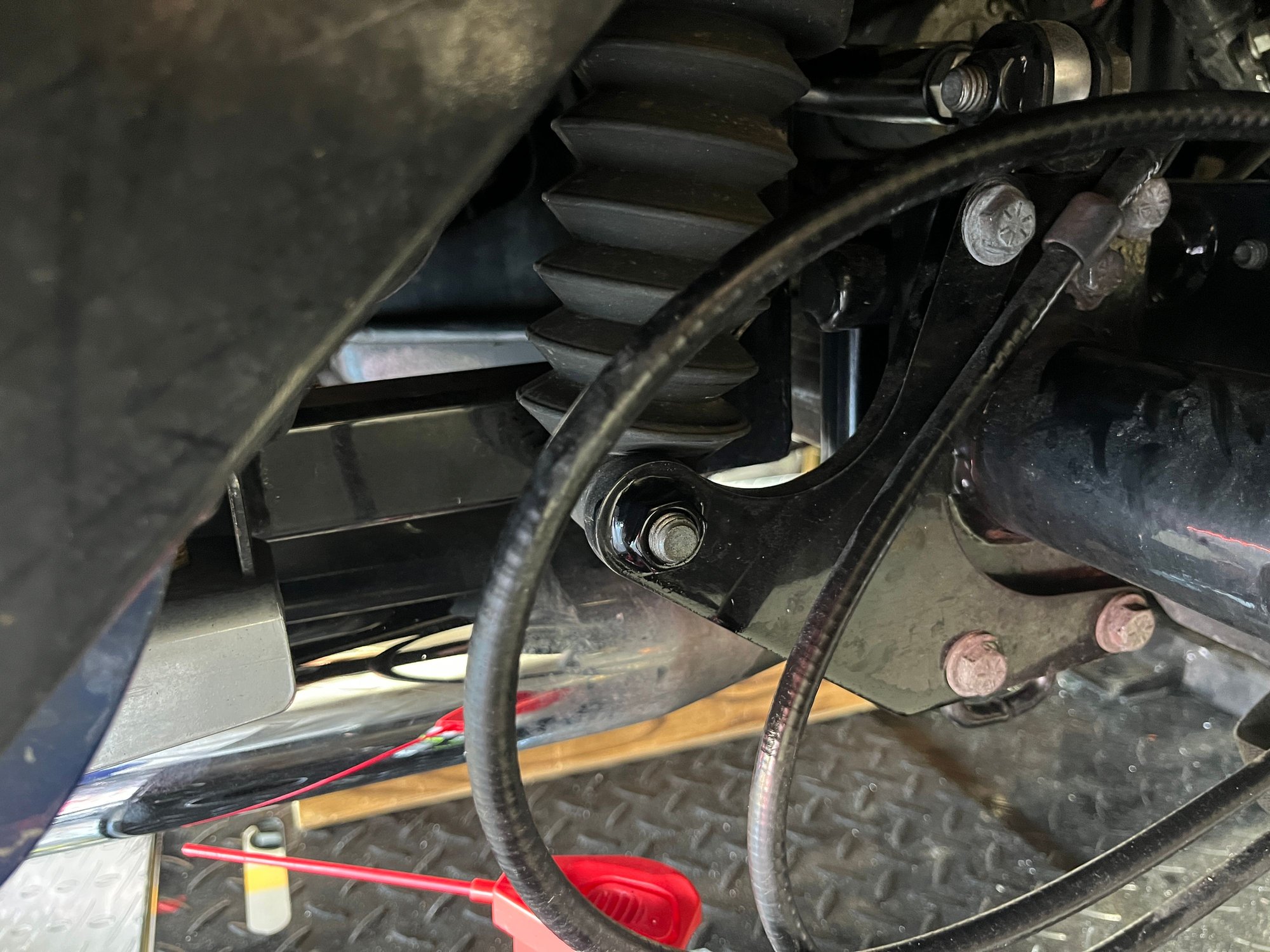

Done;
Included instructions: were on point.
ETA: I removed a rear lift that was on the trike(manufacturer unknown), and installed the DKC components.
Approx 2 hours for both comfort lift and shock replacement.
(Loosening up everything prior helped)
My system of moving the scissor jack instead of the rear end worked out
(for me).
None of the bolts were ‘hard’ to get to.
All tasks preformed with normal hand tools.

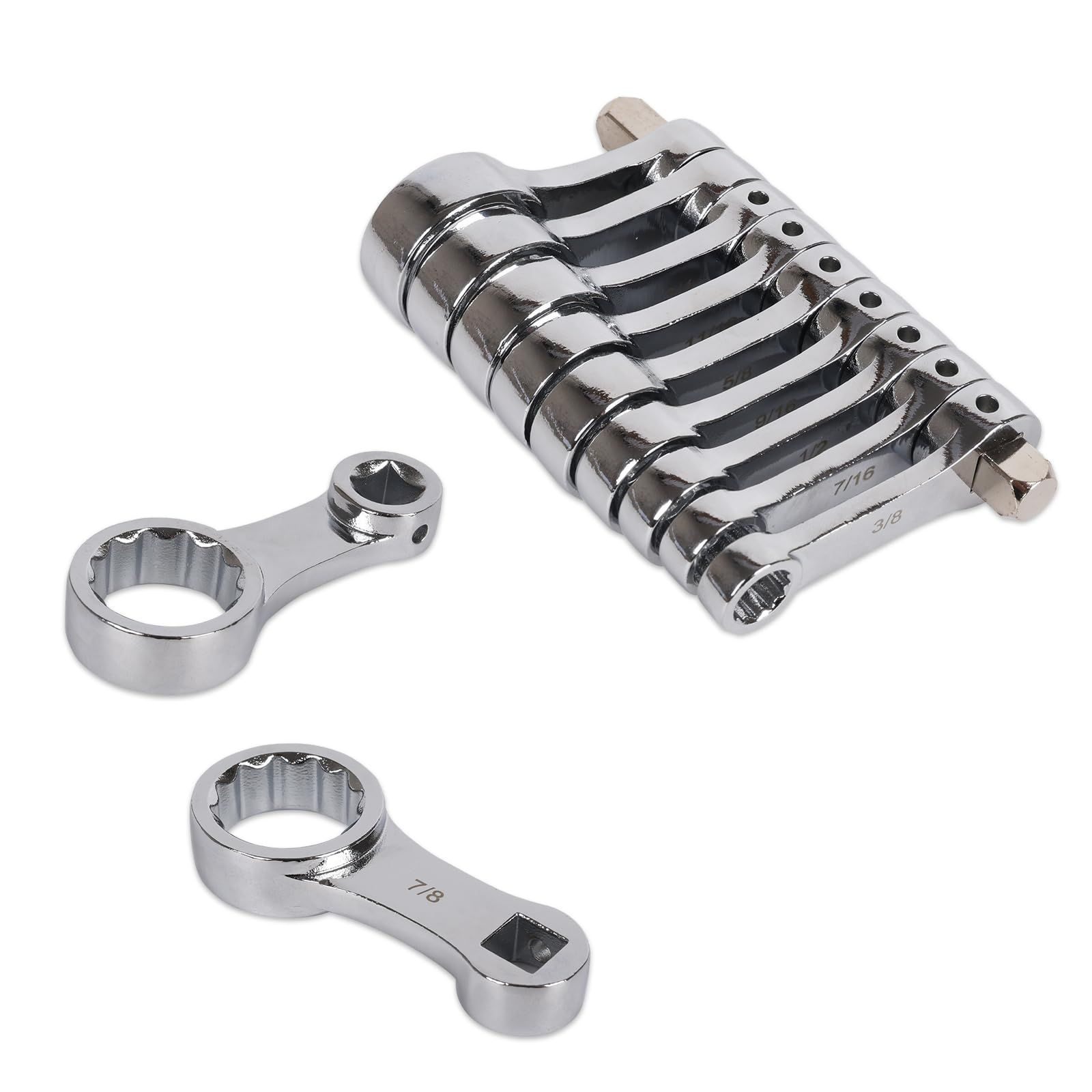

Trickiest part: torquing the bottom shock bolts.
Tip: get a set of torque adapters for your tool box.
90* to to your torque wrench, NO adjustment of torque necessary.
It not at 90, get out your calculator.
All others pretty simple
Too late to road tonight.

Torque adapters for the lower shock bolt?
Old Nov 28, 2025 | 08:07 PM
ShovelEd's Avatar
ShovelEd
Joined: Jun 2010
Posts: 14,077
Likes: 62,823
From: Other Side of the Tracks
It threads from the inside to the outside.
No room for a socket.
