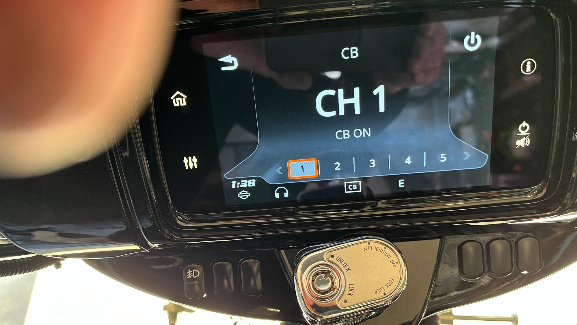

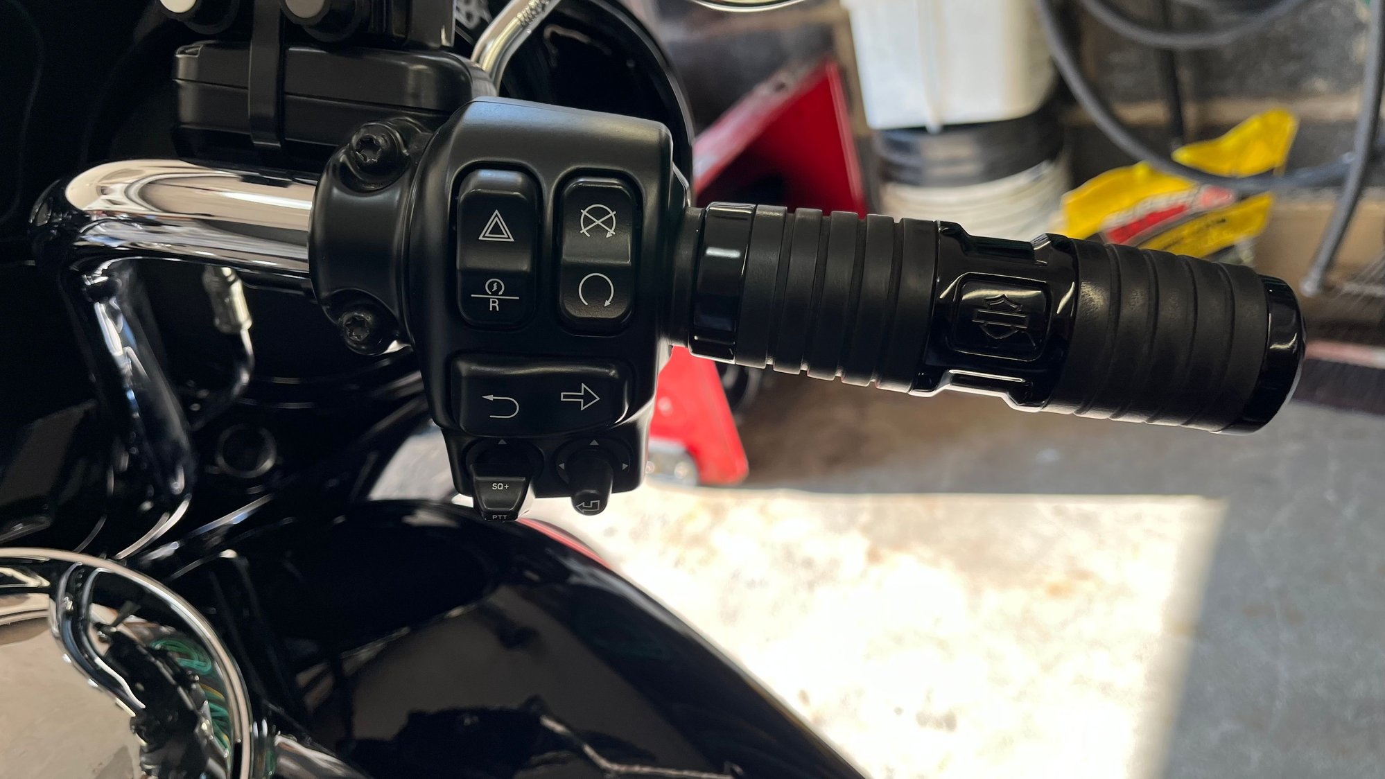

It does fit if you have the Boom GTS radio which you do have. I put it in my 2024. You have to change the right control which he has. Antenna 76386-09A short 76250-09 stock
Just have to have it flashed at dealer.
You will need the antenna and the wire should already be in the tour pack.

Thanks. I’ll pursue the retrofit. I have the antenna and cable already in use on a mobile unit. Did you use the mounting bracket on the module or just the module itself? HD is doing their best to force us all into wireless but my riding buddies all have older bikes and CB’s. Not sure if HD offers the stock part so may need to go with a used unit. It looks like hand switches are still available.
