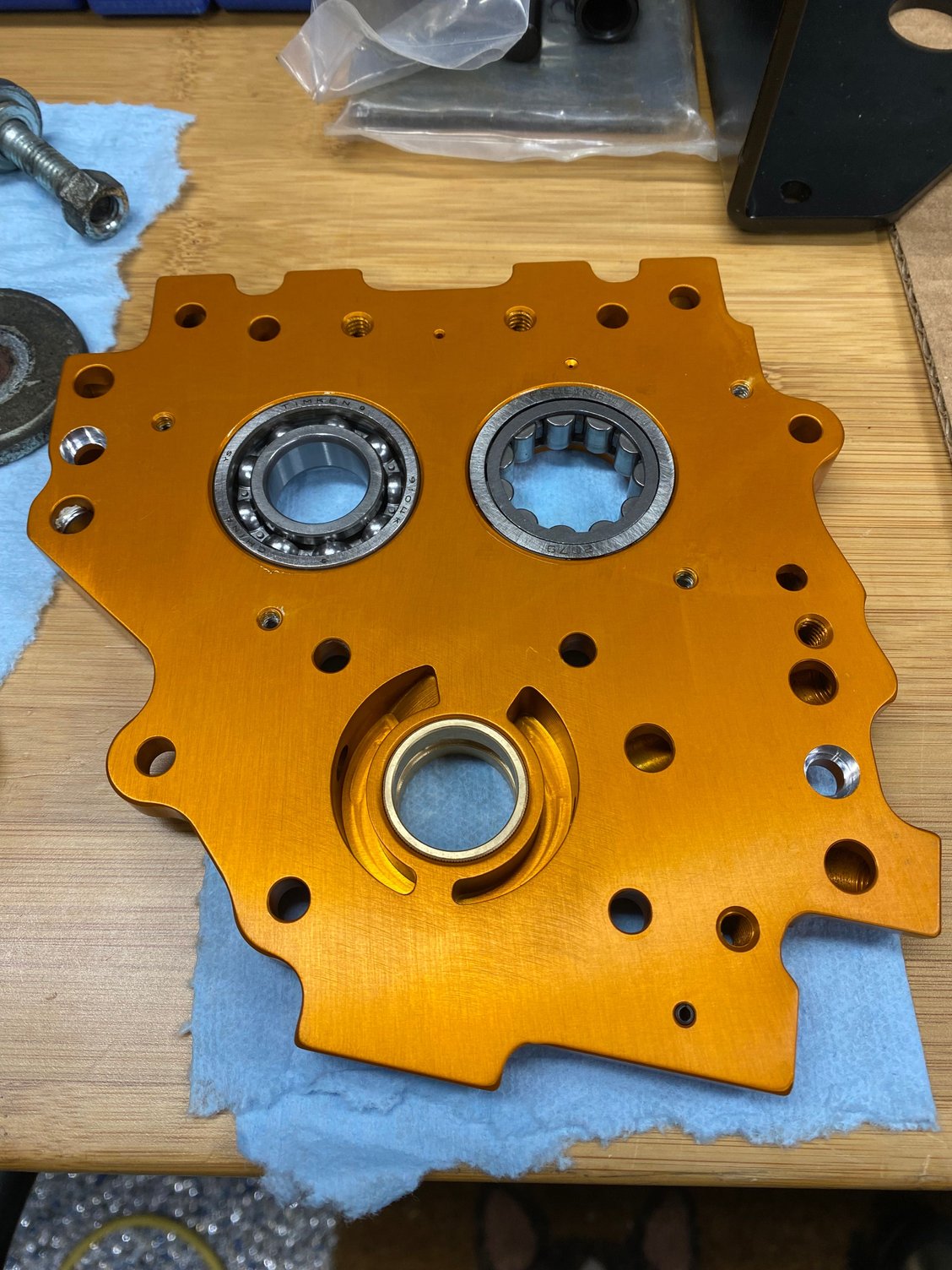

I have the stupid question I have to ask; With this cam plate being a hybrid, I'm guessing I can use the outer bearings for a 99-06 cam plate? I plan on changing the inners to the Koyo B-148's, but wasn't sure on the outers. Also, I'm guessing either cam will work with this cam plate? The reason I'm asking is because my mind is spinning around about conversion cams for this 88 and I was a little confused. Just want to make sure everything plays nice together.

Not a stupid question; plenty get confused between the 25282-11 and the 25The hybrid plate was designed as an "upgrade" to the '99-'06 twin cams; hydro tensioners and high capacity oil pump. You can use the outer '99-'06 outer bearings; any cam that fits the early cam plate can be run in the hybrid plate; chain or gear drive if available. '99-'01 models retain the outer "silent" link chain to retain the cam position sensor function, so while the hydro tensioners are an "upgrade", the tensioners ride on the link chain, not the roller. Not all bad news, you do get the high-capacity oil pump.

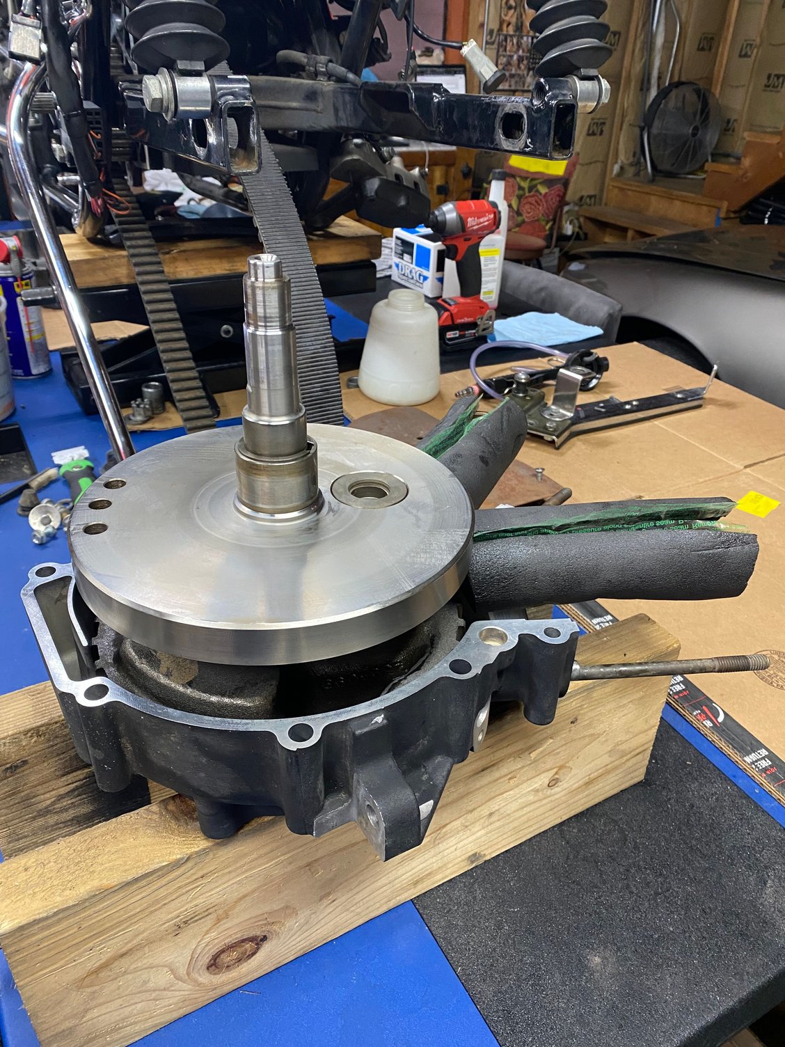

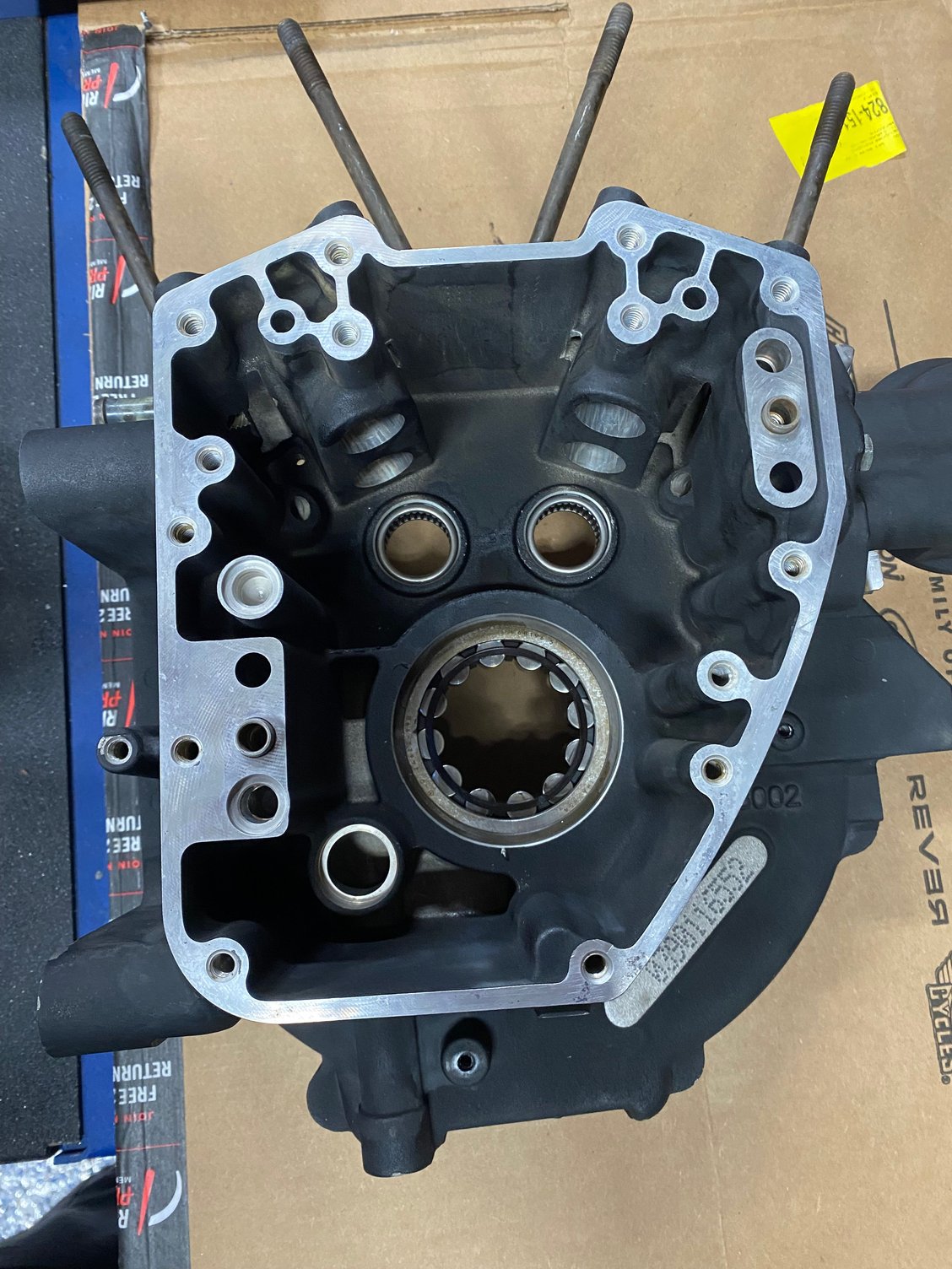

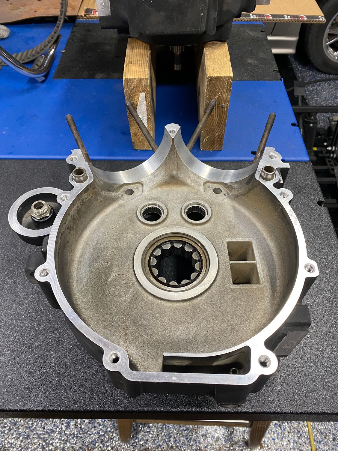

Hey everyone, been a couple of weeks now so wanted to give an update: I split the cases, pressed the flywheel out, and cleaned everything really good. Everything looks good other than normal wear. Installed the flywheel yesterday and did the cam bearings as well. Had .002 endplay with the flywheel. Going to be putting the halves back together today after I clean AGAIN the piston oilers and install. Also installed the new bearings in the new cam plate as well. Here are some photos:

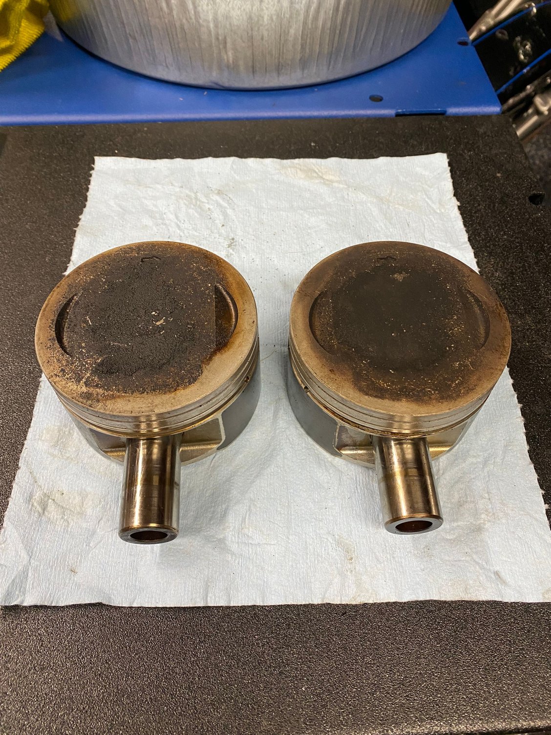

Got the heads and cylinders back from WFO Larry, rings were shot. Going to start putting this all back together so stay tuned.
Ride safe!

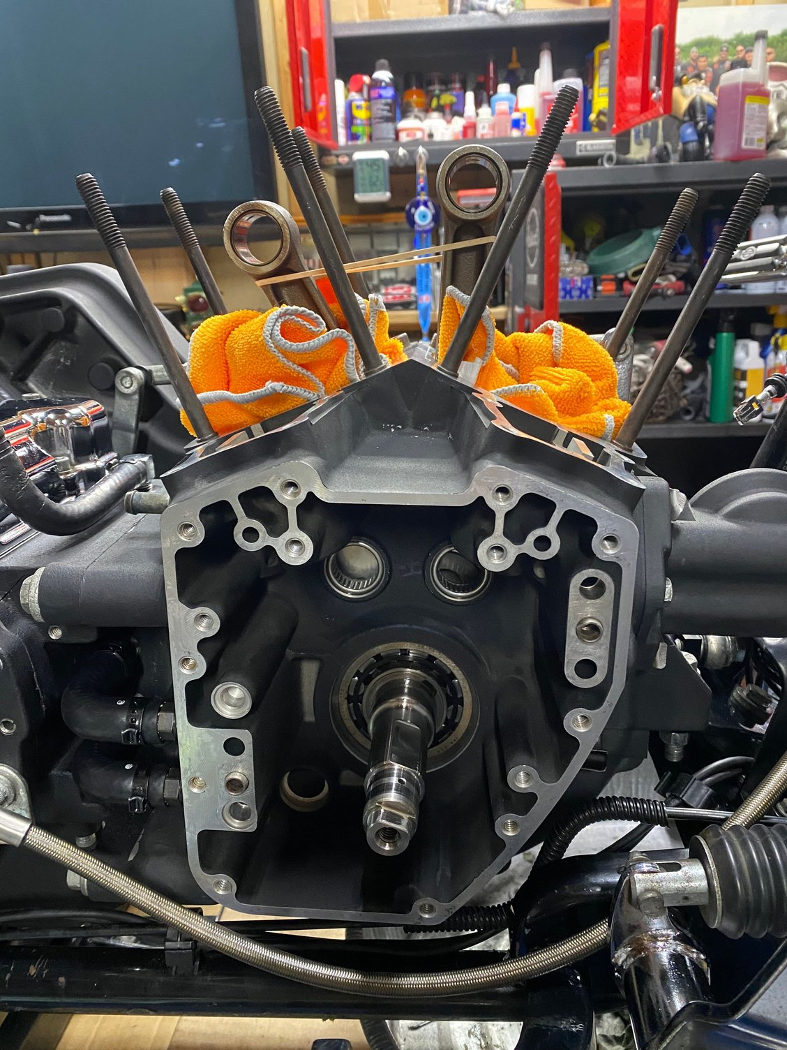

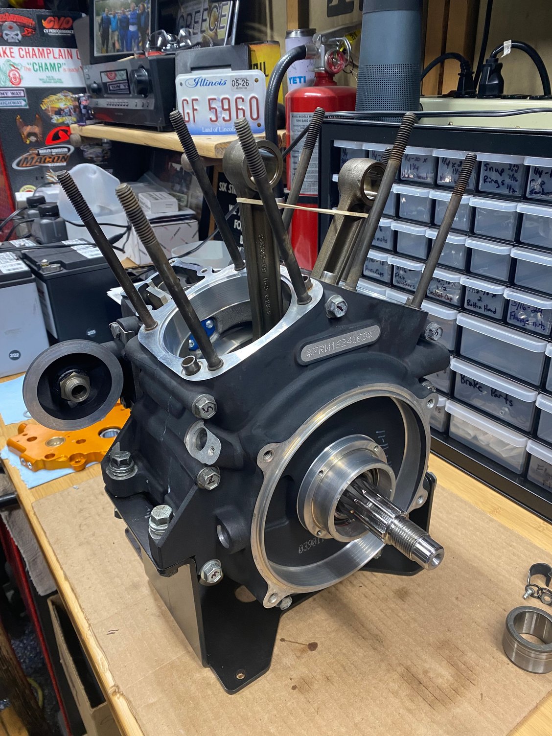

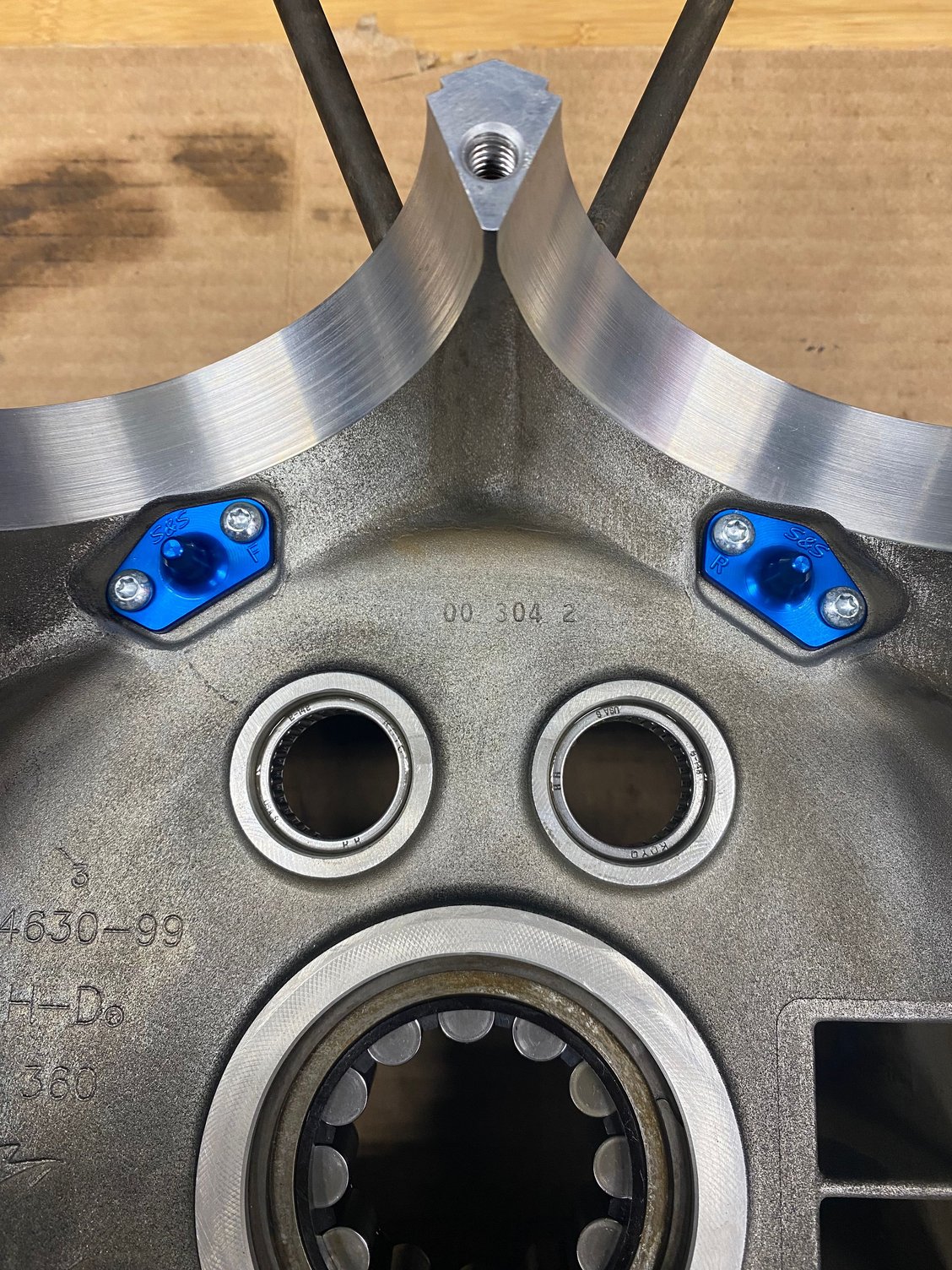

Hey everyone, sorry for the delay but was waiting on parts. Ordered up new S&S piston oilers, one of the stock ones was mucked up good and figured it would be best to get new ones due to the situation. Put the cases back together yesterday and mounted the lower end back into the frame. So far so good, moving along so stay tuned. Here are some pics:
