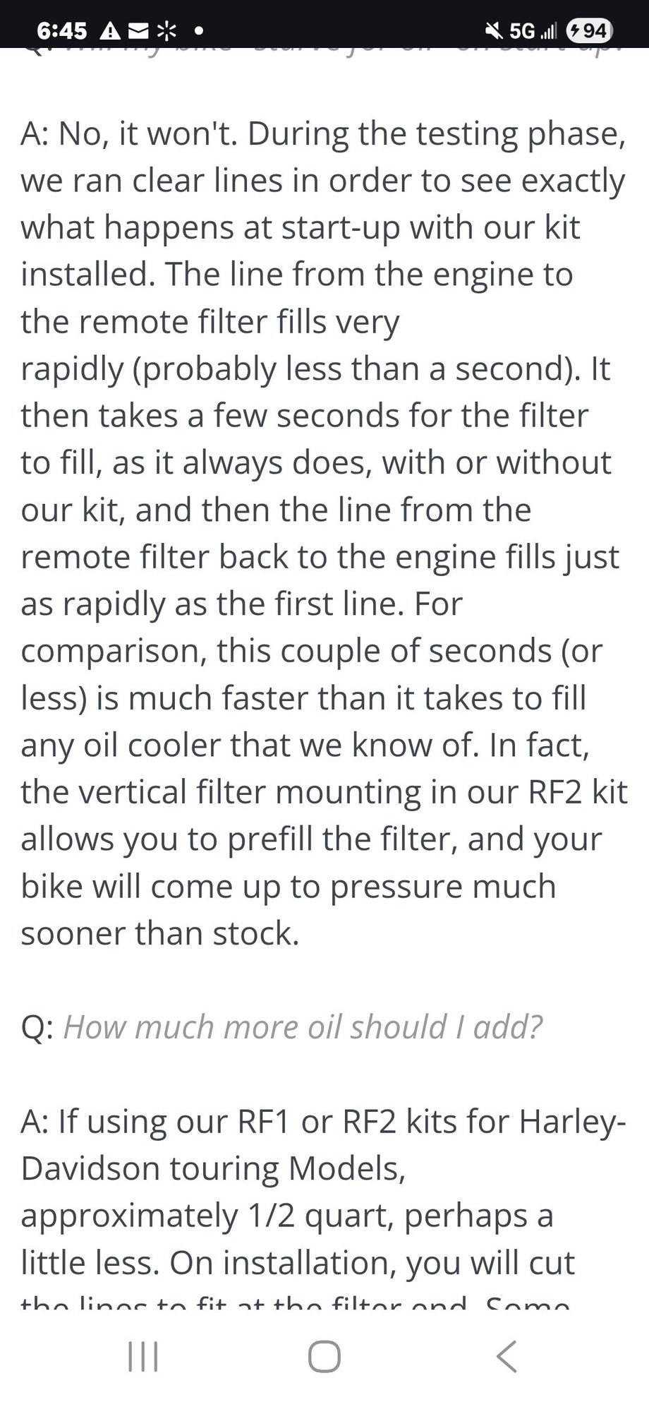

Dan Moore from moores sensible parts used to make
And sell remote oil filter relocation kits and oil coolers.
I still run one of his on my bike and been on it now for 10yrs.
He did testing using clear lines and says less than a second.
This is a quote from his website.

Ok, I just watched a video that was part of the one posted. Looks like it took (4-5) seconds for a dry filter to fill on this guys v-8 chev motor. But that’s not a HD so kinda irrelevant as to what that time is for our motors. That particular video ( w/ oil samples,tests, etc.) showed no difference in engine wear if oil filter was filled, not filled, what ever. So I guess what I’m after don’t make a bit of difference, Hah…I fill my filters anyway. But it would still be interesting to know how long the entire amount of oil in the system completes a cycle through the oil filter under normal circumstances…… I know, I know WGAS. Well I do anyway.

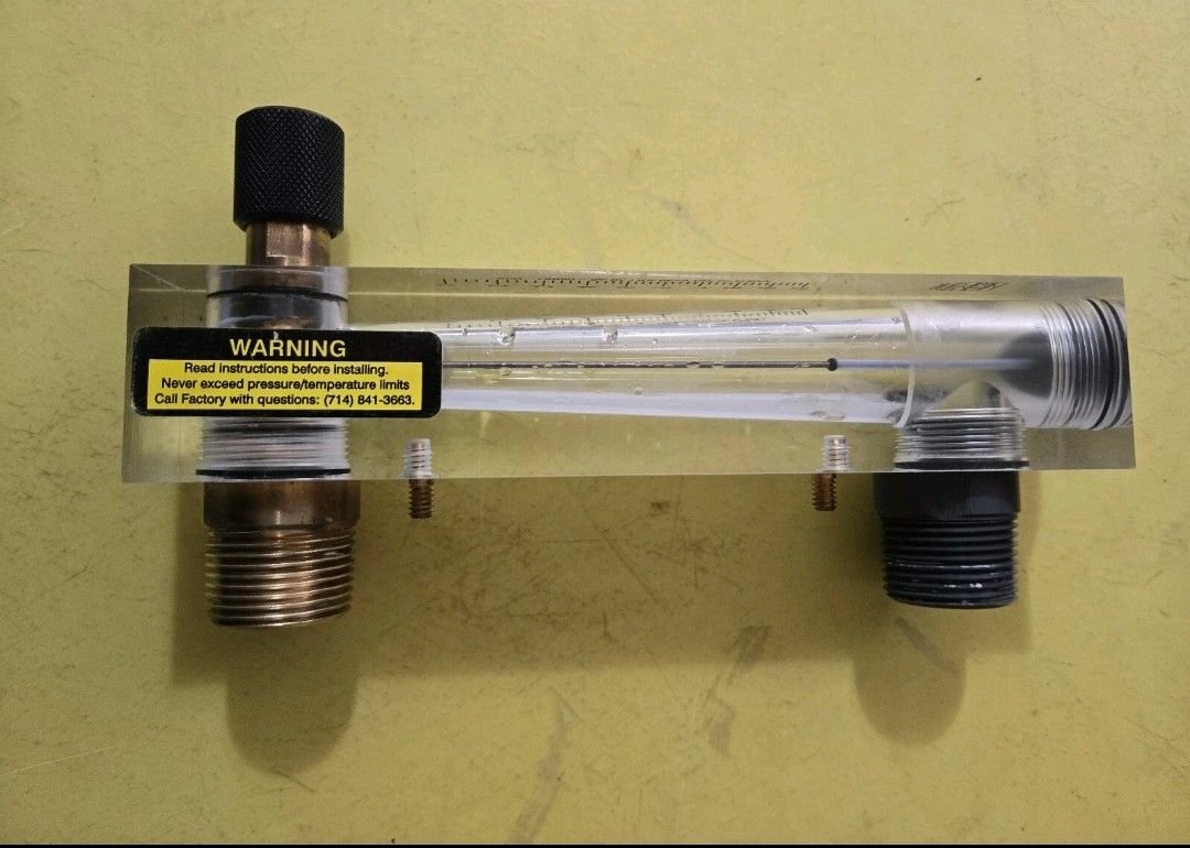

You could screw out the oil light switch in front. Screw a pipe nipple in it with a 90 deg ball valve.
Stick it in a opening in the side of a 5 qt clean oil jug.
Get to the desired rpm oil volume check your interested in.
Now with some one on a stop watch, open the valve for 5 seconds and measure the volume of oil.
May take a few tries at the time since not sure what's going to come out in 5 seconds..
Now more accurate way would be plumb it thru a meter and hose it back to the dip stick opening.
Be quick. You may be starving oil volume thru engine..
There numerous flow gages on Ebay and Amazon.
