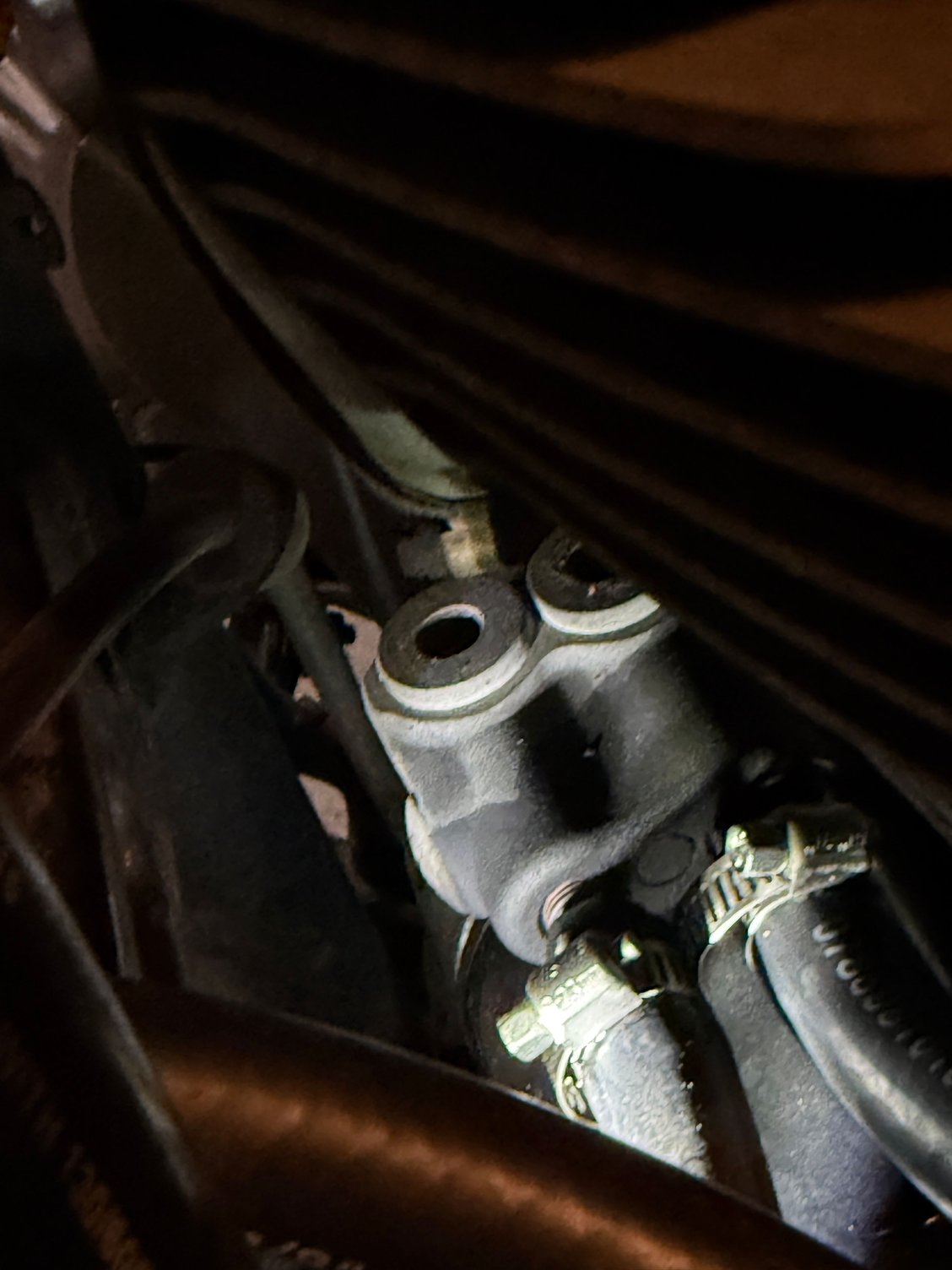

2016 FLRT with a stock 103" Twin Cam engine. Bought this several years ago with 6K on the clock. It sat for long periods as my wife and I negotiated moving to a new city, but I've now run it up to 20K.
Two questions:

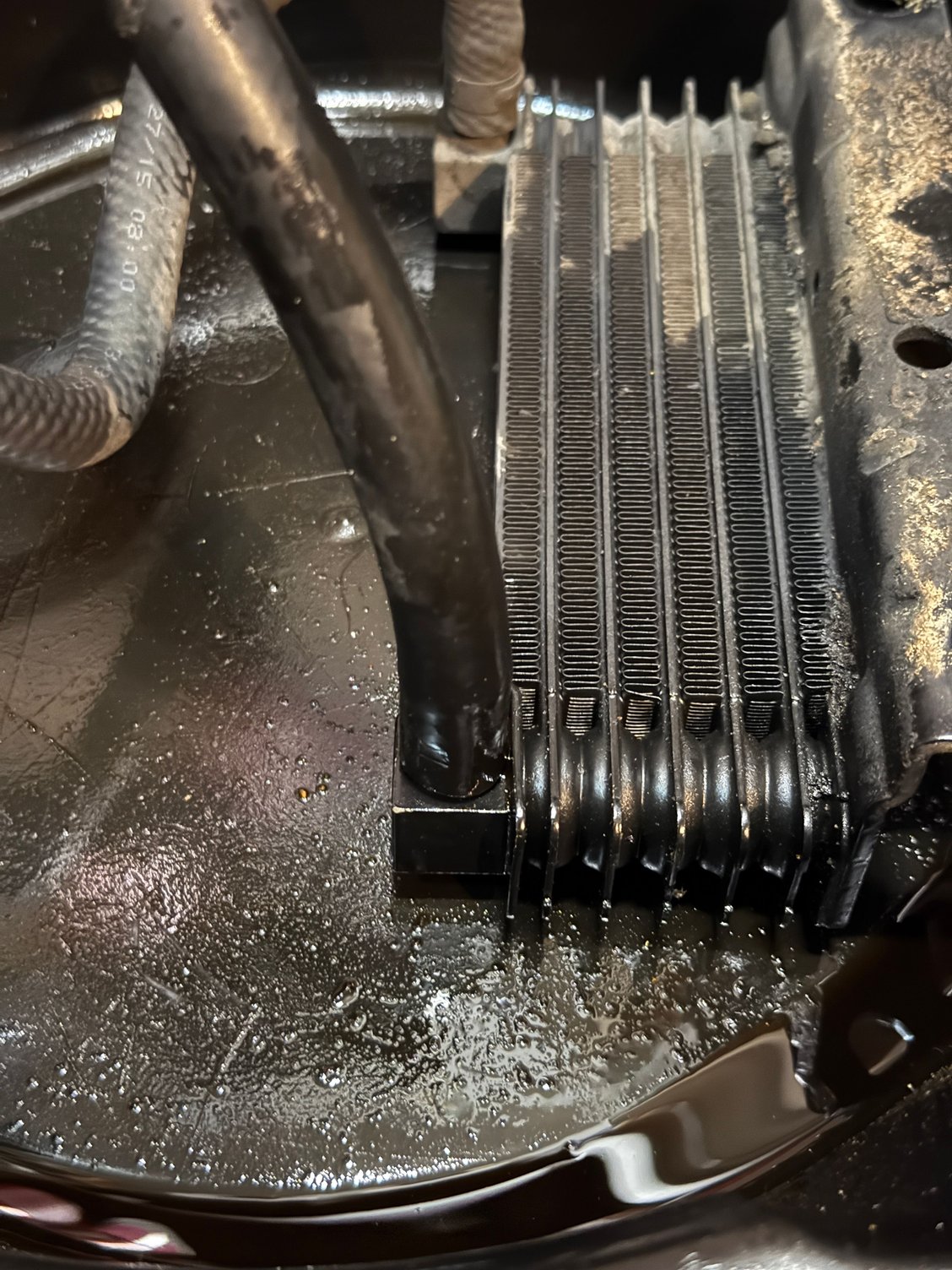

1) OEM oil cooler (HD part no. 63083-11A) installed by previous owner began leaking at one inlet at 20K. See photo below for reference. Has anyone else had this issue? If I buy an OEM replacement, will I be back again in another 20K?
2) If I am understanding correctly, there is a thermostat in the oil cooler adaptor assembly, under the plugs at top, as seen in photo below. These 103"s run hot AF on the best of days, and I live in Southcentral Texas. Temps here rarely drop into the 40s, and frequently hit triple digits. Has anyone removed the thermostat from that adaptor so the cooler functions all the time? Can anyone think of a reason not to remove the thermostat?

First. An oil cooler is an oil cooler whether it's on a shovel or twinky..
The thermostat is behind the domed screw with the 2 pin holes.
Plug one end of the hose and add compressed air to the other. Toss it into a pail of water and look for bubbles..

Bill you may have already checked this, but a bad hose can leak from within and show up on a fitting. Lucky repair if its only a hose.

Thanks. I swapped the hose but it still leaked. I haven't pressure-checked the cooler core yet to see where the leak is, but all indications are that it's leaking around that inlet block on the top of the core.
Thanks. I'll have a look.
Will do. Eliminated the hose per cj5's suggestion. Just haven't gotten to testing the core yet.
Old Feb 11, 2026 | 02:13 PM
John Harper's Avatar
John Harper
Joined: Dec 2011
Posts: 8,424
Likes: 3,792
From: San Diego, CA
When the thermostat opens, the oil cooler only can reduce the oil temperature a given maximum amount. So, it won't affect that final temperatures one bit by having it bypass or eliminate the thermostat, it will just take a bit longer for the motor oil to warm up and reach that final temperature. I don't think that really does anything worthwhile since you're not changing that maximum temperature of the oil. Now, a larger cooler would probably reduce that maximum temperature. That might be your best option if you find your existing cooler is leaking.

Old Feb 11, 2026 | 04:49 PM
Max Headflow's Avatar
Max Headflow
Joined: Dec 2005
Posts: 19,703
Likes: 7,887
From: poway
Originally Posted by Bill J. from Austin
I understand that. I've just never had one with a thermostat before. See previous reference to Texas temperatures.
One thing to note is that you can't simply remove the thermostat. You have to duplicate it in the closed position.
I removed one from a Jagg adapter it work different than a auto block coolant thermostat. Cooled off it opens and simply allows the oil to bypass the cooler. Don't know about the adapter you have. I have the same on another bike but I simply cleaned the thermostat and reinstalled. It looks exactly the same as the one in the JAG.
I live in socal and so needing the thermostat is pretty much the same plus whenever I ride I typically go at least 35 miles...
BTW it is raining right now and the temps are down to 58 degrees..

Thank you, John. That makes sense.
I looked at the aftermarket coolers, but went with the OEM again for ease of installation. If (when?) this one craps out, I have my eye on a 10-loop cooler from Jagg.
Old Feb 12, 2026 | 10:38 AM
Bill J. from Austin's Avatar
Bill J. from Austin
Joined: May 2024
Posts: 17
Likes: 18
From: TX
Thanks, Max. I think I'm going to leave well enough alone for the time being. Appreciate the info.
